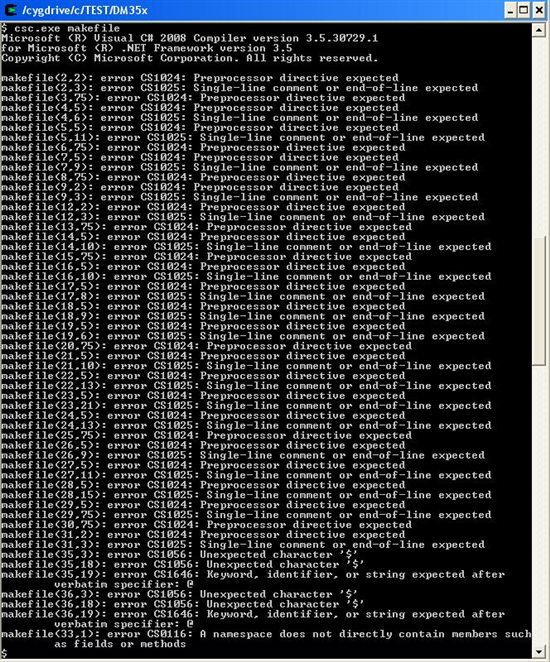

    I also tried running "csc.exe makefile" to see if the makefile could be compiled and generated any output but I got a very long message full of errors:
    Am I confused about what I expect from this compiling function? I though I could generate a ubl.bin file from the source code available in the directory.

    "make" is a valid command, but you need to have the make package installed.  This should be done when running the cygwin installer.  Once you've done that, you can run "make" without any arguments - it executes the instructions of the makefile in the current directory.
    I'm not able to run through this right now, but it's my understanding that this will build the serial loading and flashing utiltities, as well as the ubl.  Now that I think about it, these may already be prebuilt, so I'm not sure you have to recompile anything at all...
