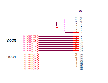

  • In that case, can you first check your connection between DVO2 and sii9022a? I mean, luma output of DVO2 is connected to the luma input of si9022a. similarly for chroma.
    Also please note that the 16bit output of DVO2 with the 16bit input of si9022 is tested on other platforms..
    Rgds,
    Brijesh

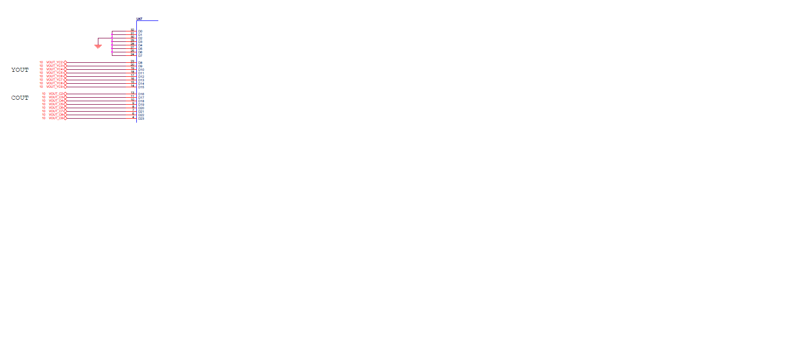

  • According to EVM and EIO schematics, eight upper data lines (2-9) per each channel are connected properly between DVO2 and Sii9022A, as well as discrete sync signals (HSYNC, VSYNC, AVID and FLD). Also, 24-bit RGB888 with discrete sync is working fine over that interface.
    There is just one slot and termination resistors between DVO2 and Sii9022A, nothing else.
    However, two lower data lines (0-1) for Y/C channels are connected to Sii9022A only via "red" port (pins AU10, AL10, AK10 and AU9). But they are also available on separate pins AP9, AU8, AR9 and AT9.
    Are they actually being driven/used in YCbCr 422 mode, or it uses upper eight bits only? Can it be the multiplexing problem?
    I attached the relevant schematics pages. Can you please do a quick check if this is connected in the same way on other platforms (e.g. UD8168)?
    schematics.rar
  • The UDDVR schematic for DVO2->SIL9022a connection is above. COUT is D16-D23 whereas in EVM XIO schematics COUT appears to be D0-D7.
     eb
  • Thanks Badri, this explains the problem both in YUV444 and YUV422 mode.
    We will then connect Sii9022A to DVO2 as on UDDVR.
    Thank you
