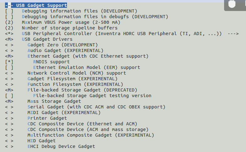

Recently,our team  use the beaglebone black 's otg(miniAB) port to be the host or slave device,I use the Linux kernel is Linux-3.2.0-psp04.06.00.11 ,And my configure is below:
And i insert the g_file_storage.ko or g_mass_storage.ko like usb wiki.
But when I insert my otg device(My otg device is the ID port connect the GND),My beaglebone black will print the error log:
"ti81xx_interrupt 1146: VBUS error workaround (delay coming)".
I don't change the board-am335xevm.c file,so I want to ask whether I must change the board-am335xevm.c file,and how to change it to realize the otg function.
                                                                                                                                                                      Thanks!
    The Beaglebone Black USB0 port does not have the necessary hardware for functioning as an OTG port. Most importantly the USB power switch controlled by USB0_DRVVBUS is missing.

    As you see,beaglebone balck can recognize OTG device,but how can I change the beaglebone black's hardware to auto to recognize OTG device and supply the 5V source.
                                                                                                                                                       Thank you very much!
  • I don't think the BB Black can be reworked to make USB0 an OTG port. This will require the USB0_DRVVBUS signal, and this signal is not routed out from the processor on the PCB.
