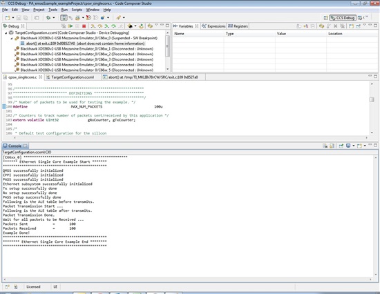

       Recently I want to develope  emac loopback utility for C6678.For this I use <PDK_INSTALL_DIR>\ti\drv\exampleProjects\PA_emacExample_exampleProject . And I  modify it ,then treat one as Sender,one as Receiver,and configure them all in Master Mode.
      In this project , it sends 10 packets by SGMII ,now I can successfully achieve the data transmission.But when I want to transmit more packets ,such as 100 packets,I find it only transmits 16 packets.Then I set the packet number  more larger ,such as 3000,at this time ,the Receiver will get 48 packets ,maybe more,but these packets are not continuous ,the situation is that : firstly receive 16 packets ,then interval for a period of time,it then receive other 16 packets ....
     So I want to know whether I do not configure something properly?And how do I configure the SGMII Example?

    Thanks for your attention! I am using my own board which has two C6678 DSPs,and I just want to using SGMII to transmit data between them. I hope I have described the question clearly.

         I have seen the posts you give, here let me express my problem again.
        Firstly,I use the PA_EmacExample below in the PDK_C6678_1_1_2_6 to transmit data between two C6678 DSPs  in one board,not cores.Then I make sure the platform init call right because I have successfully achieve to transmit 10 packets from DSP1 to DSP2. But when I want to send more packets(by configure MAX_NUM_PACKETS),DSP2 which  runs Receive program only receive 16 packets,when I increase the packet number ,it can receive more but the data is not continous ,why?
    So I think it does not matter with the platform,maybe the init process' problem of PA_EmacExample,somewhere about the packet number.Can you help me check the project?
       At last,I tell you some configurations about my project .I  configure forced link mode as in mentioned in GbE Switch Subsystem User Guide. And I choose SGMII port 1 ; cpswLpbkMode=CPSW_LOOPBACK_INTERNAL;cpswSimTest = 0,

    Yes,just you said,I can let DSP1 core0 send 10 packets to DSP2 core0 ,then I set MAX_NUM_PACKETS to 100,the console message as follows:

    [C66xx_0] **************************************************
    [C66xx_24] Received 0 packets so far...
    [C66xx_0] ******* Ethernet Single Core Example Start *******
    [C66xx_24] Port = 0, MAC address = 30:31:32:33:34:35, unicast_type = 0
    [C66xx_24] Port = 2, MAC address = 50:51:52:53:54:55, unicast_type = 0
    [C66xx_0] QMSS successfully initialized
    [C66xx_0] CPPI successfully initialized
    [C66xx_0] PASS successfully initialized
    [C66xx_0] Ethernet subsystem successfully initialized
    [C66xx_0] Tx setup successfully done
    [C66xx_0] Rx setup successfully done
    [C66xx_0] PASS setup successfully done
    [C66xx_0] Following is the ALE table before transmits.
    [C66xx_0] Port = 0, MAC address = 00:01:02:03:04:05, unicast_type = 0
    [C66xx_0] Port = 2, MAC address = 20:21:22:23:24:25, unicast_type = 0
    [C66xx_0] Packet Transmission Start ...
    [C66xx_0] Following is the ALE table after transmits.
    [C66xx_24] Received 16 packets so far...
    [C66xx_0] Port = 0, MAC address = 20:21:22:23:24:25, unicast_type = 0
    [C66xx_0] SGMII_TX Packets Sent = 100
    [C66xx_0] Packets Received = 0
    [C66xx_0] Example Done!
    [C66xx_0] ******** Ethernet Single Core Example End ********

  • Shi,
    Shi: said:
    Then I want to know whether you tried to send more than 10 packets such as 100?Did it work?
    Yes, I have tested on EVMC6678 with CCS. See the snapshot for your reference.
