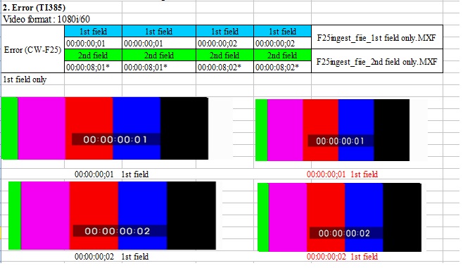

Hi, TI experters
I have a problem when the input rusolution is 1080i/60hz .
we have konw  that the interlace resolution include odd and even field as one frame, in TI provided RDK
also has a variable "fieldId" in struct VCODEC_BITSBUF_S ,but we find the variable "fieldId" never
changed after get encode date(Venc_getBitstreamBuffer),it's always zero.we don't use de-interlace link,the output
video resoluton is also 1080i/60hz,we test the output video,and the filed is incomplete ,only first filed.Do you have
any suggest to help us ?
thanks.

  • fieldId is not populated in VCODEC_BITBUF_S structure. It is always 0 for both top field and bottom field. Both the fields will be correctly encoded. Do you see wrong image when you playback the stream with PC player like Elecard

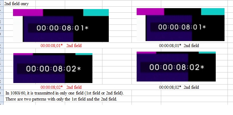

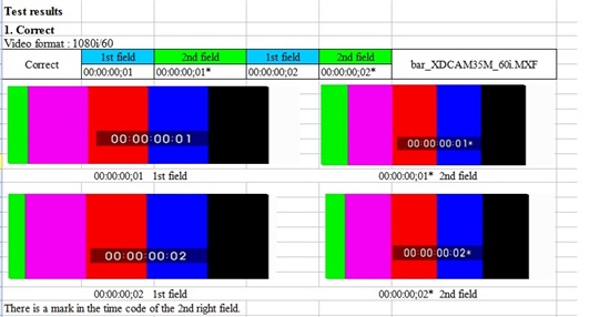

  • Thanks for your reply. We have verified the field of 1080i/60,the testing folw see picture below.
    We tested two kinds of cases, one is direct test signal generator output video, another is  test the  video after the processing of the DM385, test results as shown below.
    We considered the video signal is not synchronized.
    We have another problem , TRS Pos Error (EAV, SAV Error in SDI) ,may be the same reason.
