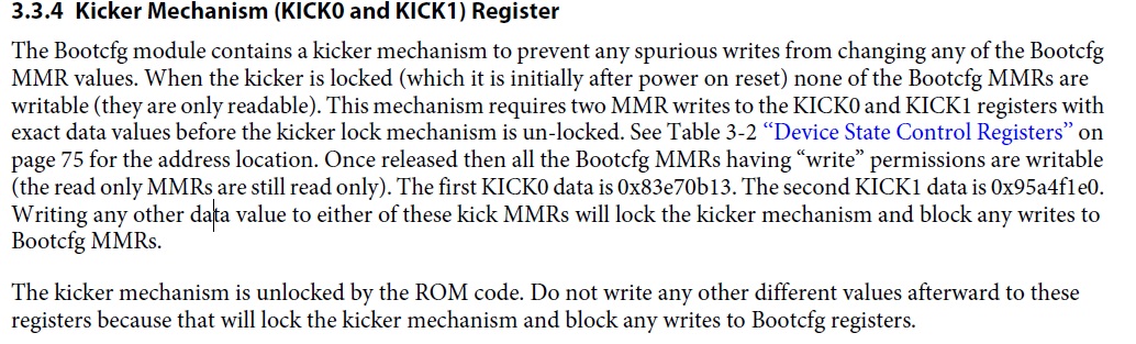

I prepare a firmware project in which core0 and core1 communicates with each other as a rate of 50Hz by using IPC MessageQ structure. I have observed that when I lock the kicker at the beggining of the communication, thay cannot communicate. But if I unlock the kicker they can communicate. So is there a relationship between IPC messageQ APIs and kicker mechanism? Do you have any suggesion?

    There is no relationship between IPC API and Kicker mechanism. But the kicker mechanism will do lock and unlock the registers. This may be cause the issue on our firmware project.

    Please find the detailed information about the kicker mechanism,
    CSL_BootCfgLockKicker() - To used for lock the chip configuration registers to prevent unintentional writes.
    CSL_BootCfgUnlockKicker() - To used for unlock the kicker to ensure Boot configuration MMR is writeable.
