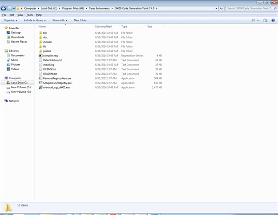

I tried to execute "Procedure to build ddrinit"
(item 4 of the document mcsdk_2_01_02_06\tools\boot_loader\examples\pcie\README.pdf)
and got error message:
C6000_CG_DIR set as "C:\Program Files\Texas Instruments\C6000 Code Generation Tools 7.4.0"
ARGET set as 6678
Converting .out to HEX ...
could not find path
could not open input file pcieboot_ddrinit.btbl
Also I can not find the files
pcieboot_ddrinit.btbl,
hex6x.exe,
Bttbl2Hfile.exe,
hfile2array.exe,
and the folder "C:\Program Files\Texas Instruments"
on my disk.
Please help me to understand problem.

    Have you successfully build the project in CCS?
    I think compiler dependency files are properly install on the compiler installation directory. Please check it.
    Create new folder("LE" and "BE") on "C:\ti\mcsdk_2_01_02_06\tools\boot_loader\examples\pcie\linux_host_loader" directory. I have attached my .bat file for your reference.
    set C6000_CG_DIR="C:\Program Files (x86)\Texas Instruments\C6000 Code Generation Tools 7.4.0"
    set TARGET=6678
    set ENDIAN=little
    set PATH=%PATH%;%SystemRoot%\system32;%SystemRoot%;
    @echo off
    echo C6000_CG_DIR set as: %C6000_CG_DIR%
    echo TARGET set as: %TARGET%
    echo Converting .out to HEX ...
    if %ENDIAN% == little (
    %C6000_CG_DIR%\bin\hex6x -order L pcieboot_ddrinit.rmd pcieboot_ddrinit_evm%TARGET%l.out
    ) else (
    %C6000_CG_DIR%\bin\hex6x -order M pcieboot_ddrinit.rmd pcieboot_ddrinit_evm%TARGET%l.out
    ..\..\..\..\..\..\bttbl2hfile\Bttbl2Hfile pcieboot_ddrinit.btbl pcieboot_ddrinit.h pcieboot_ddrinit.bin
    ..\..\..\..\..\..\hfile2array\hfile2array pcieboot_ddrinit.h pcieDdrInit.h ddrInitCode
    move pcieDdrInit.h ..\..\..\linux_host_loader\LE\pcieDdrInit_%TARGET%.h
    ) else (
    move pcieDdrInit.h ..\..\..\linux_host_loader\BE\pcieDdrInit_%TARGET%.h

    I reinstalled the soft and used your *.bat.
    Now all work properly.
    Thank you for assistance.
