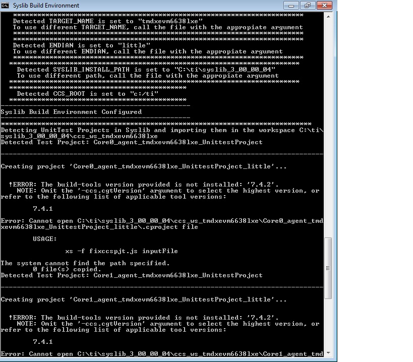

I am trying to build the MCSDK SYSLIB 3.0.0.04 in windows 7. I have to build the SYSLIB for DSP core using the CCS v6.
I have started to create the project by executing the following scripts from the command prompt.
1. syslib_setupenv_tmdxevm6638lxe(windows batch file)
2. syslib_ProjectCreate(windows batch file)
But am getting error saying 'the build tool version provided is not installed:'7.4.2''
How to get the proper build tool?
if both the above scripts are executed properly, will i get a Project which could be imported to CCS v6?
the snapshot of the error is shown below.
please help.
thanks in advance.

  • I think you edit to edit both batch files to match what installed in your computer.
    For example, I used CCS 5.5, the cgtools is under C:\ti\ccsv5\tools\compiler\c6000_7.4.4. Then I edit the setenv file with:
    set CGT_DIR=C:/ti/ccsv5/tools/compiler/c6000_7.4.4
    For the project create batch:
    REM Version of CG-Tools
    set CGT_VERSION=7.4.4
    Then, I was able to run, I saw a lots of project created under C:\ti\syslib_3_00_00_04\ccs_ws_tmdxevm6638lxe.
    Regards, Eric
  • Hi Rajasekharan/Eric,
    Thank you very much for the support you have extended for me.
    I have modified the batch files.Now i am able to create the CCS projects for SYSLIB and proceed with the activity. Now few errors occured while building the project in CCS.
    It seems few of the the packages listed are missing in the mcsdk_3_00_03_15. The missing packages are
    snow3g_1_0_0_1/packages
    xdais_7_21_01_07/packages
    I was not able to find these packages in the mcsdk.
    Where could we find these packages?
    Apart from these, there are few other build errors also. Am attaching the error log here

  • xdais: http://downloads.ti.com/dsps/dsps_public_sw/sdo_sb/targetcontent/xdais/
    I will check for snow3g_1_0_0_1. Just curious, why your log showed pdk_keystone2_3_00_02_15? shouldn't be 03?
    Regards, Eric
  • Snow 3G needs to go through the secure SW approval online in order to download.
    https://www.ti.com/securesoftware/docs/securesoftwarehome.tsp;jsessionid=766098D8D57EA21B4CFCCBB23166C93D.node24
    Regards, Eric
  • Hi Eric,
    Thank you very much for your support:). I am able to built the DSP binary for SYSLIB netfp.
