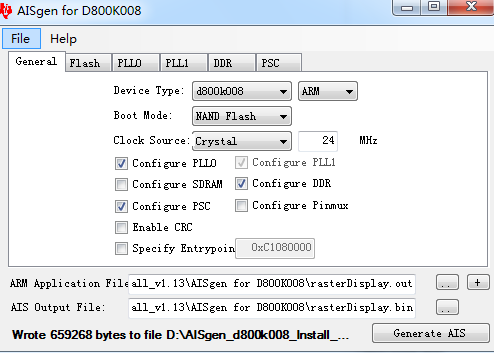

  • Thanks for your reply.
    (1) Open the AISgen tool and select File,Load the lcdk .cfg
    (2) Fill in the "ARM Application File" field with both the ARM UBL and the DSP program. When given two source application files, the AISgen tool will combine them into a single image, in the order that they are listed.
    First, click the "..." button and provide the path to boot.out file
    Next, click the "+" button and choose the rasterDisplay.out file for dsp
    (3)Generate AIS
    when i flash the AIS image, the lcdk is not work.why?
    when i do not use boot.out and use the raster for arm, all things are ok.
  • Hi Hui,
    Did you mention the "specific entry point" field either in the AIS gen tool or in the UBL source code, bl_main.c?
    That is the entry point needed to jump into the DSP application after running the ARM UBL code.
    That entry point can also be feed through the *.cfg file through "Specify Entrypoint=<address in hex>".
    When you build the raster display.out, one more file *.map file will also get generated from which you can take the entry point and give it in bl_main.c

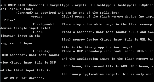

  • Hi Hui,
    1. convert boot.out into boot.ais
    2. convert rasterDisplay.out into rasterDisplay.bin using out2rprc
    3. Using sfh utility, using the below command, flash both the binaries and boot the DSP binary app, rasterDisplay.bin.
    sfh_OMAP-L138.exe -flash boot.ais rasterDisplay.bin -targetType OMAPL138_LCDK -flashType NAND -p COM3
    I have tested this method and it works for me.

  • All things is ok. The lcdk can run both the arm gpioled.bin and the dsp rasterDisplay.bin.
    the gpio6_12 led is blinking and the vga displays the "starterware" logo.
    Only one point surprised me.
    sfh_OMAP-L138.exe -flash boot.ais gpioled.bin rasterDisplay.bin -targetType OMAPL138_LCDK -flashType NAND -p COM3
    will cause
    but  when i use the two commands, all things is ok.
    sfh_OMAP-L138.exe -flash boot.ais gpioled.bin -targetType OMAPL138_LCDK -flashType NAND -p COM3
    After flash competely, use the follwing command to flash.
  • HI,
    You have to combine your two the binaries ( gpioled.out and rasterDisplay.out ) into single binary file as gpioraster.bin
    using out2rprc.
    >out2rprc.exe <app 1 (*.out)> <app 2 (*.out)> <output file name (*.bin)>
    and then use as below, it will work. ( Please go through the readme.txt file of out2rprc.)
    sfh_OMAP-L138.exe -flash boot.ais <output file name (*.bin)> -targetType OMAPL138_LCDK -flashType NAND -p COM3
