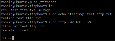

  • Hi Moshin,
    Could you please try to test your tftp service at your Vmware linux machine like below.
    titus@Titus:~$
    titus@Titus:~$ touch /tftpboot/test_tftp.txt
    titus@Titus:~$
    titus@Titus:~$
    titus@Titus:~$ echo "Testing" > /tftpboot/test_tftp.txt
    titus@Titus:~$
    I tried it and I think that is the problem !! It is not working

  • HI
    No sir i have configured the default tftp directory as "/tftpboot"
    mohsin@ubuntu:/$ cat /etc/default/tftpd-hpa
    # /etc/default/tftpd-hpa
    TFTP_USERNAME="tftp"
    RUN_DAEMON="yes"
    TFTP_DIRECTORY="/tftpboot"
    TFTP_ADDRESS="0.0.0.0:69"
    TFTP_OPTIONS="--secure --create"
    mohsin@ubuntu:/$ sudo service tftpd-hpa restart
    tftpd-hpa stop/waiting
    tftpd-hpa start/running
    mohsin@ubuntu:/$
    mohsin@ubuntu:/$ sudo tftp 192.168.1.56
    tftp> get uImage
    Transfer timed out.
    tftp>

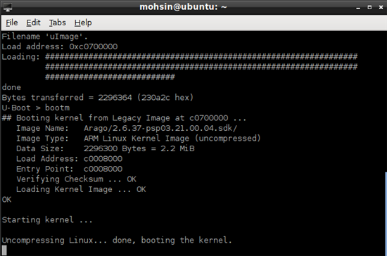

  • I think now it is working. I tried tftpboot uImage now and now it is giving output
    U-Boot > tftpboot uImage
    Using DaVinci-EMAC device
    TFTP from server 192.168.1.56; our IP address is 192.168.1.58
    Filename 'uImage'.
    Load address: 0xc0700000
    Loading: #
    done
    U-Boot >
    does this mean that I have loaded the kernel image in the device ?

  • Progress update:
    Now I am able to move forward from the last issue. I did not do anything new but only repeated the process. now it does move forward but can not load it completely.
    Questions here are:
    1) If I am using the same image which I was using while booting from SDCARD, will I have to make some changes
    2) the root file system is not extracted and I am copying it as it is !! do i need to uncompress it before using tftp c1180000 ?
    3) what are the changes I should make in the bootargs as right now I have not made any change
    4) suggest any other change that I must do.
    note: I am using the same root file system and uImage that I was copying in SD CARD now I am trying to boot from SDRAM.
    this is what I am getting when I run the bootm 0xc0700000 command
    U-Boot > bootm 0xc0700000
    ## Booting kernel from Legacy Image at c0700000 ...
    Image Name: Arago/2.6.37-psp03.21.00.04.sdk/
    Image Type: ARM Linux Kernel Image (uncompressed)
    Data Size: 2296300 Bytes = 2.2 MiB
    Load Address: c0008000
    Entry Point: c0008000
    Verifying Checksum ... OK
    Loading Kernel Image ... OK
    OK
    Starting kernel ...
    Uncompressing Linux... done, booting the kernel.
    Linux version 2.6.37 (jenkins@sdit-build01) (gcc version 4.5.3 20110311 (prerel2
    CPU: ARM926EJ-S [41069265] revision 5 (ARMv5TEJ), cr=00053177
    CPU: VIVT data cache, VIVT instruction cache
    Machine: DaVinci DA850/OMAP-L138/AM18x EVM
    Memory policy: ECC disabled, Data cache writeback
    DaVinci da850/omap-l138/am18x variant 0x1
    Built 1 zonelists in Zone order, mobility grouping on. Total pages: 32512
    Kernel command line: console=ttyS2,115200n8 root=/dev/mmcblk0p2 rw rootwait ip=f

    Waiting for root device /dev/mmcblk0p2...
    any idea ??
    Are you using custom board or EVM ?
    Could you please tel us what are you trying to do ?
    RAM FS booting ?
    Enable RAMDISK support in kernel and change the bootargs for RAM boot and refer the follwing TI wikis.
    How about size of RAM FS ?
    U-Boot> setenv bootargs mem=32M console=ttyS2,115200n8 root=/dev/ram0 rw initrd=0xc1180000,4M ip=dhcp eth=${ethaddr}
    You have mentioned that size was 4M; Is it correct?
    http://processors.wiki.ti.com/index.php/Creating_a_Root_File_System_for_Linux_on_OMAP35x#Configure_the_Linux_Kernel_for_RAMDISK_support
    http://processors.wiki.ti.com/index.php/Initrd

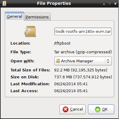

    this is what I get when I check the size of root fs file
  • Will the same kernel image and root file system work while booting from SDRAM, which were working perfectly fine on the SDCARD or will I have to modify them to make them work.
    No, you are using only 128MB RAM
    You have mentioned "mem=32M" and rootfs size is around ~95MB, So you have to reduce the size of rootfs and try to  load into RAM.

    when I set the bootarg exactly as
    which is mentioned in: http://processors.wiki.ti.com/index.php/Booting_Linux_kernel_using_U-Boot#SDRAM
    I get this result:
    OK
    Starting kernel ...
    Built 1 zonelists in Zone order, mobility grouping on. Total pages: 8128
    Kernel command line: mem=32M console=ttyS2,115200n8 root=/dev/ram0 rw initrd=0x6

    No filesystem could mount root, tried: ext3 ext2 cramfs vfat msdos iso9660
    Kernel panic - not syncing: VFS: Unable to mount root fs on unknown-block(1,0)

    apparently my board does not have enough memory.

    Loading: #################################################################
    done
    Bytes transferred = 3552908 (36368c hex)
    U-Boot > <INTERRUPT>
    U-Boot >
    U-Boot >
    U-Boot > setenv bootargs mem=32M console=ttyS2,115200 root=/dev/ram0 rw initrd=0xC1180000,8M
    U-Boot >
    U-Boot >
    U-Boot > saveenv
    Saving Environment to NAND...
    Erasing Nand...
    Erasing at 0x0 -- 100% complete.
    Writing to Nand... done
    U-Boot >
    U-Boot >
    U-Boot > bootm 0xC0700000
       Image Name:   Linux-3.1.10
       Data Size:    2141896 Bytes = 2 MiB
    OK
    Starting kernel ...

    2727.arago-base-image-da850-omapl138-evm.ext2.gz
  • Yes It works !!
    thanks a lot you were absolutely right. issue is with the size of root fs.
    now I am looking into how to bulid kernel image and root file system
    thanks alot once again
