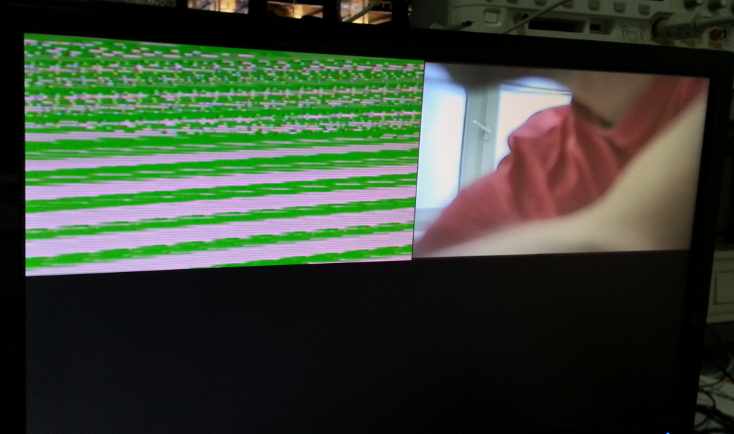

Summary of the Long story;
1) I am using DVR RDK from UDWorks version 03.50.00.08
2) I am using VSYS_USECASE_MULTICHN_PROGRESSIVE_VCAP_VDIS_VENC_VDEC  usecase
3) I can encode the captured video, save to file and decode it by using MCFW APIs. Everythink is fine.
4) Then I try to record a video stream from H.264 IP Camera via RTSP, RTP. I succeeded on that issue. Then I change the file format from rtp stream to H.264 NALUs.(In this case it is VID_CH00.h264)
5) I am using the decode+display demo for producing the header file (VID_CH00.h264.hdr).
6) I can play my recoding stream via H264Vİsa software. There are some errors but it can decode it.

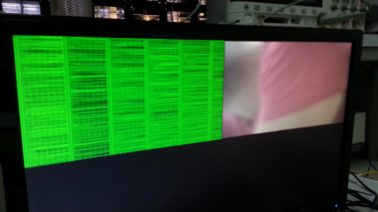

Current Problem:
When I first run the program I am seeing a green flickering screen on the mosaic channel. If I stop the program
and run again 8168 can decode and play the video.
Do you have any idea about the problem. I try to summarize the problem to avoid complexity. If you need further info, I will supply with pleasure. I inserted two files (working logs: some piece of screen output from working iteration, green_flickering_logs:  some piece of screen output from not working iteration)

MULTICH_PROGRESSIVE_DVR:DEI Preview Output disable invisible channel.DEI_LINKID[0x20000026],CHNUM[2]
MULTICH_PROGRESSIVE_DVR:DEI Preview Output disable invisible channel.DEI_LINKID[0x20000026],CHNUM[3]
MULTICH_PROGRESSIVE_DVR:DEI Preview Output disable invisible channel.DEI_LINKID[0x20000026],CHNUM[4]
MULTICH_PROGRESSIVE_DVR:DEI Preview Output disable invisible channel.DEI_LINKID[0x20000026],CHNUM[5]
MULTICH_PROGRESSIVE_DVR:DEI Preview Output disable invisible channel.DEI_LINKID[0x20000026],CHNUM[6]
MULTICH_PROGRESSIVE_DVR:DEI Preview Output disable invisible channel.DEI_LINKID[0x20000026],CHNUM[7]
MULTICH_PROGRESSIVE_DVR:DEI Preview Output disable invisible channel.DEI_LINKID[0x20000028],CHNUM[0]
MULTICH_PROGRESSIVE_DVR:DEI Preview Output disable invisible channel.DEI_LINKID[0x20000028],CHNUM[1]
MULTICH_PROGRESSIVE_DVR:DEI Preview Output disable invisible channel.DEI_LINKID[0x20000028],CHNUM[2]
MULTICH_PROGRESSIVE_DVR:DEI Preview Output disable invisible channel.DEI_LINKID[0x20000028],CHNUM[3]
MULTICH_PROGRESSIVE_DVR:DEI Preview Output disable invisible channel.DEI_LINKID[0x20000028],CHNUM[4]
MULTICH_PROGRESSIVE_DVR:DEI Preview Output disable invisible channel.DEI_LINKID[0x20000028],CHNUM[5]
MULTICH_PROGRESSIVE_DVR:DEI Preview Output disable invisible channel.DEI_LINKID[0x20000028],CHNUM[6]
MULTICH_PROGRESSIVE_DVR:DEI Preview Output disable invisible channel.DEI_LINKID[0x20000028],CHNUM[7]
MULTICH_PROGRESSIVE_DVR:Decode enable visible channel.DEC_LINKID[0x10000022],CHNUM[0]
 [m3video] ENCLINK_H264:HEAPID:0        USED:11912
 [m3vpss ] SWMS:HEAPID:0        USED:224
 [m3video] ENCLINK_H264:HEAPID:3        USED:49152
 [m3vpss ] SWMS:HEAPID:1        USED:47296
 [m3video]  10309020: ENCODE: All CH Create ... DONE !!!
 [m3vpss ] SWMS:HEAPID:4        USED:20736000
 [m3vpss ]  10309203: SWMS: Create Done !!!
 [m3vpss ]  10309203: SWMS: Create in progress !!!
 [m3video] ENCLINK:HEAPID:0     USED:190712
 [m3vpss ]  UTILS: DMA: Allocated CH (TCC) = 60 (60)
 [m3video] ENCLINK:HEAPID:2     USED:39813120
 [m3vpss ]  UTILS: DMA: 0 of 1: Allocated PaRAM = 60 (0x49004780)
 [m3video] ENCLINK:HEAPID:3     USED:786432
 [m3vpss ] SWMS: instance 0, sc id 5, start win 0 end win 17
 [m3video]  10309021: ENCODE: Create ... DONE !!!
 [m3vpss ]  10309308: SWMS1    : Loading Vertical Co-effs (UPSCALE)x ...
 [m3video]  10309022: IPC_BITS_OUT   : Create in progress !!!
 [m3vpss ]  10309308: SWMS1    : Loading Horizontal Co-effs (UPSCALE)x ...
 [m3vpss ]  10309308: SWMS    : Co-effs Loading ... DONE !!!
 [m3vpss ]  10309309: SWMS    : ******* Configuring clock 30 secs...
 [m3video]  10309023: IPC_BITS_OUT   : Create Done !!!
 [m3vpss ]  10309309: SWMS1    : Loading Vertical Co-effs (UPSCALE)x ...
 [m3video]  10309032: IPC_BITS_IN   : Create in progress !!!
 [m3vpss ]  10309309: SWMS1    : Loading Horizontal Co-effs (UPSCALE)x ...
 [m3video]  10309032: SYSTEM: Opening ListMP [HOST_IPC_OUT_24] ...
 [m3vpss ]  10309309: SWMS    : Co-effs Loading ... DONE !!!
 [m3video]  10309033: SYSTEM: Opening ListMP [HOST_IPC_IN_24] ...
 [m3vpss ]
 [m3vpss ]  *** [SWMS1] Mosaic Parameters ***
 [m3vpss ]
 [m3vpss ]  Output FPS: 30
 [m3vpss ]
 [m3vpss ]  Win | Ch  | Input      | Input          | Input         | Input       | Output     |  Output         | Output  |
 [m3vpss ]  Num | Num | Start X, Y | Width x Height | Pitch Y / C   | Memory Type | Start X, Y |  Width x Height | Pitch Y |
 [m3vpss ]  ----------------------------------------------------------------------------------------------------------------
 [m3video]  10309035: IPC_BITS_IN   : Create Done !!!
 [m3vpss ]    0 |   0 |    0,    0 |   704 x    576 |  1408 /  1408 | NON-TILED   |    0,    0 |  1920 x   1080 |  3840 /  |
 [m3video]  10309035: DECODE: Create in progress ... !!!
 [m3vpss ]
 [m3video] DECLINK_H264:HEAPID:0        USED:2368
 [m3video] DECLINK_H264:HEAPID:3        USED:8937472
 [m3vpss ] SWMS:HEAPID:1        USED:43776
 [m3video]  10309079: DECODE: Creating CH0 of 1920 x 1080 [PROGRESSIVE] [TILED      ],target bitrate = 2000 Kbps ...
 [m3video]  10309081: DECODE: All CH Create ... DONE !!!
 [m3vpss ]  10309310: SWMS: Create Done !!!
 [m3vpss ]  10309310: DISPLAY: Create in progress !!!
 [m3vpss ]  10309311: DISPLAY: Create Done !!!
 [m3video] DECLINK:HEAPID:0     USED:2488
 [m3vpss ]  10309312: DISPLAY: Create in progress !!!
 [m3video] DECLINK:HEAPID:3     USED:8937472
 [m3vpss ]  10309313: DISPLAY: Create Done !!!
 [m3video]  10309084: DECODE: Create ... DONE !!!
 [m3vpss ]  10309313: DISPLAY: Create in progress !!!
 [m3video]  10309084: IPC_OUT_M3   : Create in progress !!!
 [m3vpss ]  10309313: DISPLAY: 44: Field Separate Mode ENABLED for Que 0 !!!
 [m3video]  10309085: IPC_OUT_M3   : Create Done !!!
 [m3vpss ]  10309314: DISPLAY: Create Done !!!
 [m3vpss ]  10309541: SWMS    : ******* Configuring clock 32 secs...
 [m3vpss ]  10309541: SWMS0    : Loading Vertical Co-effs (7/16)x ...
 [m3vpss ]  10309541: SWMS0    : Loading Horizontal Co-effs (7/16)x ...
 [m3vpss ]  10309541: SWMS    : Co-effs Loading ... DONE !!!
 [m3vpss ]
 [m3vpss ]  *** [SWMS0] Mosaic Parameters ***
 [m3vpss ]
 [m3vpss ]  Output FPS: 29
 [m3vpss ]
 [m3vpss ]    0 |  16 |    0,    0 |  1920 x   1080 | 16384 / 32768 | TILED       |    0,    0 |   960 x    540 |  3840 /  |
 [m3vpss ]    1 |   0 |    0,    0 |   704 x    576 |  1408 /  1408 | NON-TILED   |  960,    0 |   960 x    540 |  3840 /  |
 [m3vpss ]    2 | 255 |    0,    0 |   352 x    264 |   704 /   704 | NON-TILED   |    0,  540 |   960 x    540 |  3840 /  |
 [m3vpss ]    3 | 255 |    0,    0 |   352 x    264 |   704 /   704 | NON-TILED   |  960,  540 |   960 x    540 |  3840 /  |
 [m3vpss ]
 [m3vpss ]  10309546: SWMS    : ******* Configuring clock 30 secs...
 [m3vpss ]  10309546: SWMS1    : Loading Vertical Co-effs (UPSCALE)x ...
 [m3vpss ]  10309546: SWMS1    : Loading Horizontal Co-effs (UPSCALE)x ...
 [m3vpss ]  10309546: SWMS    : Co-effs Loading ... DONE !!!
 [m3vpss ]
 [m3vpss ]
 [m3vpss ]
 [m3vpss ]
 [m3vpss ]  10309550: DISPLAY: Start in progress !!!
 [m3vpss ]  10309590: DISPLAY: Start Done !!!
 [m3vpss ]  10309590: DISPLAY: HDDAC(BP0) : 50 fps, Latency (Min / Max) = ( 255 / 0 ), Callback Interval (Min / Max) = ( 25
 [m3vpss ]  10309590: DISPLAY: UNDERFLOW COUNT: HDMI(BP0) 0, HDDAC(BP0) 0, DVO2(BP1) 0, SDDAC(SEC1) 0
 [m3vpss ]  10309590: SYSTEM  : FREE SPACE : System Heap      = 66272 B, Mbx = 10238 msgs)
 [m3vpss ]  10309590: SYSTEM  : FREE SPACE : SR0 Heap         = 9255040 B (8 MB)
 [m3vpss ]  10309590: SYSTEM  : FREE SPACE : Frame Buffer     = 1536896 B (1 MB)
 [m3vpss ]  10309590: SYSTEM  : FREE SPACE : Bitstream Buffer = 155410304 B (148 MB)
 [m3vpss ]  10309591: DISPLAY: Start in progress !!!
 [m3vpss ]  10309591: SYSTEM  : FREE SPACE : Tiler 8-bit      = 49004544 B (46 MB)  - TILER ON
 [m3vpss ]  10309591: SYSTEM  : FREE SPACE : Tiler 16-bit     = 92514304 B (88 MB)  - TILER ON
 [m3vpss ]  10309656: DISPLAY: Start Done !!!
 [m3vpss ]  10309657: DISPLAY: DVO2(BP1)  : 30 fps, Latency (Min / Max) = ( 255 / 0 ), Callback Interval (Min / Max) = ( 25
 [m3vpss ]  10309657: DISPLAY: Start in progress !!!
 [m3vpss ]  10309709: DISPLAY: Start Done !!!
 [m3vpss ]  10309709: DISPLAY: SDDAC(SEC1): 19 fps, Latency (Min / Max) = ( 255 / 0 ), Callback Interval (Min / Max) = ( 25
 [m3vpss ]  10309709: SWMS: Start in Progress !!!
 [m3vpss ]  10309709: SWMS: Start Done !!!
 [m3vpss ]  10309710: SWMS: Start Done !!!
 ## Interface is 1 [0:DVI, 1:HDMI]
 [m3vpss ]  10311583: CAPTURE: Start in progress !!!
 [m3vpss ]  10311583: CAPTURE: Start Done !!!
 [m3vpss ]  10311682: CAPTURE: Enabled Time Stamping !!!
 [m3vpss ]  10311689: CAPTURE: Enabled Time Stamping !!!
 [m3vpss ]  10311697: CAPTURE: Enabled Time Stamping !!!
 [m3vpss ]  10311705: CAPTURE: Enabled Time Stamping !!!
MULTICH_PROGRESSIVE_DVR:DEI Preview Output resolution matching SwMs window.DEI_LINKID[0x20000026],CHNUM[0],Width[704]:Heigh]
 [m3vpss ]  10312716: SWMS    : ******* Configuring clock 32 secs...
 [m3vpss ]  10312716: SWMS0    : Loading Vertical Co-effs (7/16)x ...
 [m3vpss ]  10312716: SWMS0    : Loading Horizontal Co-effs (7/16)x ...
 [m3vpss ]  10312716: SWMS    : Co-effs Loading ... DONE !!!
 [m3vpss ]
 [m3vpss ]
 [m3vpss ]
MULTICH_PROGRESSIVE_DVR:DEI Preview Output disable invisible channel.DEI_LINKID[0x20000026],CHNUM[1]
 [m3vpss ]
 [m3vpss ] AVSYNC:AVSYNC_LINK_CMD_SET_FIRST_VIDPTS faileddue to invalid cfg
 [m3vpss ] Config:DisplayID[0],ChID[16]
 [host] Vdec_bitsRdSendFxn: periodic print.. [m3vpss ] AVSYNC:Media Time Base:0,FirstVidPTS:0,FirstAudPTS:-1
 [m3vpss ]  44229: SYSTEM: Opening ListMP [VIDEO-M3_IPC_IN_0] ...
 [m3video]  44141: ENCODE: Creating CH5 of 704 x 576, pitch = (16384, 32768) [PROGRESSIVE] [TILED      ], bitrate = 2000 Kb
 [m3vpss ]  44230: SYSTEM: Opening MsgQ [VIDEO-M3_MSGQ] ...
 [m3vpss ]  44232: IPC_IN_M3   : Create Done !!!
 [m3vpss ]  44233: MERGE   : Create Done !!!
 [m3video]  44143: ENCODE: Creating CH6 of 704 x 576, pitch = (16384, 32768) [PROGRESSIVE] [TILED      ], bitrate = 2000 Kb
 [m3vpss ]  44238: DUP   : Create Done !!!
 [m3vpss ]  44238: SWMS: Create in progress !!!
 [m3video]  44146: ENCODE: Creating CH7 of 704 x 576, pitch = (16384, 32768) [PROGRESSIVE] [TILED      ], bitrate = 2000 Kb
 [m3video]  44148: ENCODE: Creating CH8 of 704 x 576, pitch = (16384, 32768) [PROGRESSIVE] [TILED      ], bitrate = 2000 Kb
 [m3video]  44150: ENCODE: Creating CH9 of 704 x 576, pitch = (16384, 32768) [PROGRESSIVE] [TILED      ], bitrate = 2000 Kb
 [m3video]  44152: ENCODE: Creating CH10 of 704 x 576, pitch = (16384, 32768) [PROGRESSIVE] [TILED      ], bitrate = 2000 K
 [m3video]  44154: ENCODE: Creating CH11 of 704 x 576, pitch = (16384, 32768) [PROGRESSIVE] [TILED      ], bitrate = 2000 K
 [m3vpss ]  UTILS: DMA: Allocated CH (TCC) = 59 (59)
 [m3vpss ]  UTILS: DMA: 0 of 1: Allocated PaRAM = 59 (0x49004760)
 [m3video]  44157: ENCODE: Creating CH12 of 704 x 576, pitch = (16384, 32768) [PROGRESSIVE] [TILED      ], bitrate = 2000 K
 [m3vpss ]  44342: SWMS0    : Loading Vertical Co-effs (UPSCALE)x ...
 [m3vpss ]  44342: SWMS0    : Loading Horizontal Co-effs (UPSCALE)x ...
 [m3vpss ]  44342: SWMS    : Co-effs Loading ... DONE !!!
 [m3vpss ]  44343: SWMS    : ******* Configuring clock 32 secs...
 [m3video]  44159: ENCODE: Creating CH13 of 704 x 576, pitch = (16384, 32768) [PROGRESSIVE] [TILED      ], bitrate = 2000 K
 [m3vpss ]  44343: SWMS0    : Loading Vertical Co-effs (7/16)x ...
 [m3vpss ]  44343: SWMS0    : Loading Horizontal Co-effs (7/16)x ...
 [m3vpss ]  44343: SWMS    : Co-effs Loading ... DONE !!!
 [m3vpss ]
 [m3vpss ]
 [m3vpss ]
 [m3video]  44161: ENCODE: Creating CH14 of 704 x 576, pitch = (16384, 32768) [PROGRESSIVE] [TILED      ], bitrate = 2000 K
 [m3vpss ]
 [m3video]  44163: ENCODE: Creating CH15 of 704 x 576, pitch = (16384, 32768) [PROGRESSIVE] [TILED      ], bitrate = 2000 K
 [m3vpss ]  44345: SWMS: Create Done !!!
 [m3video]  44165: ENCODE: All CH Create ... DONE !!!
 [m3vpss ]  44346: SWMS: Create in progress !!!
 [m3video] ENCLINK:HEAPID:0     USED:192608
 [m3vpss ]  44449: SWMS1    : Loading Vertical Co-effs (UPSCALE)x ...
 [m3vpss ]  44449: SWMS1    : Loading Horizontal Co-effs (UPSCALE)x ...
 [m3video]  44167: ENCODE: Create ... DONE !!!
 [m3vpss ]  44449: SWMS    : Co-effs Loading ... DONE !!!
 [m3video]  44167: IPC_BITS_OUT   : Create in progress !!!
 [m3vpss ]  44450: SWMS    : ******* Configuring clock 30 secs...
 [m3vpss ]  44450: SWMS1    : Loading Vertical Co-effs (UPSCALE)x ...
 [m3vpss ]  44450: SWMS1    : Loading Horizontal Co-effs (UPSCALE)x ...
 [m3video]  44169: IPC_BITS_OUT   : Create Done !!!
 [m3vpss ]  44450: SWMS    : Co-effs Loading ... DONE !!!
 [m3video]  44176: IPC_BITS_IN   : Create in progress !!!
 [m3vpss ]
 [m3vpss ]
 [m3vpss ]
 [m3video]  44176: SYSTEM: Opening ListMP [HOST_IPC_OUT_24] ...
 [m3video]  44176: SYSTEM: Opening ListMP [HOST_IPC_IN_24] ...
 [m3vpss ]
 [m3video]  44177: SYSTEM: Opening MsgQ [HOST_MSGQ] ...
 [m3video]  44178: IPC_BITS_IN   : Create Done !!!
 [m3video]  44179: DECODE: Create in progress ... !!!
 [m3vpss ]  44452: SWMS: Create Done !!!
 [m3vpss ]  44452: DISPLAY: Create in progress !!!
 [m3video]  44223: DECODE: Creating CH0 of 1920 x 1080 [PROGRESSIVE] [TILED      ],target bitrate = 2000 Kbps ...
 [m3vpss ]  44453: DISPLAY: Create Done !!!
 [m3video]  44225: DECODE: All CH Create ... DONE !!!
 [m3vpss ]  44453: DISPLAY: Create in progress !!!
 [m3vpss ]  44454: DISPLAY: Create Done !!!
 [m3vpss ]  44454: DISPLAY: Create in progress !!!
 [m3vpss ]  44455: DISPLAY: 44: Field Separate Mode ENABLED for Que 0 !!!
 [m3vpss ]  44455: DISPLAY: Create Done !!!
 [m3video]  44228: DECODE: Create ... DONE !!!
 [m3video]  44228: IPC_OUT_M3   : Create in progress !!!
 [m3video]  44229: IPC_OUT_M3   : Create Done !!!
 [m3vpss ]  45017: SWMS    : ******* Configuring clock 32 secs...
 [m3vpss ]  45017: SWMS0    : Loading Vertical Co-effs (7/16)x ...
 [m3vpss ]  45017: SWMS0    : Loading Horizontal Co-effs (7/16)x ...
 [m3vpss ]  45017: SWMS    : Co-effs Loading ... DONE !!!
 [m3vpss ]
 [m3vpss ]
 [m3vpss ]
 [m3vpss ]
 [m3vpss ]  45022: SWMS    : ******* Configuring clock 30 secs...
 [m3vpss ]  45022: SWMS1    : Loading Vertical Co-effs (UPSCALE)x ...
 [m3vpss ]  45022: SWMS1    : Loading Horizontal Co-effs (UPSCALE)x ...
 [m3vpss ]  45022: SWMS    : Co-effs Loading ... DONE !!!
 [m3vpss ]
 [m3vpss ]
 [m3vpss ]
 [m3vpss ]
 [m3vpss ]  45026: DISPLAY: Start in progress !!!
 [m3vpss ]  45067: DISPLAY: Start Done !!!
 [m3vpss ]  45067: DISPLAY: HDDAC(BP0) : 48 fps, Latency (Min / Max) = ( 255 / 0 ), Callback Interval (Min / Max) = ( 255 /
 [m3vpss ]  45067: DISPLAY: UNDERFLOW COUNT: HDMI(BP0) 1, HDDAC(BP0) 1, DVO2(BP1) 0, SDDAC(SEC1) 1
 [m3vpss ]  45067: SYSTEM  : FREE SPACE : System Heap      = 66272 B, Mbx = 10238 msgs)
 [m3vpss ]  45068: SYSTEM  : FREE SPACE : SR0 Heap         = 9270528 B (8 MB)
 [m3vpss ]  45068: SYSTEM  : FREE SPACE : Frame Buffer     = 1536896 B (1 MB)
 [m3vpss ]  45068: SYSTEM  : FREE SPACE : Bitstream Buffer = 155410304 B (148 MB)
 [m3vpss ]  45068: DISPLAY: Start in progress !!!
 [m3vpss ]  45069: SYSTEM  : FREE SPACE : Tiler 8-bit      = 49004544 B (46 MB)  - TILER ON
 [m3vpss ]  45069: SYSTEM  : FREE SPACE : Tiler 16-bit     = 92514304 B (88 MB)  - TILER ON
 [m3vpss ]  45108: DISPLAY: Start Done !!!
 [m3vpss ]  45108: DISPLAY: DVO2(BP1)  : 50 fps, Latency (Min / Max) = ( 255 / 0 ), Callback Interval (Min / Max) = ( 255 /
 [m3vpss ]  45108: DISPLAY: Start in progress !!!
 [m3vpss ]  45175: DISPLAY: Start Done !!!
 [m3vpss ]  45175: DISPLAY: SDDAC(SEC1): 14 fps, Latency (Min / Max) = ( 255 / 0 ), Callback Interval (Min / Max) = ( 255 /
 [m3vpss ]  45175: SWMS: Start in Progress !!!
 [m3vpss ]  45175: SWMS: Start Done !!!
 [m3vpss ]  45176: SWMS: Start in Progress !!!
 [m3vpss ]  45176: SWMS: Start Done !!!
 [m3vpss ]  45775: CAPTURE: Start in progress !!!
 [m3vpss ]  45776: CAPTURE: Start Done !!!
 [m3vpss ]  45875: CAPTURE: Enabled Time Stamping !!!
 [m3vpss ]  45883: CAPTURE: Enabled Time Stamping !!!
 [m3vpss ]  45891: CAPTURE: Enabled Time Stamping !!!
 [m3vpss ]  45899: CAPTURE: Enabled Time Stamping !!!
 [m3vpss ]  46910: SWMS    : ******* Configuring clock 32 secs...
 [m3vpss ]  46911: SWMS0    : Loading Vertical Co-effs (7/16)x ...
 [m3vpss ]  46911: SWMS0    : Loading Horizontal Co-effs (7/16)x ...
 [m3vpss ]  46911: SWMS    : Co-effs Loading ... DONE !!!
 [m3vpss ]
 [m3vpss ]
 [m3vpss ]
 [m3vpss ]

    From the logs shared for green flickering, decoder is returning following errors frequently,which indicates stream has errors as mentioned in your post.
    0x1409        : IH264VDEC_ERR_NOSLICE , XDM_INSUFFICIENTDATA
    0x2000a00 : XDM_APPLIEDCONCEALMENT, XDM_CORRUPTEDDATA, IH264VDEC_ERR_MISSINGSLICE
    During Rerun of the demo, is same stream + hdr as the first run used? If same stream and hdr are used the behavior of decoder should be similar.
    Please try decoding the stream using decode display demo of RDK and check if you face any issues while decoding the stream.
    Reshma

  • Pls attach the elementary h264 stream so that it can be checked on our setup. Can you confirm even H264 VISA software is reporting errors and errors are reported even on second run on target when you didn't see the green flash ?
    For green flash issue try disabling tiler output for decoder and check if you still see the issue. (decPrm.DecLink_ChCreateParams.tilerEnable = FALSE).  There were issues with blank frame display in DVRRDK 3.5 in swms  which have since been resolved. We want to check if you are seeing this issue or a different issue. Experimenting with tiler disable and providing the elementary stream will help us check this.

    H.264 VISA is giving two infos when playing the stream; "mb_qp_delta is out of range", "An unintentional loss of pictures occurs".
    For making decPrm.DecLink_ChCreateParams.tilerEnable = FALSE; I am using MCFW. Is there an equavalent parameter in the VDEC_PARAMS_S structure?
    Honestly, I believe my stream is erroneous. H.264 VISA somehow handle it but 8168 decoder cannot. I am working on to producing a correct stream.
  • To disable tiler modify /dvr_rdk/mcfw/src_linux/mcfw_api/usecases/ti816x/multich_progressive_vcap_venc_vdec_vdis.c
    decPrm.chCreateParams[i].tilerEnable = FALSE.
    The stream you shared shows macroblock artifacts and errors when played back with PC player like VLC/Elecard so looks like stream really has bitstream errors.
  • Dear Badri,
    I changed the tilerEnable from true to false. But nothing changed escept the picture on the screen changed from tileron.png(above) to tileroff.png(below); (left channel is from decoder while right from capture). But now I am certain about my stream is correct. Because I take it by openRTSP and validated with H264visa. And also I discover an other symptom. When the file is starting with an I-frame decoder fails with the first run and working in the second run. But if the file is not started with an I-frame the decoder always failing.
  • Application should always start with IDR frame when decoding.  The pitch looks wrong. Can you share the full console logs from start of application.Also attach the h264 stream you are feeding to decoder.
  • My streamer(IP camera,dahua) is not starting streaming with I-frame. My own client code was arranging the output file as it starts with IDR. But openRTSP saves what it sees..
    But on the other hand this doesn't explain the situation of the failing at the first run and running at the second with a file starting with IDR.

    Stream dataX_withIDR.frm shared, plays fine with decode display demo of RDK.  The stream has few errors, for which error concealment is applied by the decoder. No other issues with playback are observed at our end.
    From the logs attached,it can be seen that tiler is still enabled. Please disable tiler and check if you still see the issue. Steps for disabling tiler are mentioned in previous post by Badri.
    Attached  is the decode display demo log for your reference.
    Reshma
  • Dear Reshma,
    Thank you for your answers.
    I disabled the tiler but there was no progress except the pictures I send at the previous posts. Since I didn't see any progress, I returned to the original form which is tiler ON. But if you suggest always working with tiler OFF, I can do.

  • We are using DVRRDK 4.1. We will check the non-IDR stream. Are you seeing similar behavior with SWMS0 showing 1x1 layout instead of 2x2.Continue to test with tiler disabled and share the logs for 1x1 layout.
    With RDK decode_display demo, we are able to decode dataX_withoutIDR.frm stream without any issues. The stream has fewer errors compared to dataX_withIDR.frm. No other issues were observed while decoding the stream.
    Reshma
    I disabled tiler.
    I see the similar behaviour with 1x1.
    I also test with decode_display demo. The demo didn't work at the first run. But when I changed the display layout on the fly (with using the menu options) it is working. The case is the same for both two streams.
    I think the problem is coming from my 3.50 version. Because the only difference is the versions of DVRRDK. I get the 4.1 version from my local FAE. I will try the same things with it and post you the results.
    Best.
    I tried 4.1.00.02 version. Both streams are decoding with the demo code. I didn't try my own code yet. Because some of the mcfw structures are different. I have to modify the code.
    But it seems, the problem solved with newest DVRRDK since the demo code is working well.
