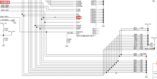

I have a AM3352 based custom board , i am trying to manually suspend and resume the system , I referred the below link to do so.
http://processors.wiki.ti.com/index.php/Sitara_Linux_Training:_Power_Management#Suspend_.2F_Resume
The system is going into Deeepsleep0 mode but I am unable to resume from the suspend mode . I used UART0 as an interrupt to resume from suspend mode.
The log is as follows.
root@RANA-AM335x:~ sync
root@RANA-AM335x:~ echo mem > /sys/power/state
[ 236.915649] PM: Syncing filesystems ... done.
[ 236.927215] Freezing user space processes ... (elapsed 0.01 seconds) done.
[ 236.948730] Freezing remaining freezable tasks ... (elapsed 0.01 seconds) done.
[ 236.968780] Suspending console(s) (use no_console_suspend to debug)
....it gets stuck here.
how to resolve this?
It works well in our AM3354 and AM3359 based custom boards.
