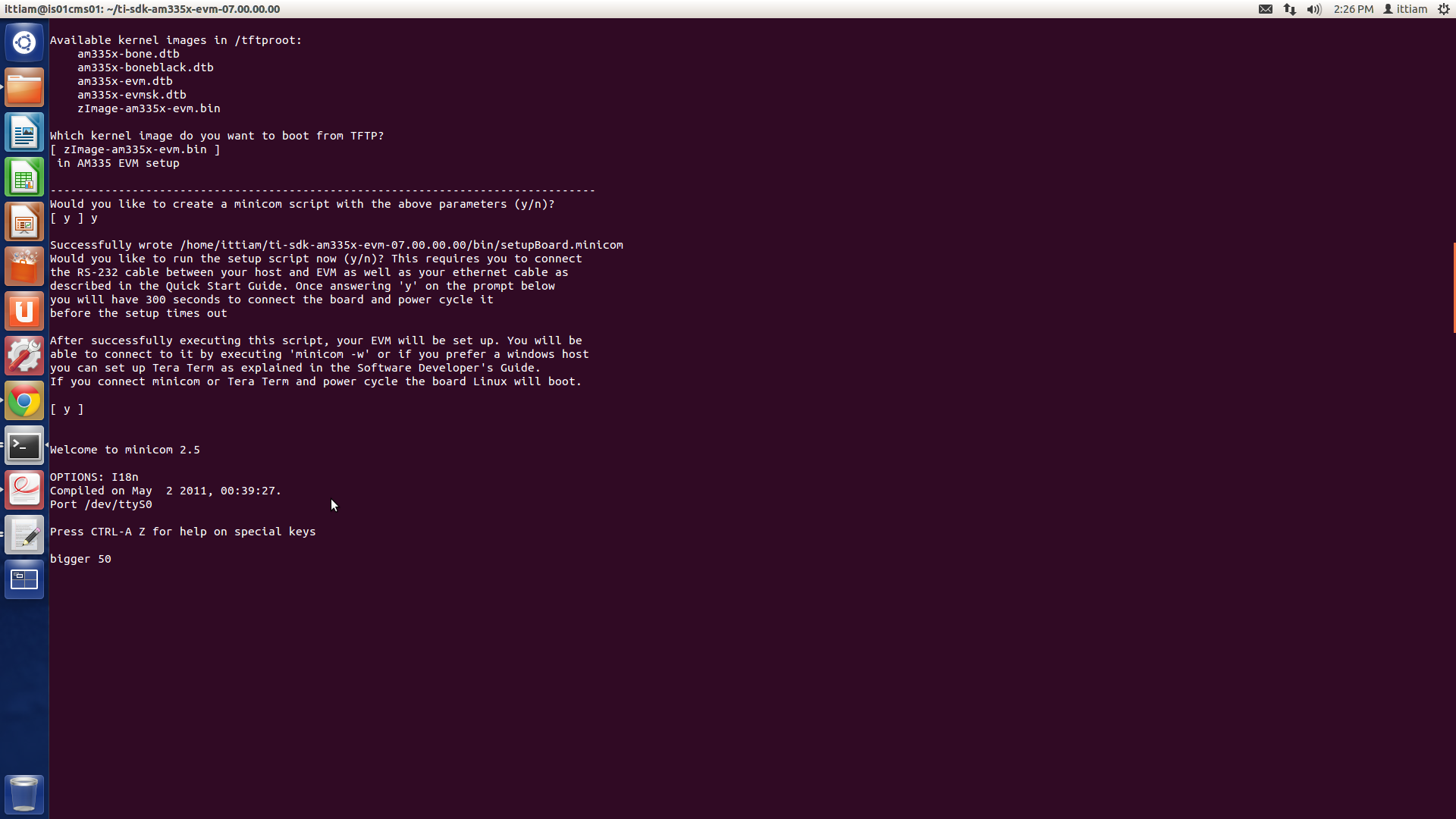

   d. in Minicom installation step. I got the prompt
Which serial port do you want to use with minicom?
[ /dev/ttyS0 ]
Then I pressed enter
   e. U-boot set up started.  asked linux kernel location and I gave tftp as option and for root file system I gave NFS as option and then I selected default kernel image then I pressed Yes for minicom setup script then I pressed yes for the next prompt ...
Then terminal changed to minicom terminal and got struct .
On the board side display is blank .
Is my set up procedure correct?

  • While running the setup script if I enter "y" for line no 442 in setup script , the script is calling "sudo minicom -w -S setupBoard.minicom"
    After I press Y I am getting minicom window where cursor is blinking and nothing is happening...
    It is not coming out of the minicom window.
    As per the setup script I should get "
    echo "You can manually run minicom in the future with this setup script using: minicom -S $cwd/setupBoard.minicom"
    echo "--------------------------------------------------------------------------------""
    which I am not getting.
    PFA, setup log
  • At which point do you start your board and does it boot into U-Boot?
    The only reason for this, that I can think of, is that the minicom script is first expecting "stop autoboot:" string which needs to be interrupted by a key press. If you had already started your board at this point, the script would wait until it times out.
    Can you try running the script commands manually? Your system has been configured by now and the only thing left is to save these variables to the ENV section of the NAND flash and boot the board. You can do this manually.

    If the board is switched on before the script is ran, the expected strings will never appear and the script will wait for the timeout.
    expect {
        "stop autoboot:"
    send " "
    expect {
        "U-Boot#"
    Try to first run the script and turn the board on later.

    Just follow what the setupBoard script does:
    setenv serverip 192.168.48.34
    setenv rootpath '/home/ittiam/ti-sdk-am335x-evm-07.00.00.00/targetNFS
    setenv bootfile zImage-am335x-evm.bin
    setenv ip_method dhcp
    setenv bootcmd 'run findfdt; setenv autoload no;dhcp ;tftp ${loadaddr} zImage-am335x-evm.bin; tftp ${fdtaddr} ${fdtfile}; run netargs; bootz ${loadaddr} - ${fdtaddr}'
    saveenv - this command saves the environment exported above to the NAND flash
    boot
