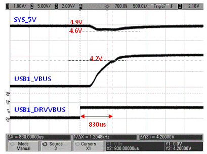

With USB1 (set as HOST mode, not OTG mode) of AM3358, USB1_DRVVBUS suddenly became LOW, only after 830us.
(Please see below scope capture.)
The issue sometimes happen, not always.
Can we know why USB1_DRVVBUS became LOW?
