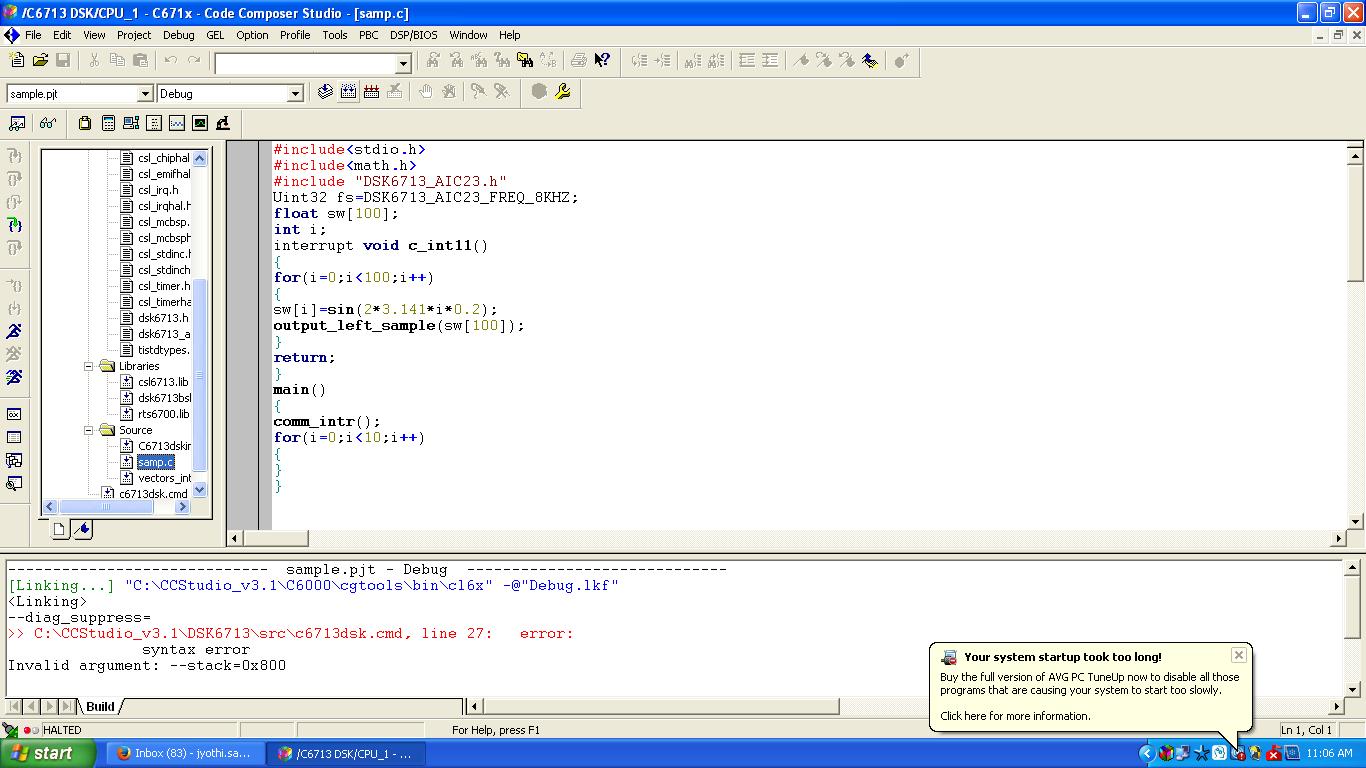

Hi am working on DSK6713 processor on ccs3.1. Getting an error: invalid stack:0x800
how to debug this error?

The error seems to be probelm with linker command file.
Which project are you building ?
Could you please provide error log and also attach the screen shot of your project explorer.
following is the command file i used

Try to remove the "stack, heap and suppress args" in linker command file (c6713dsk.cmd) then try to build the CCS project.
P.S : CCSv3 is very old release so please try to use the latest CCS version (CCSv5.4 & CCSv5.5)

I will try to work on CCS5. Right now i have removed stack, heap and diag supress and i run the program. I got the following error:
c6713dsk.cmd: error: system, can't open file '/.obj' for input :No such file or directory.

Try to use "Rebuild Project" for rebuilding the CCS projects since you have changed the linker file.
i tried to rebuild the project but showing error.Following is my program.i want to generate a sine wave and see it on oscilloscope..its a basic program but unable to run it please help me out
