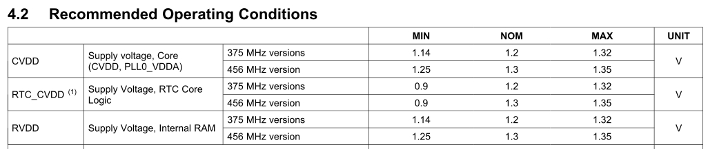

We designed our own C6745 DSP board.
Our board work normally. (ADC, DAC, EEPROM, SPI flash work normally).
According to datasheet, C6745*****3  has 375 MHz and C6745*****4 has 456MHz
CVDD and RVDD of C6745*****3 should be 1.2V
CVDD and RVDD of C6745*****should be 1.3V
We load the program into our boards. One board mount C6745*****3. Another board mount C6745*****4.
Two board have the same program performance (Run as many instructions as each other  per second)
What did I miss?  I didn't get higher CPU frequency.
Thanks for any advise.....

    I hope you are sourcing 1.2V CVDD for 375 MHz version and 1.3V CVDD for 456 MHz version. In that case, Please check whether you configured the PLLC to get the SYSCLK1 as 456 MHZ for the board mounted with C6745*****4.
    You have mentioned that you loaded the same program into both boards. I doubt, the program has different PLL configuration to operate at different frequencies.
    Please refer C6745 TRM for chapter 7 for more details about PLLC configuration.

    My DSP part number  is C6745D****3 and C6745D****4
    Both are version D.
    Device speed : 3 is 375MHz.  4 is 456MHz
    I utilize CCS6 + JTAG to load program.
    Check the sound output. Then, we could know whether there are too many instructions per seconds.....
    According to datasheet (below image), SYSCLK1 should be DSP operation frequency.  Right ?
    If PLLDV1 could control DSP operation frequency, I don't know which RATIO is for 375MHz ? Which RATIO is for 456MHz?  (Refer to below image)
    Only changing PLLDIV1 is enough?  Or, should I change other registers??
    I modify my own gel file. (Copied evmc6747_dsp.gel  in CCS6.  And change the PLL0 ......)
