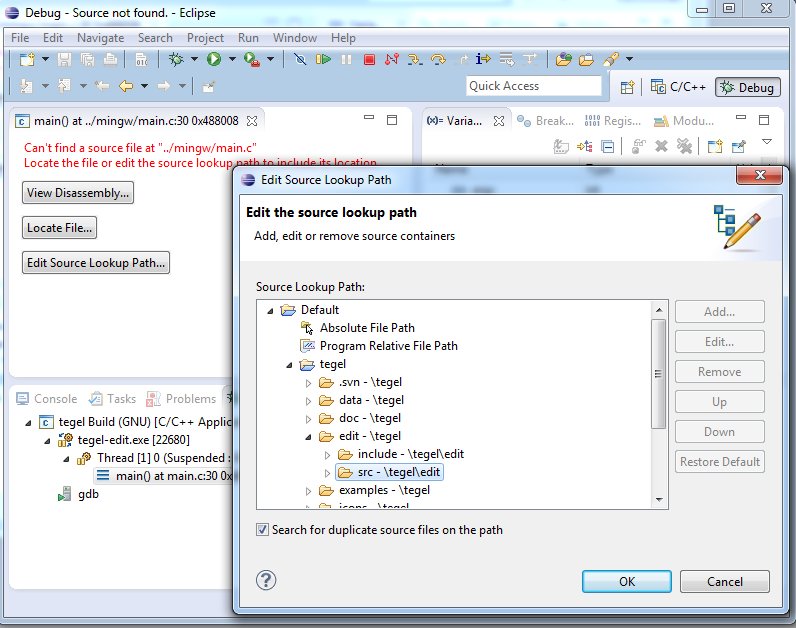

  • No.  I get this error when I try.
    Can't find a source file at "C:\GForge\starterware\dev\C6748_StarterWare_1_20_03_03\build\c674x\cgt\c6748\evmC6748\platform/../../../../../../platform/evmC6748/sysdelay.c"
    Locate the file or edit the source lookup path to include its location.
    And, considering I'm running Ubuntu Linux, I'm not surprised it can't find a file at C:\GForge... anything.
  • Hi Fourier,
    Please locate the file in your starterware installation while CCS for prompt to locate.

  • Hi Fourier,
    CCS would open one window and ask to locate the file when the problem occurs, then click that option and provide your exact "/opt/CCSv6/C6748_StarterWare_1_20_03_03/platform/evmC6748/sysdelay.c" path in CCS.
    Is is required to go that file to make delays while debugging.
    Please attach the screen shot when the error comes.
    It may look like this.
  • The resulting error page looks different for me, but clicking Locate File, I was able to point it to the right source file and then single step delay().
    It hangs at line 139.
    	while(flagIsrCnt);
