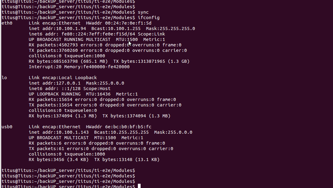

    The "10.100.1.143" IP address got in my host machine through OMAPL138 CDC-gadget ethernet device.
    I ran the script to reproduce your issue for the whole day & night but I'm not getting any errors.

  • Hi Brian,
    I'm not facing any issues even I have initiated the PLL bypass mode (EXTCLKSRC bit is 1).
    The ARM is running at 100MHz while PLL is in bypass mode (EXTCLKSRC = 1; Use PLL1_SYSCLK3 for the PLL bypass clock)
    PLL0_SYSCLK2 = 50MHz ( measured at CLKOUT pin )
    If I set the bit EXTCLRSRC to '0' then I'm not able to ping "usb0" IP (USB gadget)  from board since the ARM is running at 24MHz which is not recommended for USB section and again it started to ping after I set '1' to "EXTCLRSRC" bit.
    musb_g_ep0_irq 724: SetupEnd came in a wrong ep0stage in/status
    After all the testing, We never come across the issue.

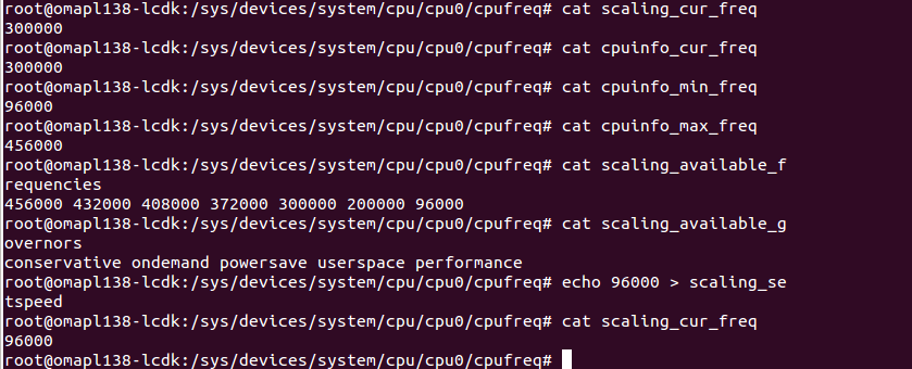

    root@omapl138-lcdk:/# cat /sys/devices/system/cpu/cpu0/cpufreq/scaling_available_frequencies
    456000 432000 408000 372000 300000 200000 96000
    How did you configure 100MHz and why don't you try 96MHz as per OPP ?
    What is your reference clock frequency (OSCIN) ?
    24MHz ?
    Are you trying to initiate PLL bypass mode ?
    What is the value of PLLM, POSTDIV, PREDIV registers ?
    Please ensure that you have followed the chapter 8.2.2.3 & 8.2.2.4 for changing the frequency to 100MHz.
    I'm able to run the ARM at 100MHz only when I have initiated the PLL bypass mode with ECLKSRC bit is 1.
    We are not facing any problem when we configured the ARM at 96MHz & 100MHz (PLL bypass mode ).
    Could you please share the code which is used to configure the ARM at 100MHz ?
    Have you modified the Linux PSP in PLL section ?
    Do you have any TI EVM board ?
    Could you please try this experiment on your TI EVM and try reproduce the same USB behavior  ?
