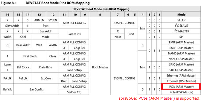

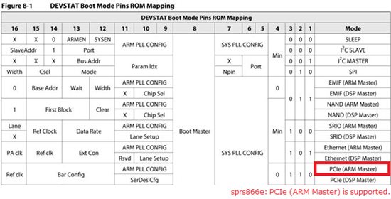

I am developping 66AK2H12/06 system.
a) I would like to boot ARM from PCIe endpoint.
   Is that suppported?
b) If yes,

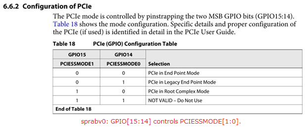

   How can I configure PCIESSMODE[1:0] and PCIESSEN in 66AK2H12/06?
     - GPIO[15:14] is multiplexed as PCIESSMODE[1:0]. Right?
     - How can I configure PCIESSEN? (I can not find it in the datasheet.)
Background:
I have refered datasheet and some application notes.
My understanding is:
  - PCIe (ARM Master) boot is supported in 66AK2H12/06.
  - GPIO[15:14] controls PCIESSMODE[1:0].

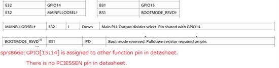

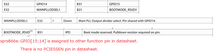

  But,
  - GPIO[15:14] is assigned to other function pin in datasheet.
  - There is no PCIESSEN pin in datasheet.
