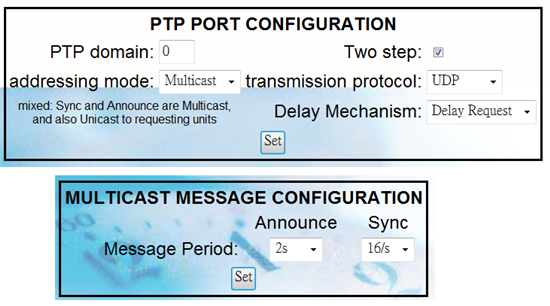

I am working with a EVMK2H board and would like to use IEEE 1588 (PTP)  function.  I use the command below to  sync with PTP server(with GPS).
Grandmaster: PTP server
slave: EVMK2H board
#./ptp4l -E -4 -H -i eth0 -s -l 7 -m -q -p /dev/ptp0
The result is as below.

PTP server setting is as below
Q1: Why can not sync with PTP server?
Q2: How to do to let 1PPS frequency, phase synchronization on different EVMK2H boards?

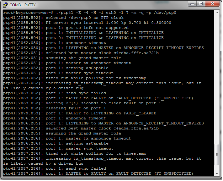

    I use two EVMK2H boards for testing. One is slave and the other is Master.
    Master: ./ptp4l -E -4 -S -i eth0 -l 7 -m -q -p /dev/ptp0
    Slave: ./ptp4l -E -4 -S -i eth0 -s -l 7 -m -q -p /dev/ptp0
    Slave can sync time with Master. PTP works fine.
    But if I use hw timestamping, then PTP doens't work.
    Master: ./ptp4l -E -4 -H -i eth0 -l 7 -m -q -p /dev/ptp0
    Slave: ./ptp4l -E -4 -H -i eth0 -s -l 7 -m -q -p /dev/ptp0

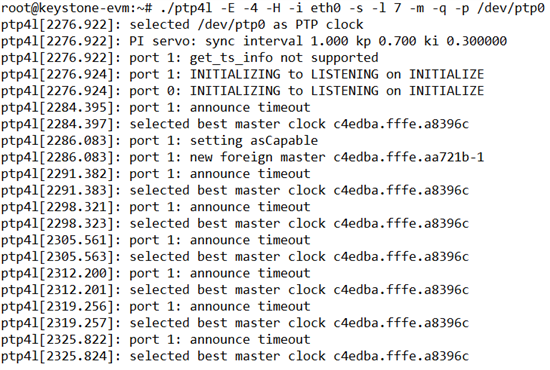

    Yes, I did follow the follow the instructions in the User's Guide. Below is testing result.
    1. HW timestamp over L2 works fine, but over L4 doesn't work.
    2. SW timestamp over L4/L2 works fine.
    3.If connecting with PTP server, either HW/SW timestamp over L2/L4 doesn't work.
    Note: <1>, <2> Master is EVMK2H board. <3> Master is PTP server
