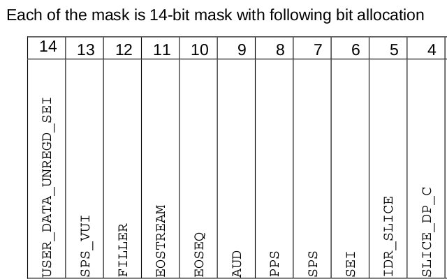

    	/* for the mask bits, please refer to codec user guide */

    	tStaticParam.videoStaticParams.h264EncStaticParams.nalUnitControlParams.naluControlPreset 	= IH264_NALU_CONTROL_USERDEFINED;
    	tStaticParam.videoStaticParams.h264EncStaticParams.gopStructure								= IH264ENC_GOPSTRUCTURE_UNIFORM ;//IH264ENC_GOPSTRUCTURE_NONUNIFORM; ;//
    	tStaticParam.videoStaticParams.h264EncStaticParams.transformBlockSize						= IH264_TRANSFORM_ADAPTIVE;
    	tStaticParam.videoStaticParams.h264EncStaticParams.log2MaxFNumMinus4						= 0;
    	tStaticParam.videoStaticParams.h264EncStaticParams.referencePicMarking 						= IH264_LONG_TERM_PICTURE;//IH264_SHORT_TERM_PICTURE;
    	tStaticParam.videoStaticParams.h264EncStaticParams.enableLongTermRefFrame 					= 1;
    	tStaticParam.videoStaticParams.h264EncStaticParams.nalUnitControlParams.naluPresentMaskStartOfSequence 	|= 0x23BE; //|= 0x2380;
    	tStaticParam.videoStaticParams.h264EncStaticParams.nalUnitControlParams.naluPresentMaskIDRPicture 		|= 0x23BE; //|= 0x2380;
    	tStaticParam.videoStaticParams.h264EncStaticParams.nalUnitControlParams.naluPresentMaskNonIntraPicture 	|= 0x23BE; //|= 0x2380;
    	//tStaticParam.videoStaticParams.h264EncStaticParams.nalUnitControlParams.naluPresentMaskEndOfSequence |=	0x380;
    	tStaticParam.videoStaticParams.h264EncStaticParams.nalUnitControlParams.naluPresentMaskEndOfSequence = 0;

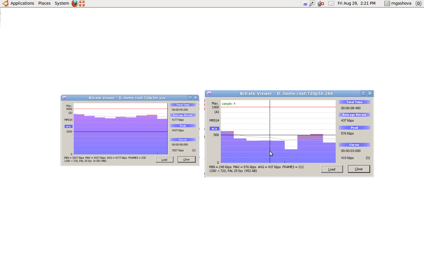

    Could you check the encoder file with Bitrate Viewer please.
    You could find a link in this e2e forum thread.
    Post me what it shows.
    Margarita

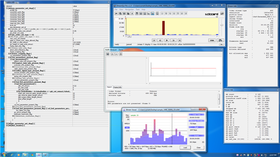

    We have analyzed the encoder o/p, using the recommended software "Bitrate Viewer" and Elecard
    stream analyser. The Screen shot and the sample h264 file is attached for your ref. 7416.sample_1080_500Kb_ES.h264.zip
    R.Abdul Rahman.

    Could you set tStaticParam.videoStaticParams.h264EncStaticParams.nalUnitControlParams.naluControlPreset
    to  IH264_NALU_CONTROL_USERDEFINED and set all nalUnitControlParams.
    Set the FILLER(bit 12): This bit informs encoder to insert filler data. It is encoder’s decision to put
    filler data or not based upon the constant bit rate need
    Do not set it for naluPresentMaskEndOfSequence.
    Check the h264enc user guide page 174 for the  Control masks and the table on 175 for the bit allocation:
    Let me know the result.
    Margarita

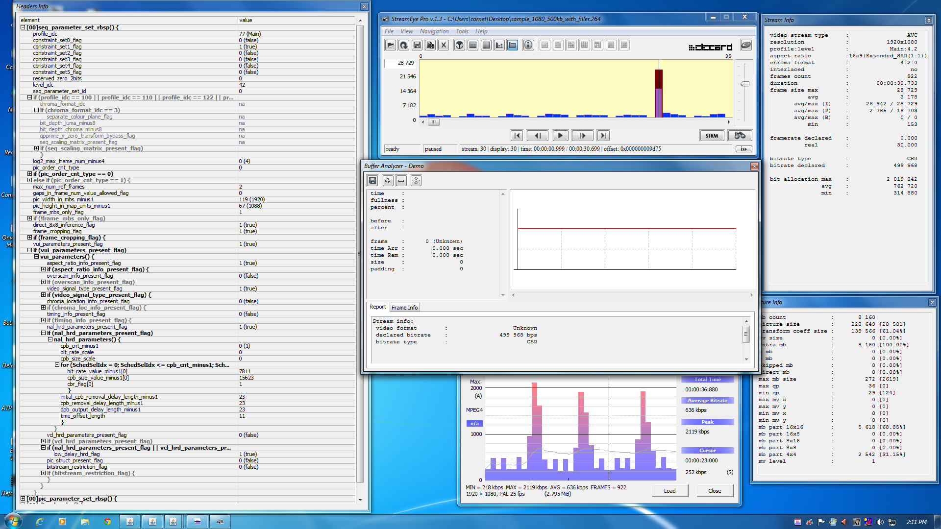

  • Hello Margarita,
    We have applied your recamondded settings. The elecard stream analyser shows "bitrate type: VBR".
    We have attached the screenshot and the sample file with this mail.
    We have attached the last encoder settings which you have asked.
    #if 0
    	tStaticParam.videoStaticParams.h264EncStaticParams.gopStructure								= IH264ENC_GOPSTRUCTURE_NONUNIFORM;//IH264ENC_GOPSTRUCTURE_UNIFORM ;//
    	tStaticParam.videoStaticParams.h264EncStaticParams.referencePicMarking 						= IH264_SHORT_TERM_PICTURE;
    	tStaticParam.videoStaticParams.h264EncStaticParams.enableLongTermRefFrame 					= 0;
    #endif
    	tStaticParam.videoStaticParams.h264EncStaticParams.nalUnitControlParams.naluPresentMaskStartOfSequence 	|= 0x33BE; //|= 0x2380;
    	tStaticParam.videoStaticParams.h264EncStaticParams.nalUnitControlParams.naluPresentMaskIDRPicture 	|= 0x33BE; //|= 0x2380;
    	tStaticParam.videoStaticParams.h264EncStaticParams.nalUnitControlParams.naluPresentMaskNonIntraPicture 	|= 0x33BE; //|= 0x2380;
    	 tStaticParam.videoStaticParams.h264EncStaticParams.vuiCodingParams.vuiCodingPreset 			= IH264_VUICODING_USERDEFINED;

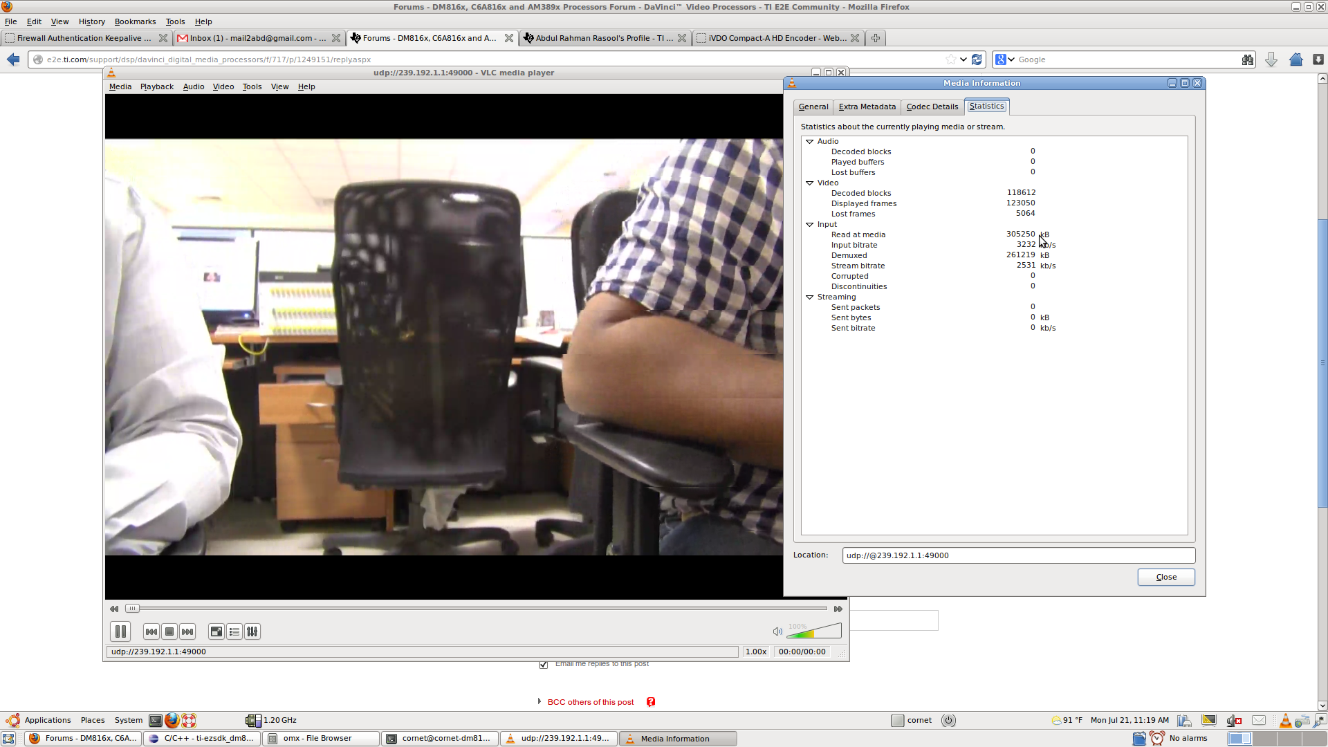

    we are using the Sony SDI Camera as the Source and we are running the capture and encoder application.
    so we dont have the .yuv file.
    My SDK and Enocder version details as follows
    1. EzSDK version 5.05.02.00
    2. Encoder version 02_00_02_02.
    we have a doubt can you please clarify,
    if we set the encoder to CBR mode encoder should maintain the output bitrate as constant. irrespective of the complexity and resolution right ? ( video Quality degradation and frame skip is acceptable )
    R.Abdul Rahman.
    Could you grab the yuv before the encoder component, save in file and share it with me.
    Margarita
  • Hi Margarita,
    we have captured the file but unable to upload the file due to file size.
    is there any FTP server or some other way to share this file to TI forum.
    1. if we set the encoder bitrate 512 with this video sequence then encoder o/p bit-rate goes upto 2000
    2. If we set the same video with 1080 then the o/p bit-rate goes upto 3500
    Note: we are not much concern about the output video quality. but the o/p video bitrate must be contant.
    Please help us to resolve this.
    R.Abdul Rahman.

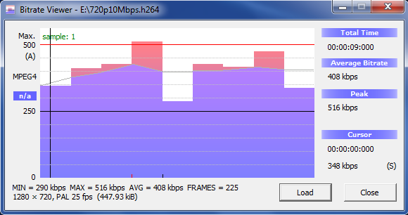

    Test stream : Sample_yuv.yuv
    Resolution: 1280x720
    Here is results on my side:
    On the first Bitrate View is the encoded video with 5000kb/s.
    On the second one is with 500kb/s.
    Margarita

  • Hi all,
    I have the same problem to get a constant bitrate in DM8168 board. I used the same encoder settings recommended by Margarita but I couldn't get a constant bitrate. In fact, I used the same ilclient_utils.c file of the encoder demo uploaded by Margarita with the correct encoder settings. This is my result:
    I am wondering if I am missing some settings.
    Any help with this would be much appreciated!!
    - Eugenia
  • Hello Eugenia,
    Have you enable partial frame skip (enablePartialFrameSkip) as well?
    Margarita
  • Hi Margarita,
    Yes, I enabled the partial frame skip. I attached you the ilclient_utils.c file that I am using for the encoder demo.
    Eugenia
    /cfs-file/__key/communityserver-discussions-components-files/791/6648.ilclient_5F00_utils.c.txt
  • Slighty off topic but I am running on dm8169 Z3 RPS-20130705. Where can "h264enc user guide page 174 for the  Control masks" be downloaded from? I am unable to find this User guide with Google.
    I am seeing different settings for I frame and B frame such as
     tStaticParam.videoStaticParams.h264EncStaticParams.nalUnitControlParams.naluPresentMaskStartOfSequence |= 0x2180;
    How are these values calculated?
    Rick

    Could you share with me the yuv file which you are encoding, please.
    I need also information about bitrate and resolution.
    What is the encoder version which you are using is it the default one in EZSDK 5.05.02?
    Margarita
  • Hi Margarita,
    Sure. Info sent by email.
    -David
