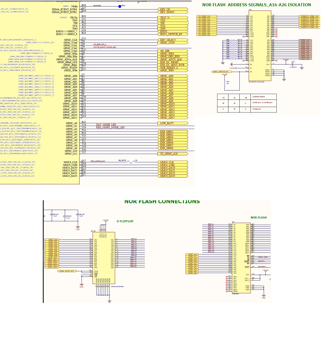

Here is the details of the hardware that we have:
http://e2e.ti.com/support/arm/sitara_arm/f/791/t/334694.aspx?pi301021=1
(silicon version used in 2.1)
 If we try to access the 128MB NOR flash then, there is no issues seen. The NOR flash can be write/read. But, when we try to access beyond 128MB (last bit of NOR flash A26 is not getting asserted), the pin connected to NOR flash from AM335X is GPMC_A11 and the corresponding PIN MUX register value (@ address 0x44e1086c which is conf_gpmc_a11) is 0x20. (Also tried with 0x24)
 I don’t think, there is no other register other than the pin mux register that need to be looked since the flash access of 128MB is okay. Please advice any other possibility to try.
 Please confirm whether the GPMC pin Muxing as in Table 7-5 of latest TRM (j) is validated in any of the designs and found to be working (GPMC_A[27])

    Can you please post a schematic (PDF file) of your connections between the AM335X GPMC and the NOR Flash?
  • Hi Biser, can you please share your email address so that I can email you?
  • I have sent you a friend request. My e-mail is in it.
  • I can't see anything wrong on the schematics. Can you post the GPMC registers settings?

    I have feedback from the factory team, confirming that 256MB CS size is working for 16-bit AD mux mode. Here is the description:
    "AM335x GPMC 16bit Multiplexed NOR Flash 256MB access should be working now since I have confirmed the GPMC_A27 pin(GPMC_A11 Mux mode 4) functionality for the 128MB+ access.
    The GPMC_A27 pin is going to a weird state when configured for the Mux mode (based on the SYSBOOT[11:10] setting) by the Boot ROM at power on reset. Hence configuring again to the Mux mode the GPMC_A27 is not getting asserted. This needs a workaround of setting the GPMC_CONFIG1_0 = 0x0  and then configuring for the Mux mode GPMC_CONFIG1_0 = 0x00001200. After this sequence the GPMC_A27 assertion is happening as expected for the 128MB+ location.
    I have verified this on a AM335x ICE EVM v2.1A and accessing through the CCS Memory window.
    GPMC_CONFIG1_0 = 0x00001200 – 16bit Multiplexed mode
    GPMC_CONFIG7_0 = 0x00000050 – Base Address 0x10000000, 256MB CS# size
    Memory location tested for the GPMC_A27 function:   0x18000000
    Please try this on your side and provide your feedback."
