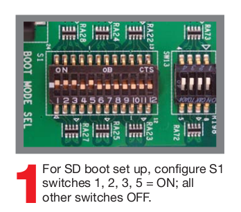

    We have a customize board of DM8148 and on that I have set following boot sequence.
    "NAND-> NANDI2C->MMC->UART"
    On this board nand is erased and I have prepared sd card with MLO.
    SD Card is "8GB microSDHC UHS-1 Class10".
    But our customize board go to UART mode only.
    It not detecting SD card( or MLO), sd card interface is working fine, we have tested it.
    Please help on this, why this is happening??
    When I set boot switch setting for SD card then what will be the booting sequence set on DM8148 EVM?
    Is there any way to set only SDCard boot mode on DM8148 SOC??

    You should first try with the MMC/SD boot as 1st option. The boot order depends on the sysboot pins (btmode[4:0]), see the DM814x TRM, chapter 4 ROM Code
    4.5 Booting
    On the DM8148 EVM, the boot from MMC/SD card you should set the BOOT MODE SEL pins as:
    This correspond to BTMODE[4:0] = 10111:
    BTMODE4 = 1, BTMODE3 = 0, BTMODE2 = 1, BTMODE1 = 1, BTMODE0 = 1
    On a DM814x custom board, this corresponds to physical pins V26/PINCNTL93, W27/PINCNTL92, V27/PINCNTL91, Y28/PINCNTL90 and U26/PINCNTL89
    From the Table 4-8. BTMode[4-0] Configuration Pins, BTMODE[4:0] = 10111 corresponds to boot order:
    MMC/SD -> SPI -> UART -> EMAC
