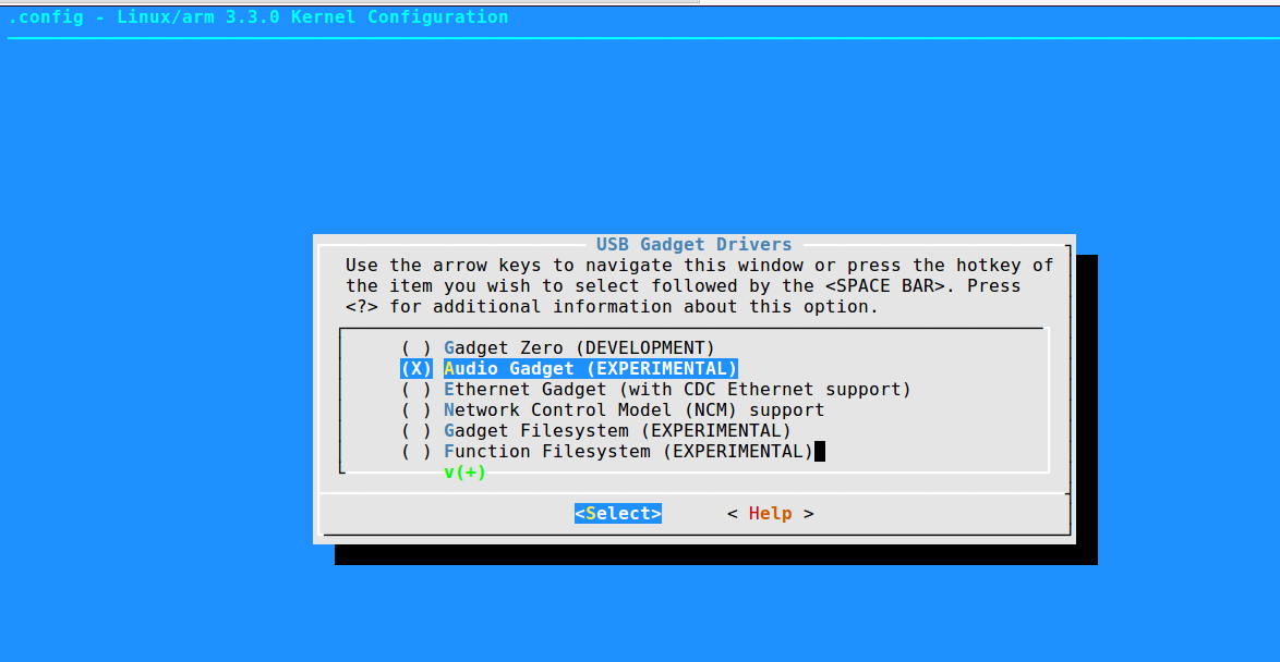

  • Hi Chirag,
    Have you tried enabling the AUDIO gadget driver in the linux 3.3 and ran it on your hardware? and resulted with errors?
    If you enable the above said option( refer the above snapshot of menuconfig) , then the Audio gaget driver will be an inbuilt driver; you need not insert it as a module....right?
    Would you post the complete logs including your boot logs and error messages while "insmod/modprobe"?

  • Hii Shankari,
    i have try DaVinci PSP 03.22.00.06 for g_audio module insmod, i have resolved my insmod problem for kernel.
    i have enable ALSA for Davinci and OMAP in sound card support ,Also try to insmod musb_hrd ,CPP41,CPP41-dma to run g_audio. other g_filestorage run correctly but for g_audio it gives error in interfacing .i tried lot in kernel source but can't remove that error.
    i got "aplay -l "o/p in my PC as a AUDIO subsystem added after g_audio insmod ,from ALSA it work correct ,but in dmesg continuous error "usb_set_interface failed (-32) " .Also same error at target system side.
