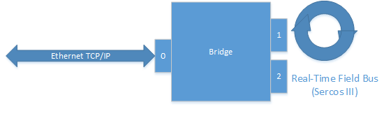

I am looking for an embedded solution to design an Ethernet to Sercos III (Master) bridge.  Other Real-Time Field busses will follow (EtherCat, etc.)  I have found many TI Arm devices that may accomplish this task.  However, I would like to get a Eval/development kit to get started.  What are my options?  As a requirement, I need a dedicated Ethernet and a single PRU-[] unit, I think?  Please advise me of any options that fit these criteria.

    PS.  I called TI support and they directed me to this forum.  They indicated that the "Factory Engineers" that developed these EVM(s) would respond to my question.  I could develop a daughter board if necessary.  I would rather not.  I am looking for a turn key solution (Hardware) to develop the software that completes the idea that attached in visual form.
    Ethernet (TCP/IP) to Sercos III (Master)  There are many sercos III slave options but it appears that I will most likely have to develop a master.

  • We have obsoleted the IDK because everything it does can be done with our EVM or the new ICE board.
    For Sercos III master you do not need PRU, so it could use regular Ethernet port, usually the slave has latency issues, so this is why we use PRU for the slaves.
