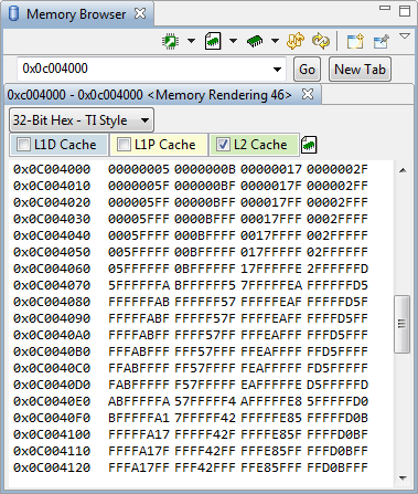

I've put a breakpoint at the row DstAddress = (UINT32*)(aSHARED_MEMORY_BASE + PktSize);
In my first run DstAddress = 0x0c000000 and i get no problems
In the second run DstAddress = 0x0c004000 and when i reach the breakpoint the data in the shared memory is correct. But if i proceed step by step when i reach the row UINT32 Read = DstAddress[j]; the readen value is wrong and i see in the watch window the data changed with wrong values.
But if i deselect the L1D Cache combobox the data returns to the correct value.. So the data in the cache is wrong and the core uses this wrong values

    This is what i get when i reach the row DstAddress = (UINT32*)(aSHARED_MEMORY_BASE);
    While after executing UINT32 Read = DstAddress[j]; i get
    And deselecting the combobox
