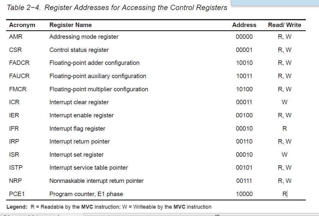

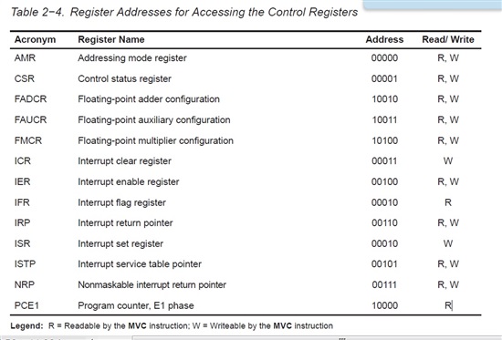

I'm would like to know exactly where in the C672x CPU Register File is the dMAX Event Trigger Register (DETR).  The Instruction Set document only lists these registers:
I would like to know the 5-bit address for accessing this register via the MVC instruction.  Thank you.
