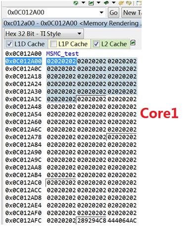

I met a problem about cache coherence when L1D is cacheable on C6670.
My code is base on sys/bios 6.33, C6670 and CCSv5.3.
I just want to use a 256 bytes buffer on MSMC and use core0 writes this buffer and then the core0 inform core1 to print this buffer on CCS's console.
To do this, my code flow is below
1). Define a global buffer MSMC_test
    #defineMSMC_test_len 256
    #pragma DATA_ALIGN   (MSMC_test, 64)  // to align with the L1D cache line
    #pragma DATA_SECTION (MSMC_test, ".shareMemotest");
     unsigned char MSMC_test[MSMC_test_len];

1. In the 5) step, when the Core1 prints the MSMC_test[0~127], all things go correct. I can get the correct results on console and the Memory Broswer is below

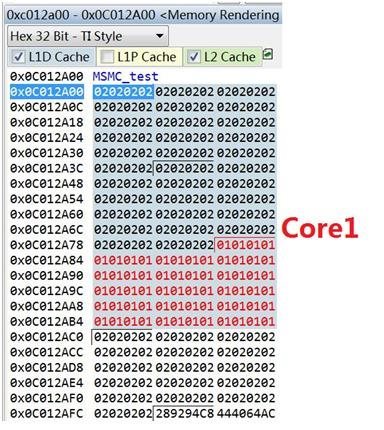

2. But when the Core1 prints the MSMC_test[128], the Memory Broswer shows the MSMC_test[128~191] changes to the last data  like below (to begin with, Core0 writes 0x01 to MSMC_test[0~256] and the second time Core0 writes 0x02 to MSMC_test[0~256])
So I can not get the correct on console.

    When the Core1 starts to print the 256 bytes buffer, the Memory Broswer showed the data correct whether the L1D/L2 cache boxes were selected or not.
    But when the Core1 print the 128th byte of the buffer, the Memory Broswer showed the buffer[128~192] were incorrect with the L1D/L2 cache boxes were selected. At the same time, if I deselected the L1D/L2 cache boxes, the buffer[128~191] were correct.
    And when the Core1 print the 192nd byte of the buffer,  the Memory Broswer showed the buffer[192~255] were incorrect with the L1D/L2 cache boxes were selected. At the same time, if I deselected the L1D/L2 cache boxes, the buffer[192~255] were correct.
    I searched some old threads and found the solution.
    When I invalidate the XMC's prefetch buffer before the Core1 reads the MSMC, all things go correctly.
    This is also mentioned in CorePac datasheet. And the CorePac datasheet tells me that if invalidating the prefetch buffer, the performance of w/r MSMC/DDR3 will be degraded.

    It looks like you're running into the issue defined in Advisory 33 of the TMS320C6670 Errata.  The workaround is to disable the prefetching for the MAR range 0x0C00 0000 - 0x0F00 0000 (i.e. what would effectively be the MSMC range.)
    You can do this by setting the PFX bits of MARs 12-15 to 0 (this is 1 by default.)  This will disable the prefetching for those addresses.
    Chad
