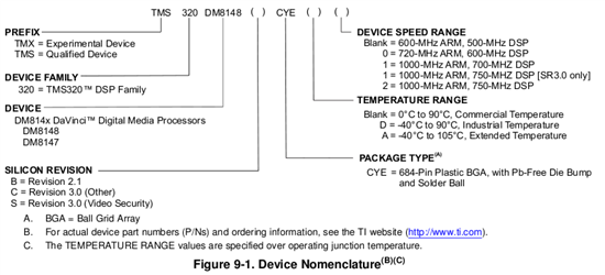

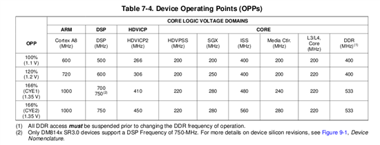

    DM814x DDR3 support up to 533MHz at OPP166/1.35V for CYE1 and CYE2 devices.
    Padmanabhan KS said:
    Is this change applicable to all silicon revisions?
    Yes, to all silicon versions which are CYE1 or CYE2 devices. See the DM814x datasheet, 9.1.2 Device and Development-Support Tool Nomenclature
    DM814x datasheet, section 7.2.2.1 Dynamic Voltage Frequency Scaling (DVFS)
