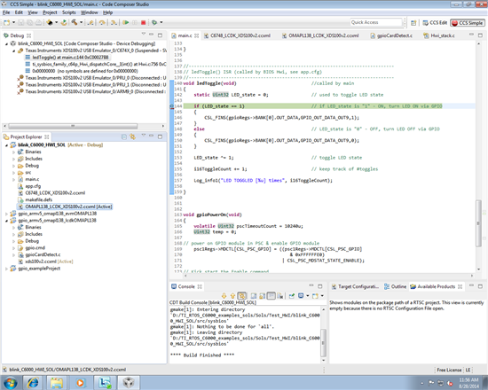

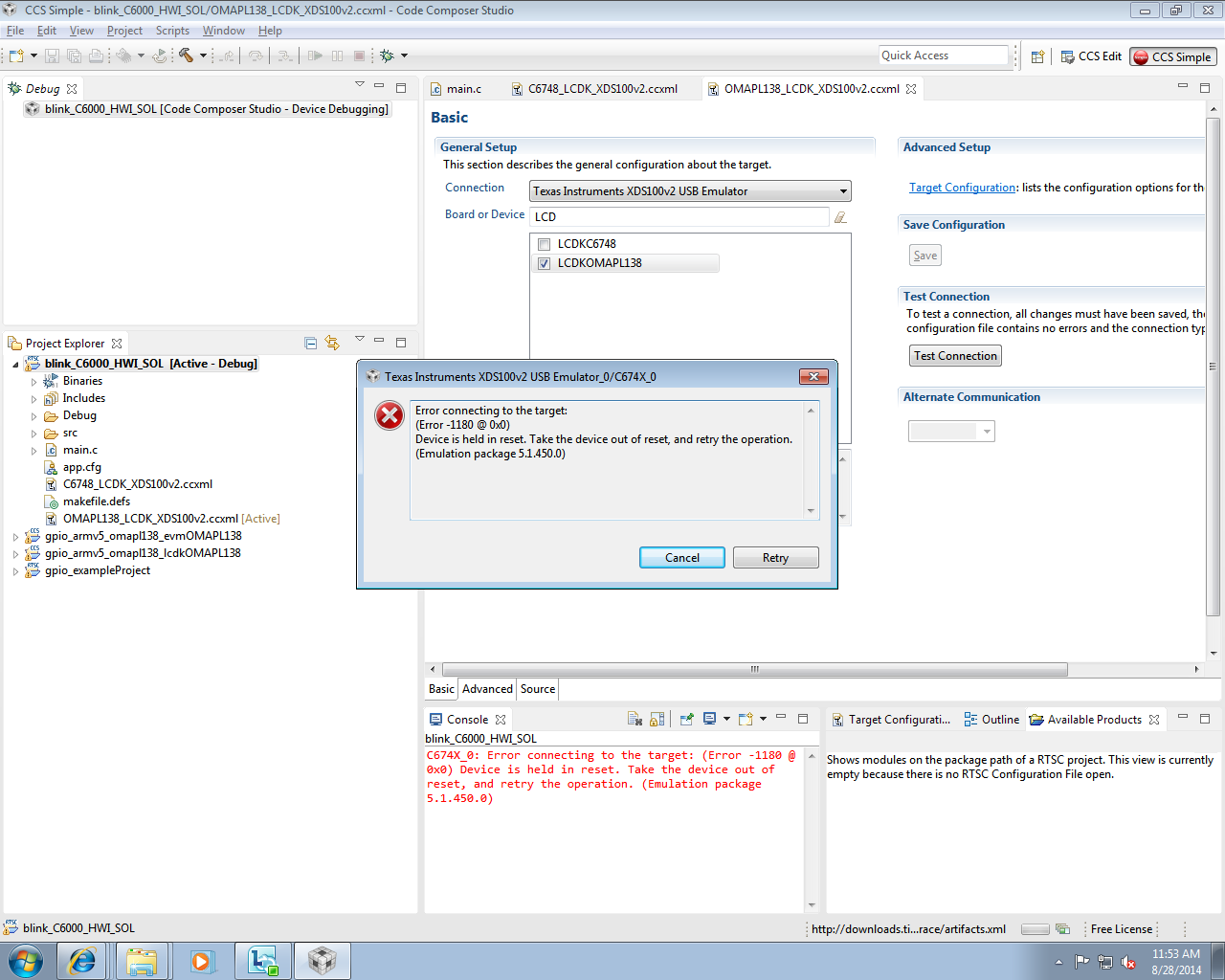

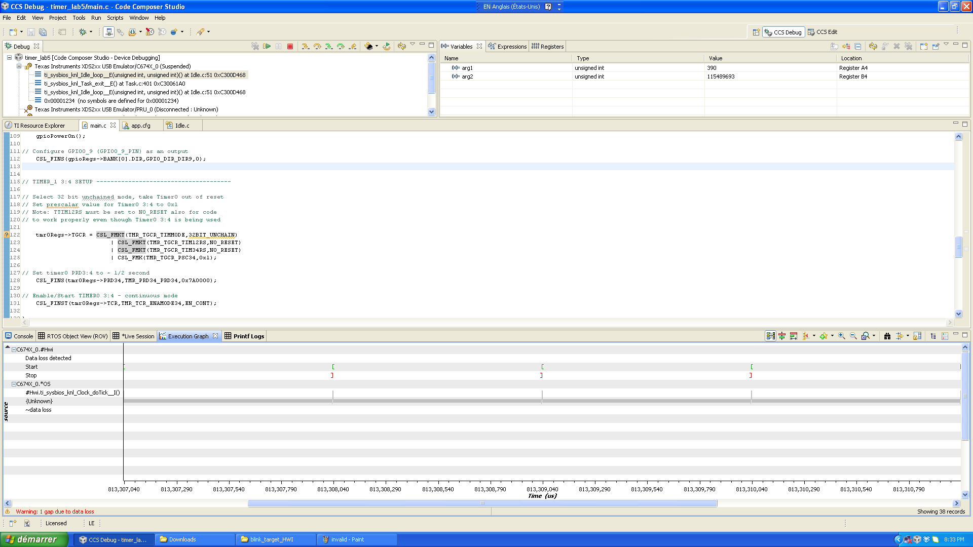

I have been working through the Kernal Workshop for the TI-RTOS to get up to speed on working with the OMAP L-138 processor.  In lab 5 I am supposed to initiat a LED to blink based on a HWI on timer 0 3/4.  The first thing I noticed is that the lab calls for there to be a InitCpuTimers() function call.  I do not see this in the C6000 main.c file but I do see a lot of code that would be setting up the timers in the hardware_init() function.  I am not sure if the file I have is missing something or not.  I have been setting up the HWI interrupt as such:
When I use this configuration I get no output on the LED.  The interesting thing is that if I change the event ID to 4 (Timer0 1/2) system tick I then get a nice 500hz square wave signal.
As a result it seems like the HWI is setup mostly correctly but there is just something missing.  I don't know if the timer is just not fully configured or if I am missing something more fundamental here.  Any advice would help here.

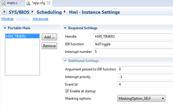

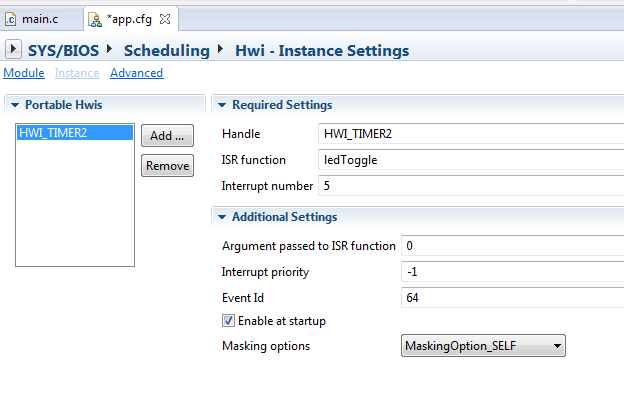

  • Hi Koplan,
    I am not familiar with the lab example you are working on but from your problem description, it looks like you need to create a Timer instance and not a Hwi instance.
    Here's what you need to do. Open the cfg file in CCS and from the UI select the Timer module. In the Timer module, you will see a link to a device-specific Timer support module. Select that link. It will open a Timer64 page. You can add this Timer64 module to your configuration and use it to create a timer instance for Timer 0 3/4.
    When you create a timer instance, you will also specify a Timer ISR function which will be called each time the timer expires. You can toggle the LED in this function. The timer module manages timer init code as well as setting up a Hwi for you.
    Ashish

  • I did a diff on my Main.c and the "Solution" Main.c and found the only differences where in my commented out "delay" function vs. being completely removed.  With that said, I went ahead and removed that completely to bring it exactly in line with the solution file and I got the same result.  Compiles, loads, just doesn't blink. (File attached below).  If I set a break point in ledToggle it is as if it never actually reaches the ISR because it never breaks.  It feels like the timer never starts running.
    I then went ahead and attempted to "import" the solution into my workspace.  Doing this I had multiple issues.  The first was that I was getting an error related to the "Can't fine platform package 'ti.platforms.evm6748'. TI platforms no longer shipped....  This was able to be remedied by changing the TI-RTOS for C6000 version to 2.0.1.23 in the project configuration.  Once I remedied this and got the correct include for the PDK into the project it compiled and ran fine but I still did not get the LED to blink.
    To help verify that my HW is not broken I went onto the "Timer" portion of the lab and that worked perfectly without any problem and was very straightforward.

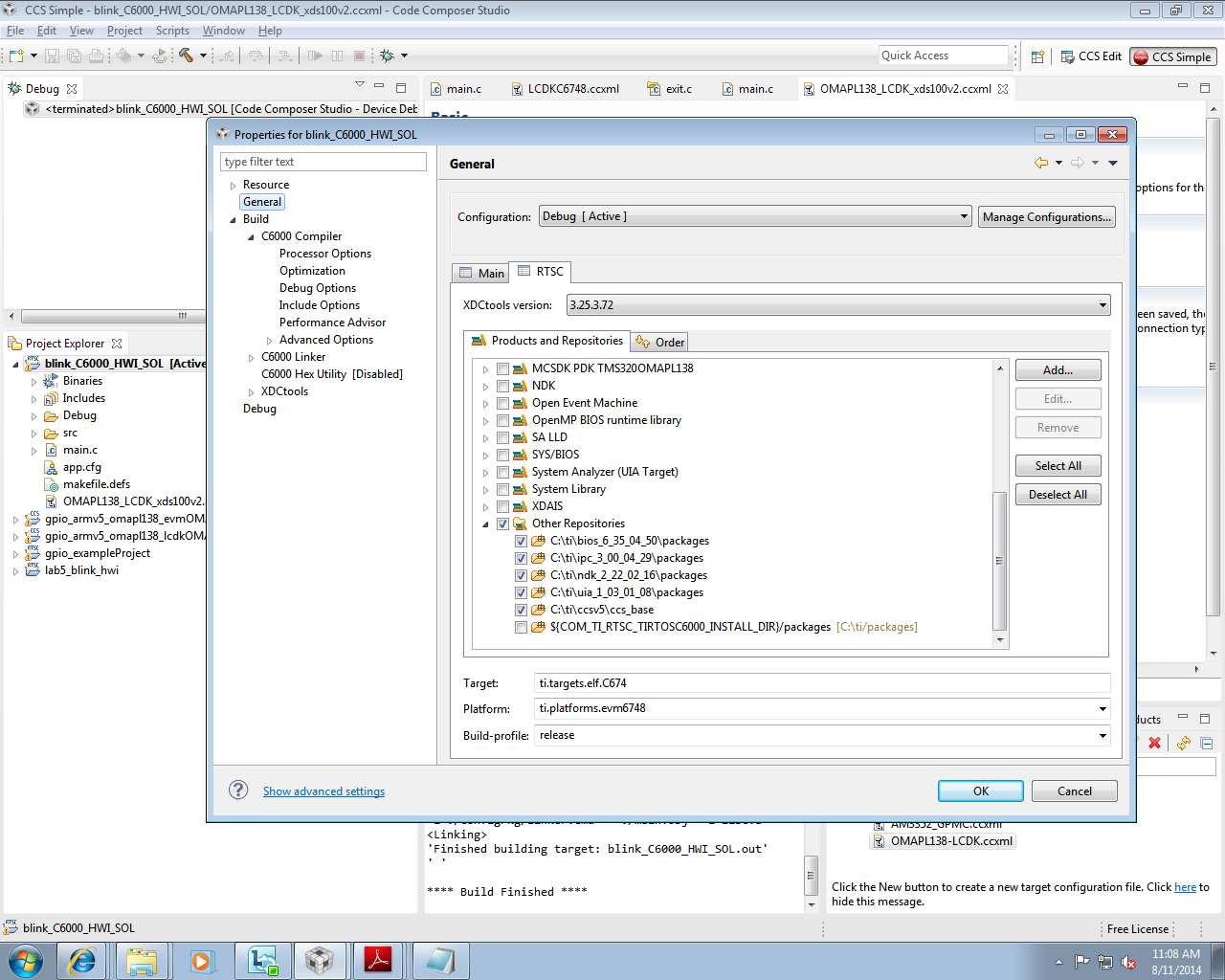

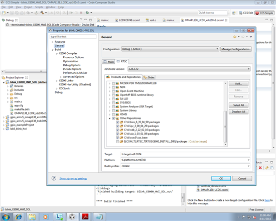

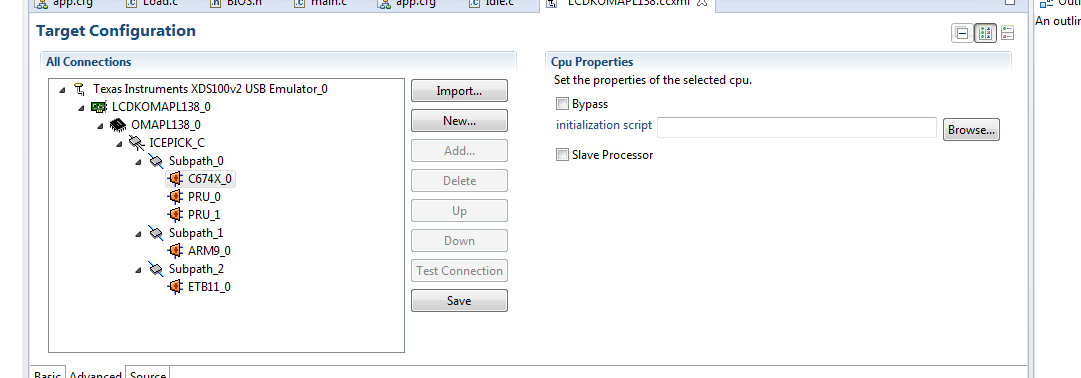

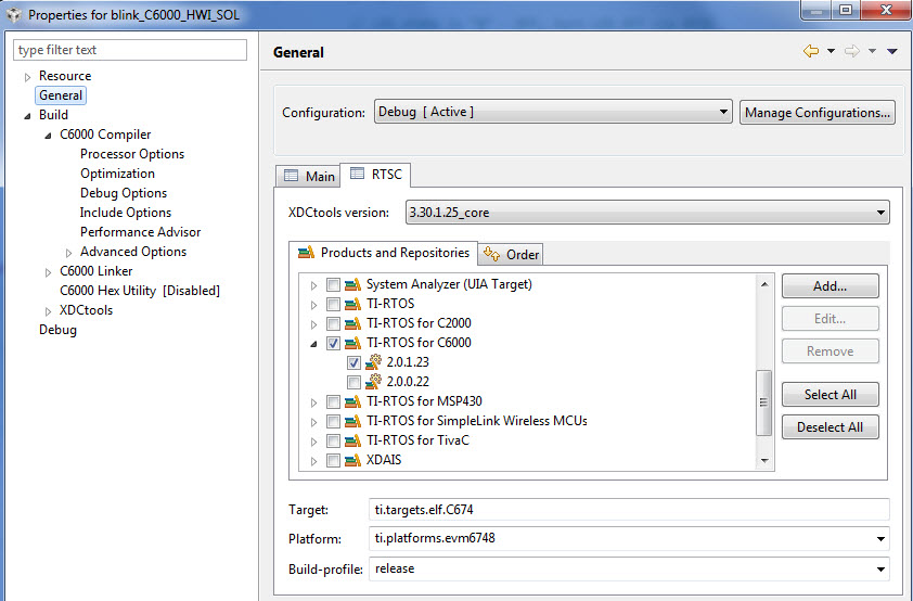

  • Chris,
    Thanks for the attachments. I was able to import your project into my CCSv6.0, build (zero errors) and run (it blinks). I am using the C6748 LCDK.
    I am at a loss of what to suggest here. First, your code is "perfect". The quotes are meant to a) give you a warm fuzzy that you did everything correctly in the code and w/the BIOS .cfg file - so you succeeded in the lab; b) to give you a cold fuzzy that something is still wrong.  ;-)
    It is hard to debug this from afar. The only difference between our boards is the ARM9 vs. no ARM9. The other differences are:
    - you have System Analyzer checked (enabled) in your app.cfg file (UNCHECK that) - it is already used as part of the TI-RTOS SDK. I had mistakenly checked that in the solution (which I am now fixing FYI in all projects).

    6) I have created new target configuration for OMAPL138LCDK board and wokeup the OMAPL138 through  "Launch selected configuration" option.
    7) Connect ARM core followed by DSP.
    8) Select DSP core and load gpio out file.
    9) Now, I'm able to load and run on OMAPL138LCDK (DSP core) board and gpio got blinking.

    // hardware_init()
    void hardware_init(void) //called by main
    // PINMUX SETUP ---------------------------------------------
    // Key to be written to enable the pin mux registers for write
    sysRegs->KICK0R = 0x83e70b13;
    sysRegs->KICK1R = 0x95A4F1E0;
    // Enable the pinmux for the GPIO bank 0 pin 9 (tied to LED on LCDK)
    sysRegs->PINMUX0 = ((CSL_SYSCFG_PINMUX0_PINMUX0_27_24_GPIO0_9)
    << (CSL_SYSCFG_PINMUX0_PINMUX0_27_24_SHIFT));
    // mux between Timer 0/1 and GPIO[8:11], enable Timer0/1
    sysRegs->PINMUX4 = CSL_FMKT(SYSCFG_PINMUX4_PINMUX4_3_0,TM64P0_OUT12);
    // GPIO SETUP ---------------------------------------------
    // First, enable the GPIO Module in the PSC
    gpioPowerOn();
    // Configure GPIO0_9 (GPIO0_9_PIN) as an output
    CSL_FINS(gpioRegs->BANK[0].DIR,GPIO_DIR_DIR9,0);
    // TIMER_1 3:4 SETUP --------------------------------------
    // Select 32 bit unchained mode, take Timer0 out of reset
    // Set prescalar value for Timer0 3:4 to 0x1
    // Note: TTIM12RS must be set to NO_RESET also for code
    // to work properly even though Timer0 3:4 is being used
    tmr0Regs->TGCR = CSL_FMKT(TMR_TGCR_TIMMODE,32BIT_UNCHAIN)
    | CSL_FMKT(TMR_TGCR_TIM12RS,NO_RESET)
    | CSL_FMKT(TMR_TGCR_TIM34RS,NO_RESET)
    | CSL_FMK(TMR_TGCR_PSC34,0x1);
    // Set timer0 PRD3:4 to ~ 1/2 second
    CSL_FINS(tmr0Regs->PRD34,TMR_PRD34_PRD34,0x7A0000);
    // Enable/Start TIMER0 3:4 - continuous mode
    CSL_FINST(tmr0Regs->TCR,TMR_TCR_ENAMODE34,EN_CONT);
    If you have any insight on this it would be very much appreciated.

    FYI, this project requires TI-RTOS for C6000:
    I made no mods to the project properties, platform, TI-RTOS, etc. This may be why you were getting errors when you built - you were missing all of the tools in the TI-RTOS SDK.

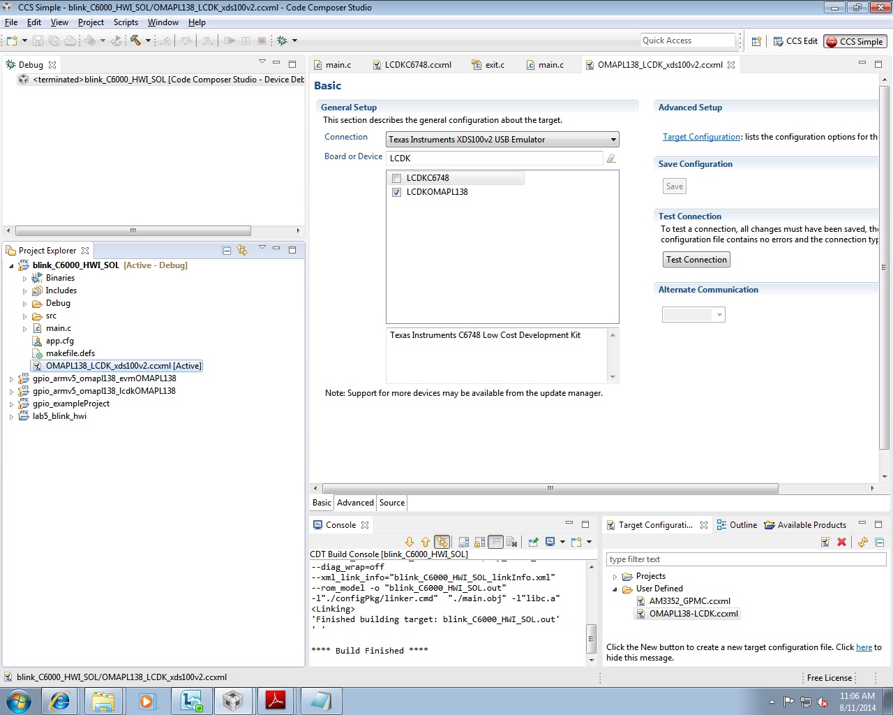

    I chose the OMAP-L138 LCDK version of the target config file. It blinks fine. I had chosen this target config file before - so I really have no idea why it didn't work before and it works now. I did do a "clean project" before I built this time. That was the only difference. Not sure why that made the difference I saw.
    I cannot simply connect to the DSP without the ARM connected first. If you choose the OMAPL138_LCDK as the target, you get 4 CPUS - DSP, ARM, and two PRUs. If you connect to the DSP only, there is no GEL file that runs and therefore you can't load a program to it. However, if you connect to the ARM first, the gel file runs and wakes up the DSP. Then I connect to the DSP and load the .out file to the DSP. It works fine.

  • I am interested in this problem too. There is a warning on the source main.c file:
    The warning is on 32BIT_UNCHAIN. I don't know whether it matters or not.
    I download the project using timer (Blink_target_TIMER), add UIA. The HWI interval is rather quickly than 500 mS.
    There are a lot doc on timer setting for me to read now. Thanks,

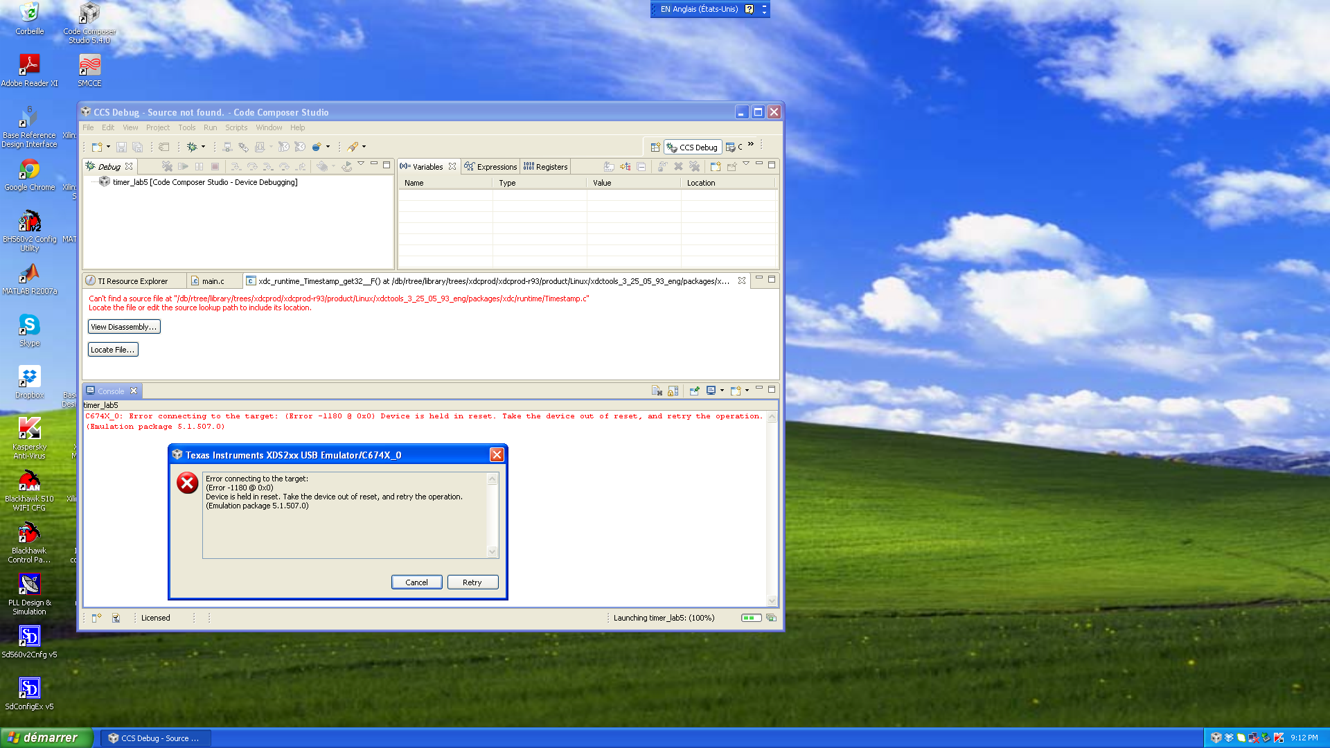

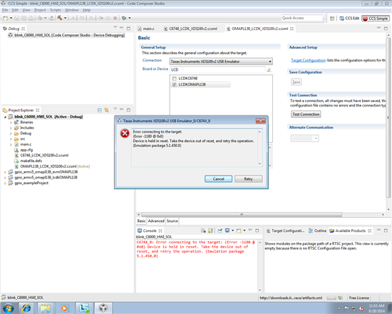

  • The above picture was taken by NAND 16 boot mode.
    If it is changed to UART (BOOTME), there is an error with XDS200 emulator:
    This PC (XP) is a little slow. Anyhow, it shouldn't be error. I have lower the clock from 10 M to 1 M, the error is still there. Thanks,
  • Hi Robert,
    Device is held in reset

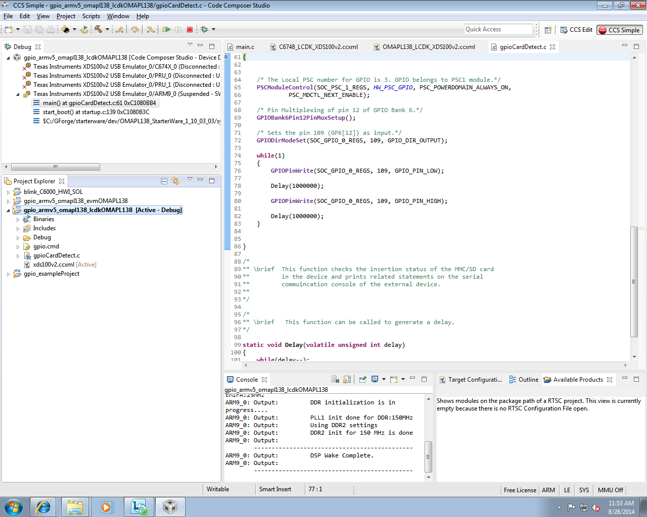

    I also faced this behavior when I run DSP project on OMAPL138 (ARM boot device).
    This issue is different, it is due to DSP is in RESET, for this , you have to run any ARM project on OMAPL138 LCDK (it will load gel file which would wakeup the DSP) board to enable DSP from reset and after that try the DSP project.

    3) If you have faced any error like "Device is held in reset" then try to run any ARM project on the OMAPL138 LCDK board to wakeup the DSP (actually it would call the OMAPL138 LCDK gel file).
    4) Quit the ARM project and run again the same  HWI example on OMAPL138 LCDK board.

  • Chris, Zhengliang,
    Please try changing the Lab 05 code to use Timer 1 instead of Timer 0, and it should work on OMAP-L138 LCDK. The board could be in a boot mode on start up and it may be using Timer 0 as soon it boots on power up. So, configuring the code to use Timer 1 and its interrupt event will work.
    Here are the two changes you need to make on the project:
    1. On app.cfg, use interrupt event id 48 instead of 64
    hwi0Params.eventId = 48;
    2. On main.c file, change the code to use Timer 1 instead of Timer 0.
    CSL_TmrRegsOvly tmr0Regs = (CSL_TmrRegsOvly)CSL_TMR_1_REGS;
    With these changes, the binary should run on both C6748 LCDK and OMAP-L138 LCDK. Also, these are the only changes to be made on Lab 06, Lab 08, Lab 09, Lab 10 to make them work on OMAP-L138 LCDK.
    I am also attaching the modified app.cfg and main.c files that the Lab 05 project uses.

    // Gpio register overlay
    CSL_GpioRegsOvly     gpioRegs = (CSL_GpioRegsOvly)(CSL_GPIO_0_REGS);
    // Timer register overlay
    CSL_TmrRegsOvly tmr1Regs = (CSL_TmrRegsOvly)CSL_TMR_1_REGS;
    // main()
    void main(void)
       hardware_init();							// init hardware via Xware
       BIOS_start();							// start BIOS Scheduler (never returns)
    // hardware_init()
        gpioPowerOn();
    // Select 32 bit unchained mode, take Timer1 out of reset
    // Set prescalar value for Timer1 3:4 to 0x1
    // to work properly even though Timer1 3:4 is being used
        tmr1Regs->TGCR = CSL_FMKT(TMR_TGCR_TIMMODE,32BIT_UNCHAIN)
    // Set timer1 PRD3:4 to ~ 1/2 second
         CSL_FINS(tmr1Regs->PRD34,TMR_PRD34_PRD34,0x7A0000);
    // Enable/Start TIMER1 3:4 - continuous mode
         CSL_FINST(tmr1Regs->TCR,TMR_TCR_ENAMODE34,EN_CONT);
    // ledToggle() ISR (called by BIOS Hwi, see app.cfg)
    void ledToggle(void)							//called by main
    	static Uint32 LED_state = 0;				// used to toggle LED state
    	if (LED_state == 1)							// if LED_state is "1" - ON, turn LED ON via GPIO
    	    CSL_FINS(gpioRegs->BANK[0].OUT_DATA,GPIO_OUT_DATA_OUT9,1);
    	else										// LED_state is "0" - OFF, turn LED OFF via GPIO
    		CSL_FINS(gpioRegs->BANK[0].OUT_DATA,GPIO_OUT_DATA_OUT9,0);
    	LED_state ^= 1;								// toggle LED state
    	// delay(8000000);								// create a delay of ~1/2sec
    	i16ToggleCount += 1;						// keep track of #toggles
    	Log_info1("LED TOGGLED [%u] times", i16ToggleCount);
    //void delay(Uint32 count)
    //    volatile Uint32 tempCount = 0;
    //    for (tempCount = 0; tempCount < count; tempCount++)
    //        /* dummy loop to wait for some time  */
    void gpioPowerOn(void)
        volatile Uint32 pscTimeoutCount = 10240u;
        Uint32 temp = 0;
    // power on GPIO module in PSC & enable GPIO module
        psc1Regs->MDCTL[CSL_PSC_GPIO] = ((psc1Regs->MDCTL[CSL_PSC_GPIO]
                                            & 0xFFFFFFE0)
                                         | CSL_PSC_MDSTAT_STATE_ENABLE);
    // Kick start the Enable command
        temp = psc1Regs->PTCMD;
        temp = ((temp & CSL_PSC_PTCMD_GO0_MASK)
                | (CSL_PSC_PTCMD_GO0_SET << CSL_PSC_PTCMD_GO0_SHIFT));
        psc1Regs->PTCMD |= temp;
    // Delay enough time for power state transition to occur (status not checked, this is the defn of HOPE)
        while (((psc1Regs->PTSTAT & (CSL_PSC_PTSTAT_GOSTAT0_IN_TRANSITION)) != 0)
            && (pscTimeoutCount>0))
            pscTimeoutCount--;
    The only other change in procedure to run the binary on OMAP-L138 LCDK (as you know before) is:
    Create a configuration file using 'LCDKOMAPL138' as the 'Board or Device', launch it, connect to the ARM first that wakes up the DSP, connect to DSP, run the binary on DSP.
    Hope this helps.
    Thanks.
    Sudhakar
