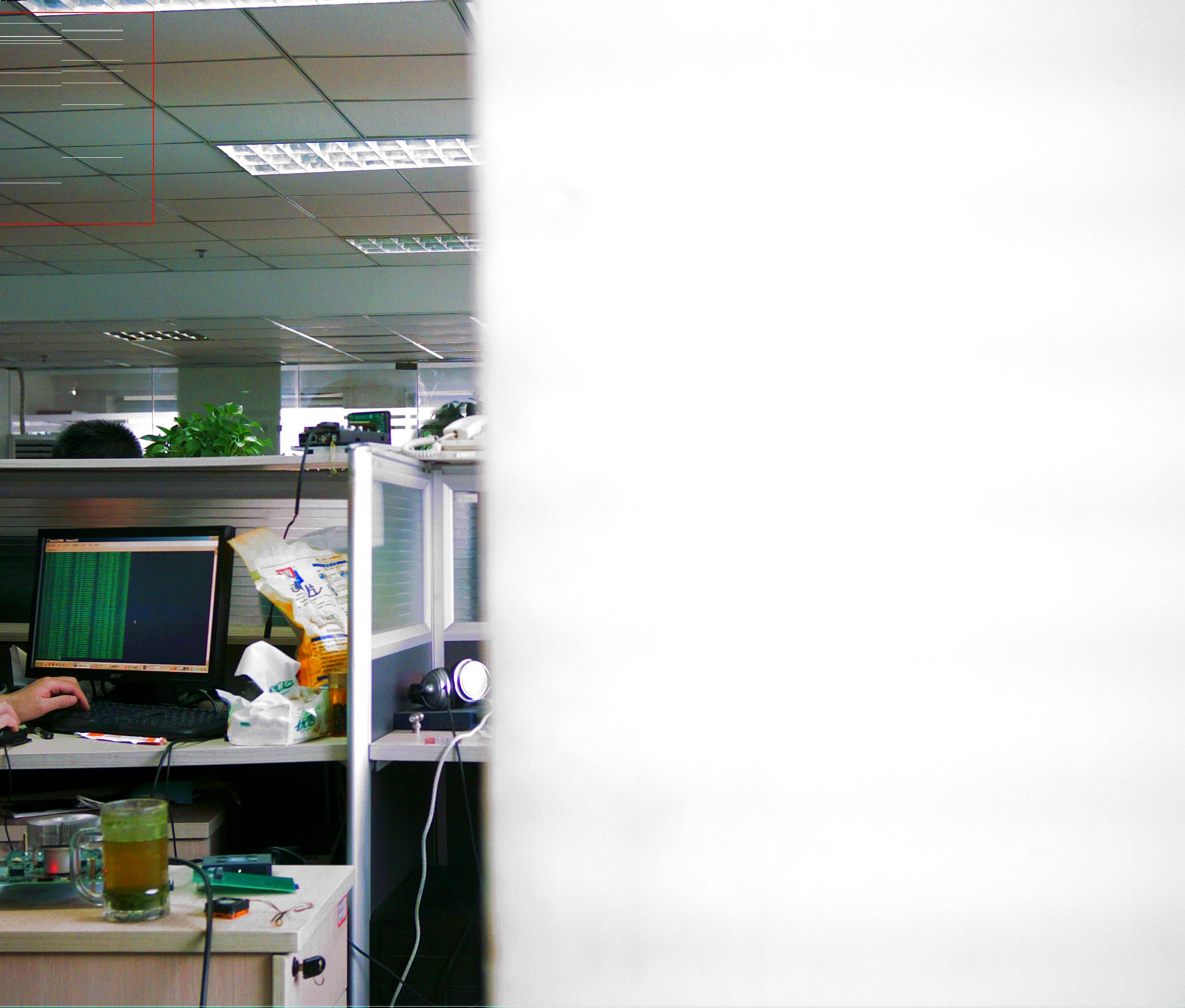

       In this condtion, I can found some white lines at the left side in both MJPEG stream and H264 stream frequently.
       I had uploaded a H264 file to show this issue. It can be playback with VLC,

  • Are you capturing in YUV420SP format ? Is your capture output in tiled format ? Can you identify the dimension of the white strip . According to your link diagram it looks like you are receiveing the frames on A8. Save the frame before applying OSD .If all the corruption are of same specific width it may give some clue.
  • Hi,Badri,
        Thanks!
        Yes, my Capture format is YUV422I 16bit, and the capture output format is YUV420SP,I had implemented OSD feature in A8 side.
    According to your suggestions, I had measured the width of the white strip, it looks like always 128 pixels.  I had uploaded three jpeg files. Can you help me to fix or workaround this issue, Thanks very much!
