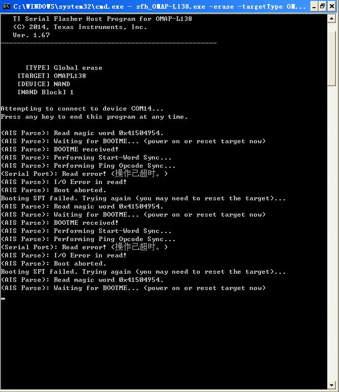

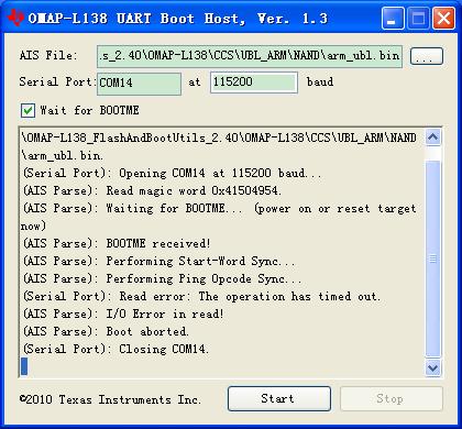

3.)I change to another board, and download with sfh_OMAP-L138.exe/UART Boot Host.exe, but it has problem too,like this:
(Serial Port): Opening COM14 at 115200 baud...
(AIS Parse): Read magic word 0x41504954.
(AIS Parse): Waiting for BOOTME... (power on or reset target now)
(AIS Parse): BOOTME received!
(AIS Parse): Performing Start-Word Sync...
(AIS Parse): Performing Ping Opcode Sync...
(Serial Port): Read error: The operation has timed out.
(AIS Parse): I/O Error in read!
(AIS Parse): Boot aborted.
(Serial Port): Closing COM14.
after this, i use serial assistant to simulate the boot protocol in "Using the OMAP-L132/L138 Bootloader" document, and i can receive "BOOTME" without problem, when i send Start-Word:0x58, i can receive 0x52 also, but when i send Ping Opcode:0x0B,0x59,0x53,0x58, there is nothing response again, so, does anyone can help me?

  • Hi Shankari,
       Many thanks for your prompt reply!
       In Cygwin environment, i "cd" to OMAPL138 folder ,and execute " make clean", "make" command, and it finished without error finally.
    I use sfh_OMAPL138 command like this:
    sfh_OMAP-L138.exe -erase -targetType OMAPL138 -flashType NAND -p COM14
    also like this:
    sfh_OMAP-L138.exe -erase  -flashType NAND -p COM14
    The error occured just at the begining of this command.
    Thank you for your answer, i'm waitting for any suggestion.
    leon

    1.  run cmd : sfh_OMAP-L138.exe -erase -targetType OMAPL138 -flashType NAND -p COM14
    2. run cmd (without -targetType) : sfh_OMAP-L138.exe -erase -flashType NAND -p COM14
    3. Use UART_Boot_Host:

  • Hi, everyone,
    The problems are solved. Because there is a loopback circuit connected to the uart on my bottom board, so it can't download while there is a same signal back to OMAPL138 always.
    I feel ashamed about it, sorry.
