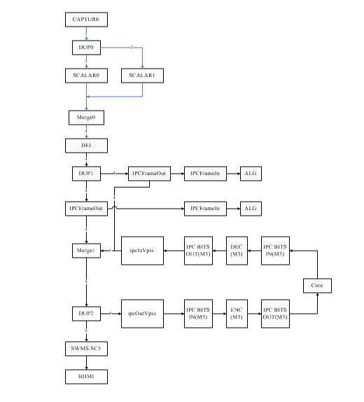

Video link error
When I add my alg unit in my video link, errors happened. It is procId
  • Pls provide details on what you added and what error you are getting. It is not clear what is the issue from your description
  • The following is my video link,
    static void Multich_ffws_connect_links()
     UInt32 i =0;
     /**Capture Link**/
     Multich_ffws_set_capture_prm(&gFFWSContext.capturePrm,2);
     gFFWSContext.capturePrm.outQueParams[0].nextLink    = gFFWSContext.dupId[0];
     MULTICH_FFWS_CREATE_LINK(gVcapModuleContext.captureId,&gFFWSContext.capturePrm,sizeof(CaptureLink_CreateParams));
     /**Dup Link 0**/
     gFFWSContext.dupPrm[0].inQueParams.prevLinkId   = gVcapModuleContext.captureId;
     gFFWSContext.dupPrm[0].inQueParams.prevLinkQueId  = 0;
     gFFWSContext.dupPrm[0].numOutQue      = 2;
     gFFWSContext.dupPrm[0].notifyNextLink     = TRUE;
     gFFWSContext.dupPrm[0].outQueParams[0].nextLink  = gVcapModuleContext.sclrId[0];
     gFFWSContext.dupPrm[0].outQueParams[1].nextLink  = gVcapModuleContext.sclrId[1];
     MULTICH_FFWS_CREATE_LINK(gFFWSContext.dupId[0],&gFFWSContext.dupPrm[0],sizeof(DupLink_CreateParams));
     /**SCALAR Link PARM INIT**/
     for(i=0; i<NUM_SCALAR_LINK; i++)
      //gFFWSContext.sclrPrm[iPrm].pathId     = SCLR_LINK_SEC0_SC3;
      gFFWSContext.sclrPrm[i].inQueParams.prevLinkId  = gFFWSContext.dupId[0];
         gFFWSContext.sclrPrm[i].inQueParams.prevLinkQueId = i;
         gFFWSContext.sclrPrm[i].outQueParams.nextLink  = gFFWSContext.mergeId[0];
      gFFWSContext.sclrPrm[i].cropEnable     = TRUE;
         gFFWSContext.sclrPrm[i].tilerEnable     = FALSE;
         gFFWSContext.sclrPrm[i].enableLineSkipSc   = FALSE;
         gFFWSContext.sclrPrm[i].inputFrameRate    = 25;
         gFFWSContext.sclrPrm[i].outputFrameRate    = 25;
         //gFFWSContext.sclrPrm[i].outDataFormat             = SYSTEM_DF_YUV420SP_UV;
         gFFWSContext.sclrPrm[i].scaleMode     = SCLR_SCALE_MODE_ABSOLUTE;
         gFFWSContext.sclrPrm[i].outScaleFactor.absoluteResolution.outWidth = 768;//1920;
         gFFWSContext.sclrPrm[i].outScaleFactor.absoluteResolution.outHeight = 576;//1080;
      MULTICH_FFWS_CREATE_LINK(gVcapModuleContext.sclrId[i],&gFFWSContext.sclrPrm[i],sizeof(SclrLink_CreateParams));
     /* MERGE 0 Link PARM INIT */
        gFFWSContext.mergePrm[0].numInQue                     = 2;
        gFFWSContext.mergePrm[0].inQueParams[0].prevLinkId    = gVcapModuleContext.sclrId[0];
        gFFWSContext.mergePrm[0].inQueParams[0].prevLinkQueId = 0;
        gFFWSContext.mergePrm[0].inQueParams[1].prevLinkId    = gVcapModuleContext.sclrId[1];
        gFFWSContext.mergePrm[0].inQueParams[1].prevLinkQueId = 0;
        //gFFWSContext.mergePrm[0].outQueParams.nextLink        = gVcapModuleContext.ipcFramesOutVpssId[0];
        gFFWSContext.mergePrm[0].outQueParams.nextLink        = gVcapModuleContext.deiId[0];
     //gFFWSContext.mergePrm[0].outQueParams.nextLink        = gVcapModuleContext.nsfId[0];
     gFFWSContext.mergePrm[0].notifyNextLink               = TRUE;
     MULTICH_FFWS_CREATE_LINK(gFFWSContext.mergeId[0],&gFFWSContext.mergePrm[0],sizeof(MergeLink_CreateParams));
    #if 1
     /** DEI HQ Link*/
     gFFWSContext.deiPrm[0].inQueParams.prevLinkId   = gFFWSContext.mergeId[0];
     gFFWSContext.deiPrm[0].inQueParams.prevLinkQueId  = 0;
     Multich_ffws_set_deiHQ_prm(&gFFWSContext.deiPrm[0]);
     gFFWSContext.deiPrm[0].outQueParams[DEI_LINK_OUT_QUE_DEI_SC].nextLink = gFFWSContext.dupId[1];
     //gFFWSContext.deiPrm[0].outQueParams[DEI_LINK_OUT_QUE_DEI_SC].nextLink = gFFWSContext.mergeId[1];
     //gFFWSContext.deiPrm[0].outQueParams[DEI_LINK_OUT_QUE_DEI_SC].nextLink = gVdisModuleContext.swMsId[0];
     //gFFWSContext.deiPrm[0].outQueParams[0].nextLink = gVcapModuleContext.ipcFramesOutVpssId[0];
     //gFFWSContext.mergePrm[1].inQueParams[1].prevLinkId  = gVcapModuleContext.deiId[0];
     //gFFWSContext.mergePrm[1].inQueParams[1].prevLinkQueId= DEI_LINK_OUT_QUE_DEI_SC;
     MULTICH_FFWS_CREATE_LINK(gVcapModuleContext.deiId[0],&gFFWSContext.deiPrm[0],sizeof(DeiLink_CreateParams));

    #if 1
     /**Dup Link 1*/
     gFFWSContext.dupPrm[1].inQueParams.prevLinkId   = gVcapModuleContext.deiId[0];
     //gFFWSContext.dupPrm[1].inQueParams.prevLinkId   = gVcapModuleContext.nsfId[0];
     gFFWSContext.dupPrm[1].inQueParams.prevLinkQueId  = 0;
     gFFWSContext.dupPrm[1].numOutQue      = 2;
     gFFWSContext.dupPrm[1].notifyNextLink     = TRUE;
     gFFWSContext.dupPrm[1].outQueParams[0].nextLink  = gVcapModuleContext.ipcFramesOutVpssId[0];
     //gFFWSContext.dupPrm[1].outQueParams[1].nextLink  = gVcapModuleContext.nsfId[0];
     gFFWSContext.dupPrm[1].outQueParams[1].nextLink  = gVcapModuleContext.ipcFramesOutVpssId[1];
     MULTICH_FFWS_CREATE_LINK(gFFWSContext.dupId[1],&gFFWSContext.dupPrm[1],sizeof(DupLink_CreateParams));
    #endif
     i=0;
     for(i=0; i<NUM_ALG_LINK; i++)
         IpcFramesInLinkRTOS_CreateParams_Init(&gFFWSContext.ipcFramesInDspPrm[i]);
         IpcFramesOutLinkRTOS_CreateParams_Init(&gFFWSContext.ipcFramesOutVpssPrm[i]);
         AlgLink_CreateParams_Init(&gFFWSContext.dspAlgPrm[i]);
     /**Ipc Frame out vpss Link 0*/
     gFFWSContext.ipcFramesOutVpssPrm[0].baseCreateParams.inQueParams.prevLinkId  = gFFWSContext.dupId[1];
     //gFFWSContext.ipcFramesOutVpssPrm[0].baseCreateParams.inQueParams.prevLinkId  = gVcapModuleContext.nsfId[0];
     gFFWSContext.ipcFramesOutVpssPrm[0].baseCreateParams.inQueParams.prevLinkQueId = 0;
     gFFWSContext.ipcFramesOutVpssPrm[0].baseCreateParams.notifyPrevLink       = TRUE;
     gFFWSContext.ipcFramesOutVpssPrm[0].baseCreateParams.numOutQue        = 1;
     //gFFWSContext.ipcFramesOutVpssPrm[0].baseCreateParams.outQueParams[0].nextLink   = gVdisModuleContext.swMsId[0];
     gFFWSContext.ipcFramesOutVpssPrm[0].baseCreateParams.outQueParams[0].nextLink   = gFFWSContext.mergeId[1];
     //gFFWSContext.ipcFramesOutVpssPrm[0].baseCreateParams.outQueParams[0].nextLink   = gFFWSContext.dupId[1];
     gFFWSContext.ipcFramesOutVpssPrm[0].baseCreateParams.notifyNextLink       = TRUE;
     gFFWSContext.ipcFramesOutVpssPrm[0].baseCreateParams.processLink       = gVcapModuleContext.ipcFramesInDspId[0];
     gFFWSContext.ipcFramesOutVpssPrm[0].baseCreateParams.notifyProcessLink    = TRUE;
     MULTICH_FFWS_CREATE_LINK(gVcapModuleContext.ipcFramesOutVpssId[0],
           &gFFWSContext.ipcFramesOutVpssPrm[0],
           sizeof(IpcFramesOutLinkRTOS_CreateParams));
     /**Ipc Frame in dsp Link 1*/
     gFFWSContext.ipcFramesInDspPrm[0].baseCreateParams.inQueParams.prevLinkId   = gVcapModuleContext.ipcFramesOutVpssId[0];
     gFFWSContext.ipcFramesInDspPrm[0].baseCreateParams.inQueParams.prevLinkQueId    = 0;
     gFFWSContext.ipcFramesInDspPrm[0].baseCreateParams.numOutQue        = 1;
     gFFWSContext.ipcFramesInDspPrm[0].baseCreateParams.outQueParams[0].nextLink     = gVcapModuleContext.dspAlgId[0];
     gFFWSContext.ipcFramesInDspPrm[0].baseCreateParams.notifyPrevLink       = TRUE;
     gFFWSContext.ipcFramesInDspPrm[0].baseCreateParams.notifyNextLink       = TRUE;
     gFFWSContext.ipcFramesInDspPrm[0].baseCreateParams.noNotifyMode        = FALSE;
     MULTICH_FFWS_CREATE_LINK(gVcapModuleContext.ipcFramesInDspId[0],
           &gFFWSContext.ipcFramesInDspPrm[0],
           sizeof(IpcFramesInLinkRTOS_CreateParams));
     /** dsp Alg0 Link*/
     gFFWSContext.dspAlgPrm[0].inQueParams.prevLinkId     = gVcapModuleContext.ipcFramesInDspId[0];
     gFFWSContext.dspAlgPrm[0].inQueParams.prevLinkQueId     = 0;
     gFFWSContext.dspAlgPrm[0].enableCYLAlg  = TRUE;
     gFFWSContext.dspAlgPrm[0].enablePANOAlg = TRUE;
     Multich_ffws_set_alg_prm(&gFFWSContext.dspAlgPrm[0]);
     gFFWSContext.dspAlgPrm[0].outQueParams[0].nextLink     = SYSTEM_LINK_ID_INVALID;
     //OSA_printf(" %s line %d gVcapModuleContext.dspAlgId[0] %p \r\n",__func__,__LINE__,gVcapModuleContext.dspAlgId[0]);
     MULTICH_FFWS_CREATE_LINK(gVcapModuleContext.dspAlgId[0],&gFFWSContext.dspAlgPrm[0],sizeof(AlgLink_CreateParams));

        gFFWSContext.ipcBitsOutHostPrm.inQueInfo.numCh                       = gVdecModuleContext.vdecConfig.numChn;
     for(i=0; i<gFFWSContext.ipcBitsOutHostPrm.inQueInfo.numCh; i++)
            gFFWSContext.ipcBitsOutHostPrm.inQueInfo.chInfo[i].width =
                gVdecModuleContext.vdecConfig.decChannelParams[i].maxVideoWidth;
            gFFWSContext.ipcBitsOutHostPrm.inQueInfo.chInfo[i].height =
                gVdecModuleContext.vdecConfig.decChannelParams[i].maxVideoHeight;
            gFFWSContext.ipcBitsOutHostPrm.inQueInfo.chInfo[i].scanFormat =
                SYSTEM_SF_PROGRESSIVE;
           //gFFWSContext.ipcBitsOutHostPrm.numBufPerCh[iPrm] = 6;
        gFFWSContext.ipcBitsInVideoPrm.baseCreateParams.inQueParams.prevLinkId    = gVdecModuleContext.ipcBitsOutHLOSId;
        gFFWSContext.ipcBitsInVideoPrm.baseCreateParams.inQueParams.prevLinkQueId = 0;
        gFFWSContext.ipcBitsInVideoPrm.baseCreateParams.outQueParams[0].nextLink  = gVdecModuleContext.decId;
        gFFWSContext.ipcBitsInVideoPrm.baseCreateParams.noNotifyMode              = TRUE;
        gFFWSContext.ipcBitsInVideoPrm.baseCreateParams.notifyNextLink            = TRUE;
        gFFWSContext.ipcBitsInVideoPrm.baseCreateParams.notifyPrevLink            = FALSE;
        gFFWSContext.ipcBitsInVideoPrm.baseCreateParams.numOutQue                 = 1;
            if(gVdecModuleContext.vdecConfig.decChannelParams[i].isCodec == VDEC_CHN_H264)
                gFFWSContext.decPrm.chCreateParams[i].format                 = IVIDEO_H264HP;
            else if(gVdecModuleContext.vdecConfig.decChannelParams[i].isCodec == VDEC_CHN_MPEG4)
                gFFWSContext.decPrm.chCreateParams[i].format                 = IVIDEO_MPEG4ASP;
            else if(gVdecModuleContext.vdecConfig.decChannelParams[i].isCodec == VDEC_CHN_MJPEG)
                gFFWSContext.decPrm.chCreateParams[i].format                 = IVIDEO_MJPEG;
            gFFWSContext.decPrm.chCreateParams[i].numBufPerCh
                             = gVdecModuleContext.vdecConfig.decChannelParams[i].numBufPerCh;
            gFFWSContext.decPrm.chCreateParams[i].profile                = IH264VDEC_PROFILE_ANY;
            gFFWSContext.decPrm.chCreateParams[i].displayDelay
                             = gVdecModuleContext.vdecConfig.decChannelParams[i].displayDelay;
            gFFWSContext.decPrm.chCreateParams[i].dpbBufSizeInFrames = IH264VDEC_DPB_NUMFRAMES_AUTO;
            gFFWSContext.decPrm.chCreateParams[i].processCallLevel   = VDEC_FRAMELEVELPROCESSCALL;
            //decPrm.chCreateParams[iPrm].processCallLevel   = VDEC_FIELDLEVELPROCESSCALL;
            gFFWSContext.decPrm.chCreateParams[i].targetMaxWidth  =
                gFFWSContext.ipcBitsOutHostPrm.inQueInfo.chInfo[i].width;
            gFFWSContext.decPrm.chCreateParams[i].targetMaxHeight =
                gFFWSContext.ipcBitsOutHostPrm.inQueInfo.chInfo[i].height;
            gFFWSContext.decPrm.chCreateParams[i].defaultDynamicParams.targetFrameRate =
                gVdecModuleContext.vdecConfig.decChannelParams[i].dynamicParam.frameRate;
            gFFWSContext.decPrm.chCreateParams[i].defaultDynamicParams.targetBitRate =
                gVdecModuleContext.vdecConfig.decChannelParams[i].dynamicParam.targetBitRate;
            gFFWSContext.decPrm.chCreateParams[i].tilerEnable = FALSE;
        gFFWSContext.decPrm.inQueParams.prevLinkId       = gVdecModuleContext.ipcBitsInRTOSId;
        gFFWSContext.decPrm.inQueParams.prevLinkQueId    = 0;
        gFFWSContext.decPrm.outQueParams.nextLink        = gFFWSContext.ipcOutVideoId;
        gFFWSContext.ipcOutVideoPrm.inQueParams.prevLinkId    = gVdecModuleContext.decId;
        gFFWSContext.ipcOutVideoPrm.inQueParams.prevLinkQueId = 0;
        gFFWSContext.ipcOutVideoPrm.outQueParams[0].nextLink  = gFFWSContext.ipcInVpssId;
        gFFWSContext.ipcOutVideoPrm.notifyNextLink            = TRUE;
        gFFWSContext.ipcOutVideoPrm.notifyPrevLink            = TRUE;
        gFFWSContext.ipcOutVideoPrm.numOutQue                 = 1;
        gFFWSContext.ipcInVpssPrm.inQueParams.prevLinkId    = gFFWSContext.ipcOutVideoId;
        gFFWSContext.ipcInVpssPrm.inQueParams.prevLinkQueId = 0;
        gFFWSContext.ipcInVpssPrm.notifyNextLink            = TRUE;
        gFFWSContext.ipcInVpssPrm.notifyPrevLink            = TRUE;
        gFFWSContext.ipcInVpssPrm.numOutQue                 = 1;
        gFFWSContext.ipcInVpssPrm.outQueParams[0].nextLink = gFFWSContext.mergeId[1];
    #endif
     /* MERGE 1 Link PARM INIT */
    #if 0
     gFFWSContext.mergePrm[1].numInQue                     = 3;
        gFFWSContext.mergePrm[1].inQueParams[0].prevLinkId    = gVcapModuleContext.ipcFramesOutVpssId[0];
        gFFWSContext.mergePrm[1].inQueParams[0].prevLinkQueId = 0;
        gFFWSContext.mergePrm[1].inQueParams[1].prevLinkId    = gVcapModuleContext.ipcFramesOutVpssId[1];
        gFFWSContext.mergePrm[1].inQueParams[1].prevLinkQueId = 0;
        gFFWSContext.mergePrm[1].inQueParams[2].prevLinkId    = gFFWSContext.ipcInVpssId;
        gFFWSContext.mergePrm[1].inQueParams[2].prevLinkQueId = 0;
    #else
     gFFWSContext.mergePrm[1].numInQue                     = 2;
        //gFFWSContext.mergePrm[1].inQueParams[0].prevLinkId    = gVcapModuleContext.deiId[0];
    #endif
     //gFFWSContext.mergePrm[1].outQueParams.nextLink        = gFFWSContext.dupId[1];
     gFFWSContext.mergePrm[1].outQueParams.nextLink        = gFFWSContext.dupId[2];
     //gFFWSContext.mergePrm[1].outQueParams.nextLink        = gVdisModuleContext.swMsId[0];
     gFFWSContext.mergePrm[1].notifyNextLink               = TRUE;
     MULTICH_FFWS_CREATE_LINK(gFFWSContext.mergeId[1],&gFFWSContext.mergePrm[1],sizeof(MergeLink_CreateParams));
    #if 1
     /**Dup Link 2*/
     gFFWSContext.dupPrm[2].inQueParams.prevLinkId   = gFFWSContext.mergeId[1];
     gFFWSContext.dupPrm[2].inQueParams.prevLinkQueId  = 0;
     gFFWSContext.dupPrm[2].numOutQue      = 2;
     gFFWSContext.dupPrm[2].notifyNextLink     = TRUE;
     gFFWSContext.dupPrm[2].outQueParams[0].nextLink  = gVdisModuleContext.swMsId[0];
     gFFWSContext.dupPrm[2].outQueParams[1].nextLink  = gVcapModuleContext.nsfId[0];
     //gFFWSContext.dupPrm[2].outQueParams[1].nextLink  = gFFWSContext.ipcOutVpssId;
     MULTICH_FFWS_CREATE_LINK(gFFWSContext.dupId[2],&gFFWSContext.dupPrm[2],sizeof(DupLink_CreateParams));
    #else
     /**Dup Link 2*/
     gFFWSContext.dupPrm[1].inQueParams.prevLinkId   = gVcapModuleContext.ipcFramesOutVpssId[0];
     gFFWSContext.dupPrm[1].outQueParams[0].nextLink  = gVdisModuleContext.swMsId[0];
     gFFWSContext.dupPrm[1].outQueParams[1].nextLink  = gFFWSContext.ipcOutVpssId;
    #endif
     /**SW+Display */
     //gFFWSContext.swMsPrm[0].inQueParams.prevLinkId  = gFFWSContext.dupId[1];
     //gFFWSContext.swMsPrm[0].inQueParams.prevLinkId   = gVcapModuleContext.ipcFramesOutVpssId[0];//gVcapModuleContext.deiId[0];
     //gFFWSContext.swMsPrm[0].inQueParams.prevLinkId   = gFFWSContext.mergeId[1];
     gFFWSContext.swMsPrm[0].inQueParams.prevLinkId  = gFFWSContext.dupId[2];
     gFFWSContext.swMsPrm[0].inQueParams.prevLinkQueId  = 0;
     for( i = 0; i < 1; i++ )
      SwMsLink_CreateParams * swMsPrm   = &gFFWSContext.swMsPrm[i];
      DisplayLink_CreateParams * displayPrm  = &gFFWSContext.displayPrm[i];
      UInt32 resolution = gVdisModuleContext.vdisConfig.deviceParams[i].resolution;
      UInt32 enableLayoutGridDraw = gVdisModuleContext.vdisConfig.enableLayoutGridDraw;
      Multich_ffws_set_display_prm(swMsPrm, displayPrm, resolution, enableLayoutGridDraw);
      swMsPrm->outQueParams.nextLink = gVdisModuleContext.displayId[i];
      displayPrm->inQueParams[0].prevLinkId  = gVdisModuleContext.swMsId[i];
      displayPrm->inQueParams[0].prevLinkQueId = 0;
      MULTICH_FFWS_CREATE_LINK(gVdisModuleContext.swMsId[i],swMsPrm,sizeof(SwMsLink_CreateParams));
      MULTICH_FFWS_CREATE_LINK(gVdisModuleContext.displayId[i],displayPrm,sizeof(DisplayLink_CreateParams));
    #if 1
     /* NSF Link PARM INIT */
        MULTICH_INIT_STRUCT(NsfLink_CreateParams,gFFWSContext.nsfPrm);
        gFFWSContext.nsfPrm.bypassNsf                   = FALSE;
        gFFWSContext.nsfPrm.tilerEnable                 = FALSE;
        gFFWSContext.nsfPrm.inQueParams.prevLinkId      = gFFWSContext.dupId[2];
        gFFWSContext.nsfPrm.inQueParams.prevLinkQueId   = 0;
        gFFWSContext.nsfPrm.numOutQue                   = 1;
        gFFWSContext.nsfPrm.outQueParams[0].nextLink    = gFFWSContext.ipcOutVpssId;
        //gFFWSContext.nsfPrm.outQueParams[0].nextLink    = gVcapModuleContext.ipcFramesOutVpssId[0];
     MULTICH_FFWS_CREATE_LINK(gVcapModuleContext.nsfId[0],&gFFWSContext.nsfPrm,sizeof(NsfLink_CreateParams));
     /** IPC VPSS OUT Link*/
     //gFFWSContext.ipcOutVpssPrm.inQueParams.prevLinkId  = gFFWSContext.mergeId[1];
     gFFWSContext.ipcOutVpssPrm.inQueParams.prevLinkId   = gVcapModuleContext.nsfId[0];
     //gFFWSContext.ipcOutVpssPrm.inQueParams.prevLinkId   = gFFWSContext.dupId[2];
     gFFWSContext.ipcOutVpssPrm.inQueParams.prevLinkQueId = 1;
     gFFWSContext.ipcOutVpssPrm.numOutQue     = 1;
     gFFWSContext.ipcOutVpssPrm.outQueParams[0].nextLink  = gFFWSContext.ipcInVideoId;
     gFFWSContext.ipcOutVpssPrm.notifyNextLink       = FALSE;
     gFFWSContext.ipcOutVpssPrm.notifyPrevLink       = TRUE;
     gFFWSContext.ipcOutVpssPrm.noNotifyMode        = TRUE;
     MULTICH_FFWS_CREATE_LINK(gFFWSContext.ipcOutVpssId, &gFFWSContext.ipcOutVpssPrm, sizeof(IpcLink_CreateParams ));
     /**IPC IN VIDEO Link*/
     gFFWSContext.ipcInVideoPrm.inQueParams.prevLinkId     = gFFWSContext.ipcOutVpssId;
     gFFWSContext.ipcInVideoPrm.inQueParams.prevLinkQueId = 0;
     gFFWSContext.ipcInVideoPrm.numOutQue     = 1;
     gFFWSContext.ipcInVideoPrm.outQueParams[0].nextLink     = gVencModuleContext.encId;
     gFFWSContext.ipcInVideoPrm.notifyNextLink       = TRUE;
     gFFWSContext.ipcInVideoPrm.notifyPrevLink       = FALSE;
     gFFWSContext.ipcInVideoPrm.noNotifyMode        = TRUE;
     MULTICH_FFWS_CREATE_LINK(gFFWSContext.ipcInVideoId, &gFFWSContext.ipcInVideoPrm, sizeof(IpcLink_CreateParams ) );
     /**ENC Link */
     gFFWSContext.encPrm.inQueParams.prevLinkId       = gFFWSContext.ipcInVideoId;
     gFFWSContext.encPrm.inQueParams.prevLinkQueId     = 0;
     Multich_ffws_set_enclink_prm(&gFFWSContext.encPrm);
     gFFWSContext.encPrm.outQueParams.nextLink       = gVencModuleContext.ipcBitsOutRTOSId;
     MULTICH_FFWS_CREATE_LINK(gVencModuleContext.encId,  &gFFWSContext.encPrm, sizeof( EncLink_CreateParams ));
     /**IPC BITS OUT VIDEO Link */
     gFFWSContext.ipcBitsOutVideoPrm.baseCreateParams.inQueParams.prevLinkId     = gVencModuleContext.encId;
     gFFWSContext.ipcBitsOutVideoPrm.baseCreateParams.inQueParams.prevLinkQueId  = 0;
     gFFWSContext.ipcBitsOutVideoPrm.baseCreateParams.numOutQue        = 1;
     gFFWSContext.ipcBitsOutVideoPrm.baseCreateParams.outQueParams[0].nextLink   = gVencModuleContext.ipcBitsInHLOSId;
     MultiCh_ipcBitsInitCreateParams_BitsOutRTOS( &gFFWSContext.ipcBitsOutVideoPrm, TRUE );
     MULTICH_FFWS_CREATE_LINK(gVencModuleContext.ipcBitsOutRTOSId, &gFFWSContext.ipcBitsOutVideoPrm, sizeof( IpcBitsOutLinkRTOS_CreateParams ));
     /**IPC BITS IN HOST Link */
     gFFWSContext.ipcBitsInHostPrm.baseCreateParams.inQueParams.prevLinkId  = gVencModuleContext.ipcBitsOutRTOSId;
     gFFWSContext.ipcBitsInHostPrm.baseCreateParams.inQueParams.prevLinkQueId  = 0;
     gFFWSContext.ipcBitsInHostPrm.baseCreateParams.numOutQue        = 1;
     gFFWSContext.ipcBitsInHostPrm.baseCreateParams.outQueParams[0].nextLink   = SYSTEM_LINK_ID_INVALID;
     MultiCh_ipcBitsInitCreateParams_BitsInHLOS( &gFFWSContext.ipcBitsInHostPrm );
     MULTICH_FFWS_CREATE_LINK(gVencModuleContext.ipcBitsInHLOSId,  &gFFWSContext.ipcBitsInHostPrm, sizeof( IpcBitsInLinkHLOS_CreateParams));
    #endif
    The following is error.
    1771:!!!SLAVE CORE [VIDEO-M3] DOWN!!!
    SystemLink_copySlaveCoreExceptionContext:120
    mmap of [0xbe000000:36864]
    mmap virt addresss:0x40104000
    munmap of [0x40104000:36864]
    SystemLink_copySlaveCoreExceptionContext:127
     [m3video]  8072: IPC_IN_M3   : Create in progress !!!
     [m3vpss ]    7 |   7 |    0,    0 |   352 x    264 |   704 /   704 | NON-TILED   |  640,  864 |   640 x    216 |  3840 /      0 | NON-TILED   |       ON |    0 |  422|
     [m3video]  8072: SYSTEM: Opening ListMP [VPSS-M3_IPC_OUT_0] ...
     [m3vpss ]    8 |   8 |    0,    0 |   352 x    264 |   704 /   704 | NON-TILED   | 1280,  864 |   640 x    216 |  3840 /      0 | NON-TILED   |       ON |    0 |  422|
     [m3video]  8072: SYSTEM: Opening ListMP [VPSS-M3_IPC_IN_0] ...
     [m3vpss ]
     [m3video]  8074: IPC_IN_M3   : Create Done !!!
     [m3video]  8095: ENCODE: Create in progress ... !!!
     [m3video] ENCODE: inQueInfo.numCh 4!!!
     [m3vpss ] SWMS:HEAPID:0        USED:360
     [m3video]  8149: ENCODE: Creating CH0 of 768 x 576, pitch = (1536, 1536) [PROGRESSIVE] [NON-TILED  ], bitrate = 0 Kbps ...
     [m3vpss ] SWMS:HEAPID:1        USED:43776
     [m3video]  8149: Assertion @ Line: 750 in links_m3video/iva_enc/encLink_common.c: pChAlgCreatePrm->inputChromaFormat == XDM_YUV_420SP : failed !!!
     [m3vpss ] SWMS:HEAPID:4        USED:20736000
     [m3vpss ]  8009: SWMS: Create Done !!!
    1484:!!!SLAVE CORE [VPSS-M3] DOWN!!!
    mmap of [0xbe020000:36864]
    mmap virt addresss:0x40150000
    munmap of [0x40150000:36864]
     [c6xdsp ] ALGLINK:HEAPID:0     USED:3321280
     [m3vpss ]  5682: Assertion @ Line: 56 in links_common/merge/mergeLink_tsk.c: pPrm->inQueParams[inQue].prevLinkQueId < pObj->inTskInfo[inQue].numQue : failed !!!
     [c6xdsp ] ALGLINK:HEAPID:1     USED:107544
     [c6xdsp ]  5010: ALG : Create Done !!!
     [c6xdsp ]  5054: IPC_FRAMES_IN   : Create in progress !!!
     [c6xdsp ]  5054: SYSTEM: Opening ListMP [VPSS-M3_IPC_OUT_20] ...
     [c6xdsp ]  5054: SYSTEM: Opening ListMP [VPSS-M3_IPC_IN_20] ...
     [c6xdsp ] IPC_FRAMES_IN:HEAPID:0       USED:304
     [c6xdsp ]  5055: IPC_FRAMES_IN   : Create Done !!!
     [c6xdsp ]  5076: ALG : Create in progress !!!
     [c6xdsp ]  5081: ALG : Create Done !!!
    The following is a test link.

     /**Dup Link 0**/
     gFFWSContext.dupPrm[0].outQueParams[0].nextLink  = gVdisModuleContext.swMsId[0];
     gFFWSContext.dupPrm[0].outQueParams[1].nextLink  = gFFWSContext.ipcOutVpssId;
     /**SW+Display */
     gFFWSContext.swMsPrm[0].inQueParams.prevLinkId  = gFFWSContext.dupId[0];
    #if 1
     gFFWSContext.ipcOutVpssPrm.inQueParams.prevLinkId  = gFFWSContext.dupId[0];
     /**ENC Link */
    #endif

    When I modified my link, error still exist. The following is my link.
     UInt32 i =0;
     /**Capture Link**/
     /**Dup Link 0**/
    #if 1
     /** DEI HQ Link*/
    #endif
    #if 0
        gFFWSContext.nsfPrm.inQueParams.prevLinkId      = gFFWSContext.mergeId[0];
        gFFWSContext.nsfPrm.outQueParams[0].nextLink    = gFFWSContext.dupId[1];
    #endif
    #if 1
     /**Dup Link 1*/
    #endif
     i=0;
     /** dsp Alg0 Link*/
    #if 1
     /**Ipc Frame out vpss Link 1*/
     gFFWSContext.ipcFramesOutVpssPrm[1].baseCreateParams.inQueParams.prevLinkId  = gFFWSContext.dupId[1];
     //gFFWSContext.ipcFramesOutVpssPrm[1].baseCreateParams.inQueParams.prevLinkId  = gVcapModuleContext.nsfId[0];
     gFFWSContext.ipcFramesOutVpssPrm[1].baseCreateParams.inQueParams.prevLinkQueId = 1;
     gFFWSContext.ipcFramesOutVpssPrm[1].baseCreateParams.notifyPrevLink       = TRUE;
     gFFWSContext.ipcFramesOutVpssPrm[1].baseCreateParams.numOutQue        = 1;
     gFFWSContext.ipcFramesOutVpssPrm[1].baseCreateParams.outQueParams[0].nextLink   = gFFWSContext.mergeId[1];
     gFFWSContext.ipcFramesOutVpssPrm[1].baseCreateParams.notifyNextLink       = TRUE;
     gFFWSContext.ipcFramesOutVpssPrm[1].baseCreateParams.processLink       = gVcapModuleContext.ipcFramesInDspId[1];
     gFFWSContext.ipcFramesOutVpssPrm[1].baseCreateParams.notifyProcessLink    = TRUE;
       MULTICH_FFWS_CREATE_LINK(gVcapModuleContext.ipcFramesOutVpssId[1],
           &gFFWSContext.ipcFramesOutVpssPrm[1],
     /**Ipc Frame in dsp Link 1 */
     //gFFWSContext.selectPrms.inQueParams.prevLinkId = gVcapModuleContext.ipcFramesOutVpssId[1];
     //gFFWSContext.selectPrms.inQueParams.prevLinkQueId = 0;
     gFFWSContext.ipcFramesInDspPrm[1].baseCreateParams.inQueParams.prevLinkId   = gVcapModuleContext.ipcFramesOutVpssId[1];
     gFFWSContext.ipcFramesInDspPrm[1].baseCreateParams.inQueParams.prevLinkQueId    = 0;
     gFFWSContext.ipcFramesInDspPrm[1].baseCreateParams.numOutQue        = 1;
     gFFWSContext.ipcFramesInDspPrm[1].baseCreateParams.outQueParams[0].nextLink     = gVcapModuleContext.dspAlgId[1];
     gFFWSContext.ipcFramesInDspPrm[1].baseCreateParams.notifyPrevLink       = TRUE;
     gFFWSContext.ipcFramesInDspPrm[1].baseCreateParams.notifyNextLink       = TRUE;
     gFFWSContext.ipcFramesInDspPrm[1].baseCreateParams.noNotifyMode        = FALSE;
     MULTICH_FFWS_CREATE_LINK(gVcapModuleContext.ipcFramesInDspId[1],
           &gFFWSContext.ipcFramesInDspPrm[1],
     /** dsp Alg Link 1 */
     gFFWSContext.dspAlgPrm[1].inQueParams.prevLinkId     = gVcapModuleContext.ipcFramesInDspId[1];
     gFFWSContext.dspAlgPrm[1].inQueParams.prevLinkQueId     = 0;
     //gFFWSContext.dspAlgPrm[1].enableCYLAlg = TRUE;
     //gFFWSContext.dspAlgPrm[1].enablePANOAlg = TRUE;
     //Multich_ffws_set_alg_prm(&gFFWSContext.dspAlgPrm[1]);
     gFFWSContext.dspAlgPrm[1].outQueParams[1].nextLink     = SYSTEM_LINK_ID_INVALID;
     MULTICH_FFWS_CREATE_LINK(gVcapModuleContext.dspAlgId[1],&gFFWSContext.dspAlgPrm[1],sizeof(AlgLink_CreateParams));
    #endif
    #if 0
     /* IPC_BITS_HOSTTOVIDEO Link PARM INIT */
        gFFWSContext.ipcBitsOutHostPrm.baseCreateParams.outQueParams[0].nextLink = gVdecModuleContext.ipcBitsInRTOSId;
        gFFWSContext.ipcBitsOutHostPrm.baseCreateParams.notifyNextLink       = FALSE;
        gFFWSContext.ipcBitsOutHostPrm.baseCreateParams.notifyPrevLink       = FALSE;
        gFFWSContext.ipcBitsOutHostPrm.baseCreateParams.noNotifyMode         = TRUE;
        gFFWSContext.ipcBitsOutHostPrm.baseCreateParams.numOutQue            = 1;
    #endif
    #if 0
    #else
    #endif

    #if 1
     /**Dup Link 2*/
    #else
     /**Dup Link 2*/
    #endif
     /**SW+Display */
    #if 1
     /**ENC Link */
    #endif
  • Error information
    [m3vpss ]
    the following is my video link and code.
    UInt32 i =0;
    /**Capture Link**/
    /**Dup Link 0**/
    //gFFWSContext.mergePrm[0].outQueParams.nextLink = gVcapModuleContext.deiId[0];
    #if 0
    /** DEI HQ Link*/
    #endif
    #if 1
    #endif
    #if 1
    /**Dup Link 1*/
    //gFFWSContext.dupPrm[1].inQueParams.prevLinkId = gVcapModuleContext.deiId[0];
    #endif
    i=0;
    /** dsp Alg0 Link*/
    #if 1
    #endif
    #if 0
    #endif
    #if 0
    #else
    #endif
    #if 1
    /**Dup Link 2*/
    #else
    /**Dup Link 2*/
    #endif
    /**SW+Display */
    #if 1
    //gFFWSContext.ipcOutVpssPrm.inQueParams.prevLinkId = gFFWSContext.dupId[1];

  • Encoder requires input in YUV420SP format but you have DEI DEI_SC output connected to encoder which will be YUV422I format. You will have to connect NSF to output of DEI_SC to convert to YUV420SP format.
