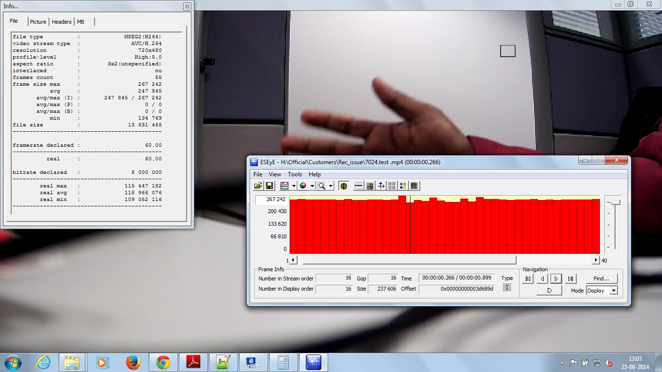

  • After digging  ipnc_app a little, I was able to deque encoded  frames from AV Server  using GetAVData() method.
    (See APPROInput.c)
    But , it looks all the frames are IDR frames , and only the first two frames are decodable. See attached  stream.

    But the frame size suggests  there  are  indeed P frames in it. See below

  • Hi JK,
    I verified 'test.mp4' in Elecard stream eye tool and found that all the frames are I frames and are decodable. Pl. see the attached snapshot.
    Your log shows both I and P frames are written to the file 'test.h264'.
    So have you done any conversion from test.h264 to test.mp4??
    Can you share the original test.h264 file?
    regards,
    Anand
  • Hi Anand
    Thanks.The stream (test.mp4) is in fact a .264 stream only. I could not upload file with .264 ext, so I simply changed the
    extension to .mp4.
    The frame size shows it is indeed I and P frames. I am now able to get frames as I & P frames by making the following modification.
     if( fwrite( av_data.ptr+start,fFrameSize,1, pfd )  <= 0)
                                 to
     if( fwrite( av_data.ptr,fFrameSize,1, pfd )  <= 0)
    Now I am able to stream using my custom server and play live streams in mplayer. Got few questions.

    I wanted to have SPS and PPS in the beginning of sequence only.
    Pls answer.
    Best Regards
    JK

  • Hi Anand,
    Thanks.
    'AV_OP_LOCK_MP4_IFRAME' gave an I frame instead of IDR frame.
    Pls find the attached frame, which is downloaded from AV server using 'AV_OP_LOCK_MP4_IFRAME' cmd.
    (file ext changed to mp4)
    GetAVData(AV_OP_LOCK_MP4_IFRAME,-1,&av_data);
    Request you to check this.
    Best Regards
    JK
