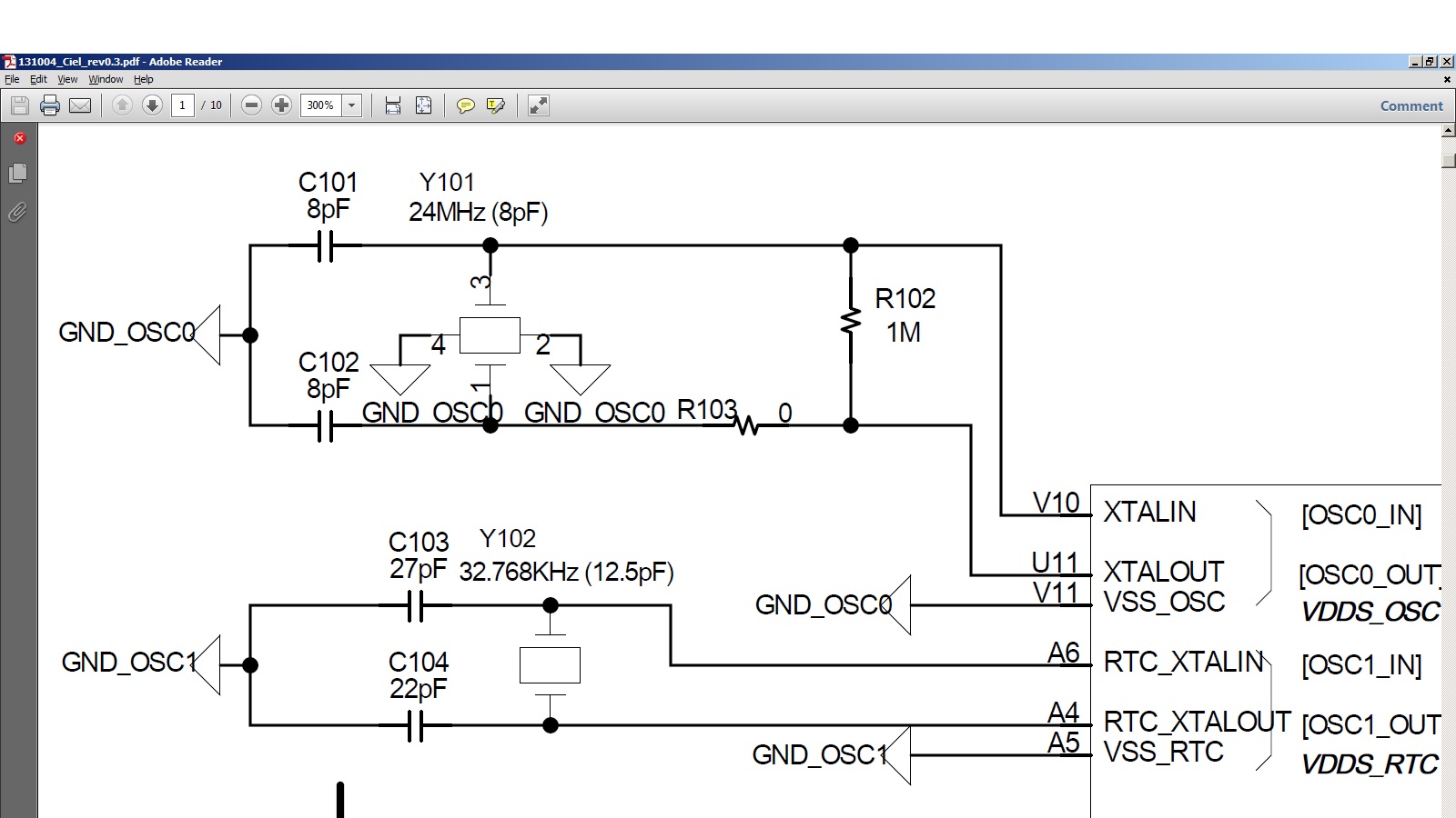

We have an AM3352 custom board which uses ezSDK v5.07.
BTW, error messages are sometimes printed when we repeat power on/off on single board.
Of course, it normaly boots-up in many cases but sometimes we see the abnormal booting.
From boot-up log, we can see some differences.
<abnormal case>
[    0.000000] OMAP clockevent source: GPTIMER2 at 24000000 Hz
[    0.000000] omap_dm_timer_switch_src: Switching to HW default clocksource(sys_clkin_ck) for timer1, this may impact timekeeping in low power state
[    0.000000] OMAP clocksource: GPTIMER1 at 24000000 Hz
[    0.000000] sched_clock: 32 bits at 24MHz, resolution 41ns, wraps every 178956ms
<normal case>
[    0.000000] OMAP clocksource: GPTIMER1 at 32768 Hz
[    0.000000] sched_clock: 32 bits at 32kHz, resolution 30517ns, wraps every 131071999ms

The timer_switch_src function is called at timer.c in /arch/arm/mach-omap2. But I don't know well why this function is called.
Please give me any comments.
Devin
