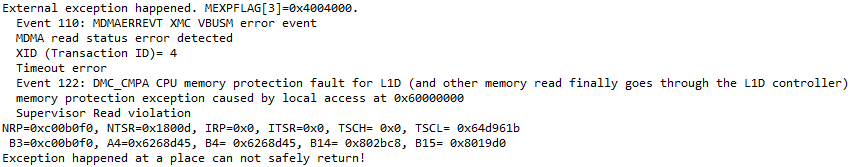

        The appendixis my project,   now  I read from address 0x60400000, the DSP core produce a MDMA bus error and a DSP memory protection fault.  I think it seems like the XMC has a incorrect configuration.
    5226.TestPCIe.rar
  • This is the screenshot when reading from address 0x60400000

    I did some tests further, when I read frome 0x60000000, the value of PCIE_UNCERR changed to 0x4000 and the PCIE_CERR changed to 0x2000, So I think it seems like that a PCIe cpmpletion timeout error cuase the MDMA timeout error interrupt, and I'm not sure this cause a memory protection fault further;  But I set the DEV_STAT_CTRL2 to 0x00000000, that means the completion timeout value is 50 s to 50 ms, and I observed the interval between FPGA received request packet and sent completion packet is 80 ~ 100ns.
    Now I really do not know what the problem is.  Thanks for your reply.
