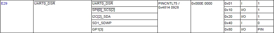

I want to use SDWP(E29) and SDCD(G28) to do SD card detect.
After I define wp and cd pin, and add pin mux setting in "board-ti8107dvr.c", sd card have been detected, but the card is read-only.

E29 and G28 pin are configured to SD1_SDWP and SD1_SDCD.
root@dm810x:~# devmem2 0x4814093c
/dev/mem opened.
Memory mapped at address 0x40173000.
Read at address 0x4814093C (0x4017393c): 0x00060002
root@dm810x:~# devmem2 0x48140928
/dev/mem opened.
Memory mapped at address 0x4016d000.
Read at address 0x48140928 (0x4016d928): 0x00060040
