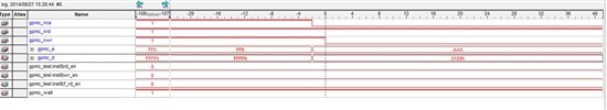

         i want use gpmc on am335x to comunicate with a fapa (Asynchronous,16bits,no multple,signal read and write),but there are  some problems,i  only can write once.then the cs and wr signal will keep on 1.
i set the gpmc_configs as blow:
#define STNOR_GPMC_CONFIG1 0x00251000
#define STNOR_GPMC_CONFIG2 0x00060601
#define STNOR_GPMC_CONFIG3 0x00000000
#define STNOR_GPMC_CONFIG4 0x06020602
#define STNOR_GPMC_CONFIG5 0x00050707
#define STNOR_GPMC_CONFIG6 0x04000000
i have used devmem2 to check the regs they have been seted  as what has show upon;
