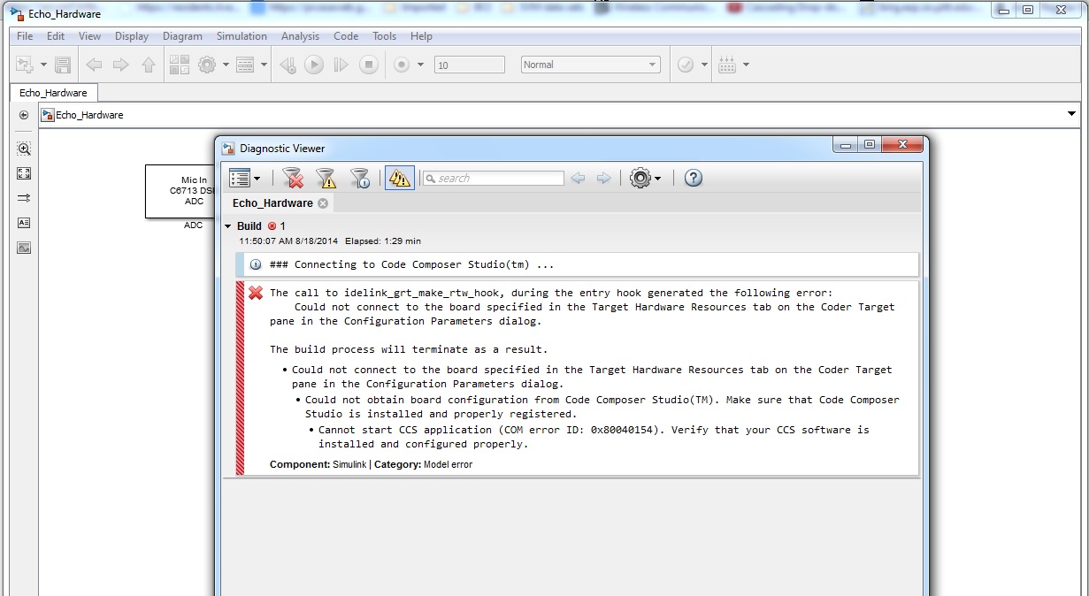

Hi there,
This semester we have to work with CCS5 and Matlab 2014a for C6713 board in Windows 7.
I am working on Echo_control project from the book "Digital Signal Processing and Applications with the C6713 and C6416 DSK".
I have created the simulation model in Matlab as shown below
I have changed the simulation configuration parameters as required. But I got the following error as shown below,
Please help me.
Thanks and Regards,
Vanitha

  • Hi Stalin ,
    As you can see I have attached my simulink model in the post, I am reposting it below,
    I am working with CCS5 and Matlab 2014a for C6713 board on Windows7.
    I was able to integrate matlab and CCS5 using this xmakefilesetup which is shown below,
    After this setup, I got the following error,
    It says that couldnot open CSL_cache.h file. But I can't understand how to link this particular file in Matlab.
    Please help me.
    Vanitha
  • Hi Vanitha,
    As Shankari mentioned at the below thread.
    http://e2e.ti.com/support/dsp/tms320c6000_high_performance_dsps/f/115/t/362709.aspx
    You have issues with building the "echo control" project so, first try to build and run through CCS alone and then go with integration of other stuffs.
    You surely would get the "could not open CSL_cache.h file." error when you build the "echo control" CCS project on CCS,
    While you building the CCS project, you have to provide the libraries and include path as per your project location,
