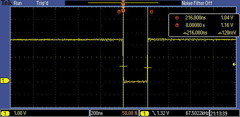

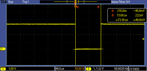

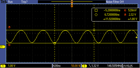

  • Here are my signals:
    Hsync
    Vsync
    Clock

  • Hi _Ralph_,
    The HSYNC/VSYNC method will capture the entire line, this includes the horizontal blanking pixels and vertical blanking lines.
    My video input is 1080p60, so 1920x1080 but with blanking this is 2200x1125 which exceeds the 11bits (2048).
    With DE/ACTVID interface only the vertical ancillary data (vertical blanking data) can be captured. By default you'd only get active video, i.e. 1920x1080 pixels.
    Only in Hsync/Vsync mode the blanking information in H & V blanking is captured (says the documentation) as it captures all the pixels. With my H blanking: too much (for 11 bits)
    I haven't wired DE, but it looks like H/Vsync will only work if a line + blanking is less or equal 2048 pixels.
