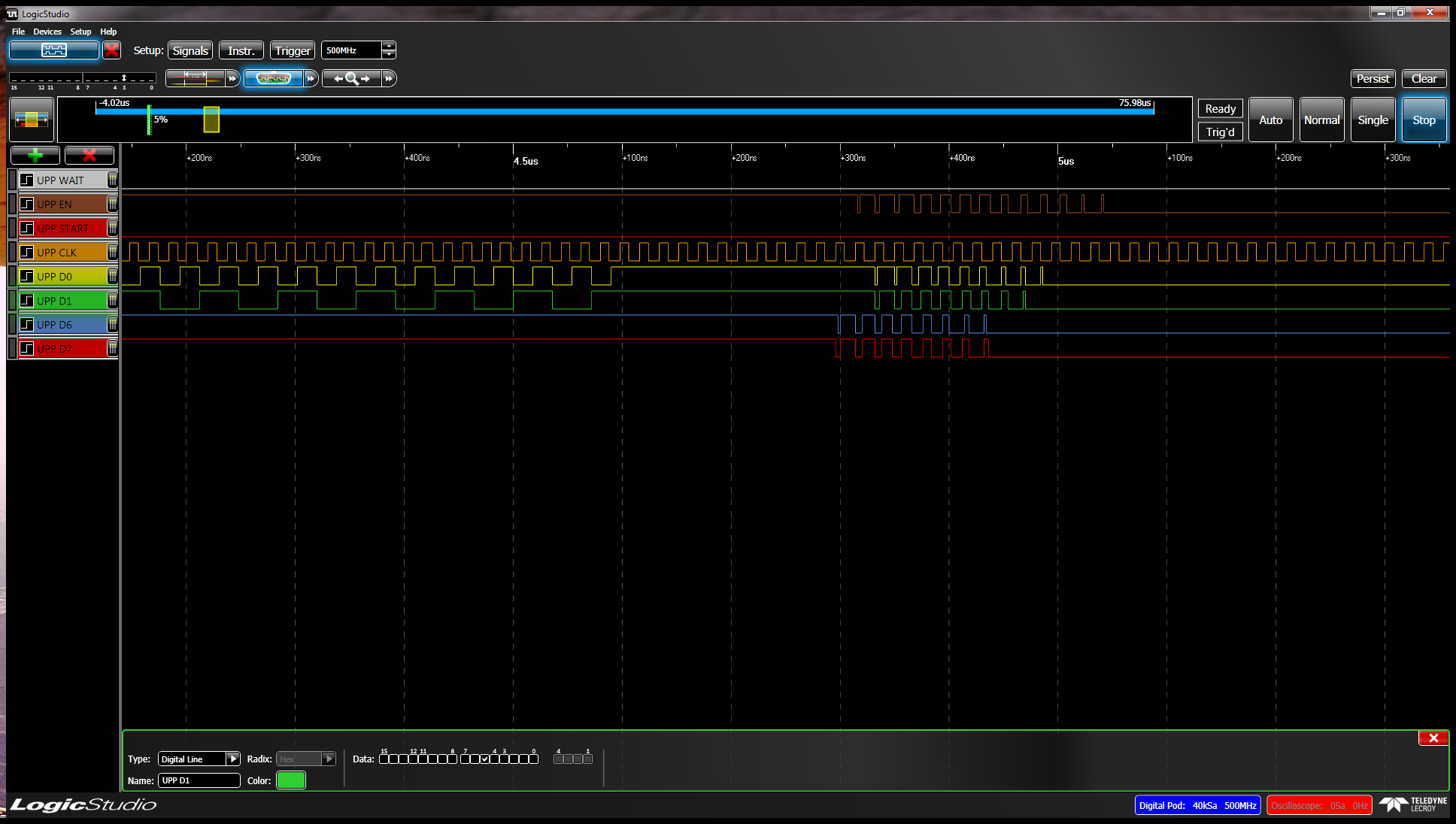

  • We setup a loopback test on the EVM6657.  The setup for the UPP lookback is  bytecount = 256, linecount = 2 . The UPP data increments by 1  every 16bit word-- Upp D0 toggles every UPP clock.  The attached trace shows the transfer of the data.  UPP D1 toggles 32 times for each UPP START pulse.  You can see the UPP EN does not go low right after the 32nd toggle of D1 in the 2nd line transferred, it actually stays high for a number of extra clocks.  We followed the procedure listed in 2.6.1 in the uPP User Guide.  The second attachment is a zoomed in look at the end of the transfer.

  • Hi Dave,
    The trailing clocks are unexpected. Have you captured the rising and falling edges of the enable signal with an oscilloscope? I want to see if these are distinct clock pulses or something caused by some ringing on the signal.
    Regards, Bill
  • Bill
    Here is a scope trace of the UPP signals.  This is using the same program as the previous posts, so D0 is toggled every clock.  You can see from the trace that the Enable signal is high through out the transfer (the attached snapshot is of the end where you saw the multiple transitions on the logic analyzer trace from the previous post).  It appears the DSP is tristating the Enable and D0 lines at the end of the transfer, that is probably why the logic analyzer is seeing the toggles.  Can you verify that the bus is tristated when the transfer is completed?  I did not see this in the data sheet.
    upp signals.pdf
  • Hi Dave,
    It looks like you've configured the channels to be in a high impedance state when idle. If you set UPICR.TRISB bit to 0 then the channel will not tristate after the enable is released. You will have to set a default value for the data bits using the UPIVR.VALB bits.
    Regards, Bill
  • Bill
    That solves our problem, missed that in the data sheet.  Thanks for the help.
