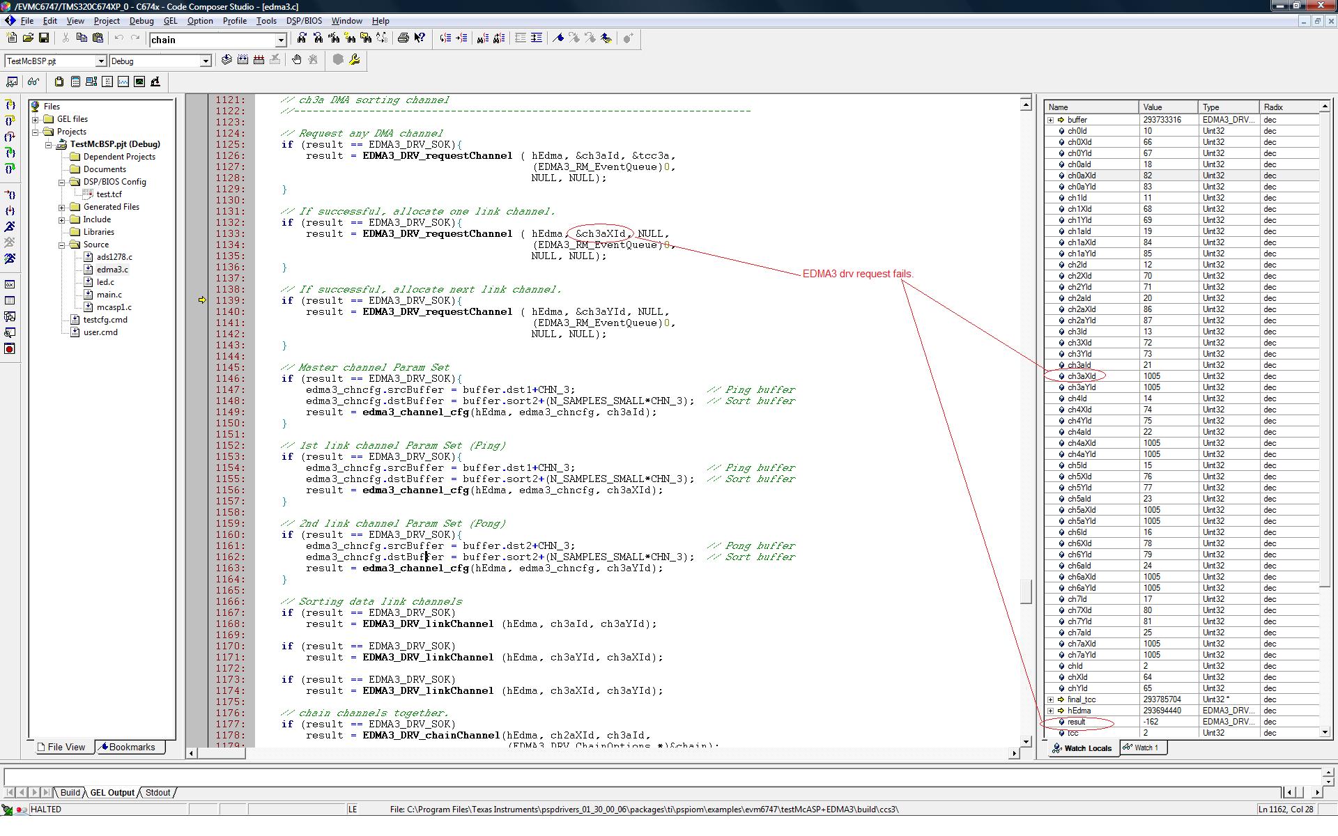

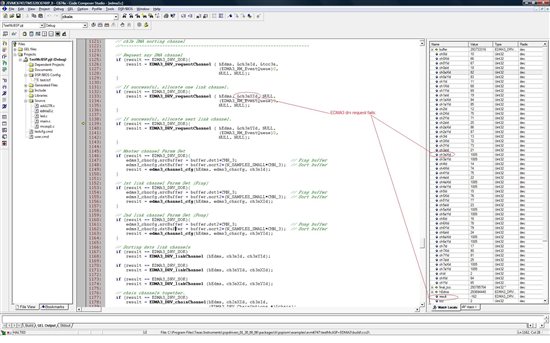

After requesting the 24th channel for link, EDMA3_DRV_requestChannel function returns -162
What could be wrong whit this? I use C6747 platform and edma3_lld_01_11_00_03 version

    There could be issues with the default allocation of PaRAM sets for your code to "own", or with shadow regions, or you have simply run out of PaRAM sets to use.

    EDMA3_RM_E_ALL_RES_NOT_AVAILABLE with the comment /** No Resource of specified type is available */. So this is the error response from your call to EDMA3_DRV_requestChannel, saying that the resource you want is not available.
    Ok, it seems there is one base symbol for DRV (-128) and another for the RM module (-155). Now this is clear to me.
