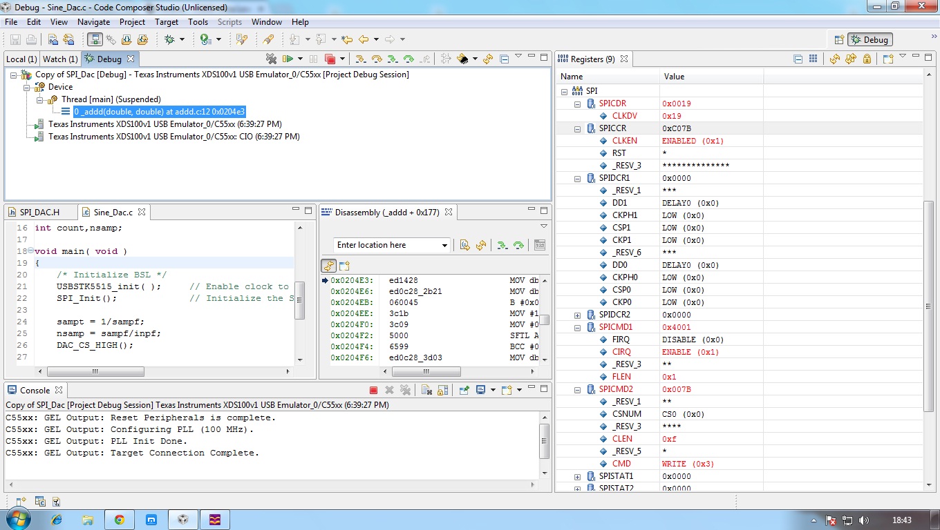

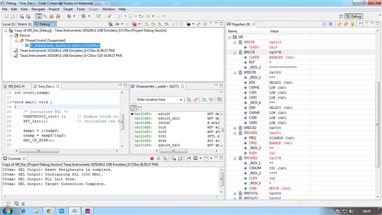

       All the register i configuring perfectly for C5505 SPI0 , using the pins which i said in previous post. i uploaded the code and screenshot of ccs. please check and tell., continuously am writing some values in SPIDAT register and checking in the SPI lines not getting any pulses.... i Think my SPI i not enabled.. please check this and solve this ,.
    void main( void )
    /* Initialize BSL */
    USBSTK5515_init( ); // Enable clock to all peripherals
    SPI_Init(); // Initialize the SPI0
    sampt = 1/sampf;
    nsamp = sampf/inpf;
    DAC_CS_HIGH();
    while(1)
    for(count=0;count<nsamp;count++)
    teta = (2 * PI * inpf * sampt * count);
    value = sin(teta)*2048;
    Sent_to_SPI(value);
    void Sent_to_SPI(unsigned int Value)
    Value = (Value & 0x0FFF);
    SPI_Write(Value);
    void SPI_Init()
    volatile Int16 looper;
    SYS_EXBUSSEL = 0x5000; // Enable GPIO18,19,20,27 mode - 2 bus , for SPI mode 3
    SYS_PRCNTR = 0xFFFF; // Periperla s/w RST counter Register PSRCR
    SYS_PRCNTRLR = 0x00FF; // Peripheral Reset Control Register PRCR
    SPICDR = 0x0000;
    SPICCR = 0x0000;
    SPIDCR1 = 0x0000;
    SPIDCR2 = 0x0000;
    SPICMD1 = 0x0000;
    SPICMD2 = 0x0000;
    SPISTAT1 = 0x0000;
    SPISTAT2 = 0x0000;
    SPIDAT1 = 0x0000;
    SPIDAT2 = 0x0000;
    for(looper = 0; looper < 100; looper++) {;}
    SPICCR = (1<<15)|(0<<14); // Enable the SPI_CLK, RST release
    delay_ms(10);
    SPICDR = 0x0019; // SPI_CLK = (SPI_IP FREQ/(CLKDIV+1))
    SPICMD2 = (0<<12)|(15<<3)|(3<<0); // select CS0, CLEN = 15 - word length, write cmd
    SPICMD1 = (1<<14)|(1<<0); // frame length - 2 ,FLEN+1, no interrupts
    SPIDCR1 = (0<<3)|(0<<2)|(0<<1)|(0<<0);
    /* SPI 16 bit Data to Dac */
    void SPI_Write(unsigned int Data)
    Data = ( 0x3000 | Data );
    // Wait for transmit ready - check busy bit
    while((SPISTAT1 & 0x0001)==1);
    SPIDAT1 = Data;
    // Wait for Character transfer complete
    //while((SPISTAT1 & 0x0002)==0);
  • Have you been able to run the examples in CSL?
      Can you ensure the below initialization steps is taken care.
    •  Ensure the SPI is out reset by setting SPI_RST=0 in the peripheral reset control register (PRCR).
    •  Enable the SPI input clock by setting SPICG to 0 in the peripheral clock gating configuration register (PCGCR1).   (By default clk should be enabled but cross check... again)
    •  Set CLKEN = 0 to disable SPI_CLK. The CLKEN bit is part of SPICCR .
    •  Set CLKDV in SPICDR to provide the appropriate SPI_CLK frequency. Note that for proper device operation, CLKDV must be greater than or equal to 3 .
    •  Set CLKEN = 1 to enable SPI_CLK.
    Your code depicts that you tried by setting EBSR parallel mode to both 3 and 5 (2nd post of your code). This should be ok.
    Also as suggest in the earlier post you could refer to SPI CSL example for initialization sequence / Run those examples. This would help ease your debug.
