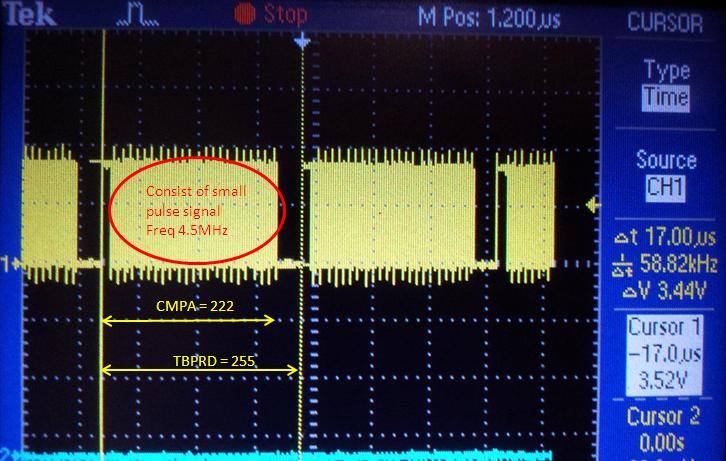

i just bought TI LCDK C6748 dev kit and just beginning to develop using TI DSP IC..
i load it with Starterware example project of EHRPWM..
i successfully build the project and make some modification with the Action qualifier register as below :
EHRPWMConfigureAQActionOnA(SOC_EHRPWM_1_REGS, EHRPWM_AQCTLA_ZRO_EPWMXAHIGH, EHRPWM_AQCTLA_PRD_DONOTHING,
EHRPWM_AQCTLA_CAU_EPWMXALOW, EHRPWM_AQCTLA_CAD_DONOTHING, EHRPWM_AQCTLA_CBU_DONOTHING,
EHRPWM_AQCTLA_CBD_DONOTHING, EHRPWM_AQSFRC_ACTSFA_DONOTHING);
it is successfully load and generate the PWM signal at EPWM1A pin..
i expect the resulted signal will be 1 full square wave in every period of PWM..
but the resulted signal is consisted of many square wave within 1 period of PWM signal as below picture..
is it normal that 1 period of PWM signal consisted as many square wave signal?
how can i make 1 full square wave signal every period of PWM?
