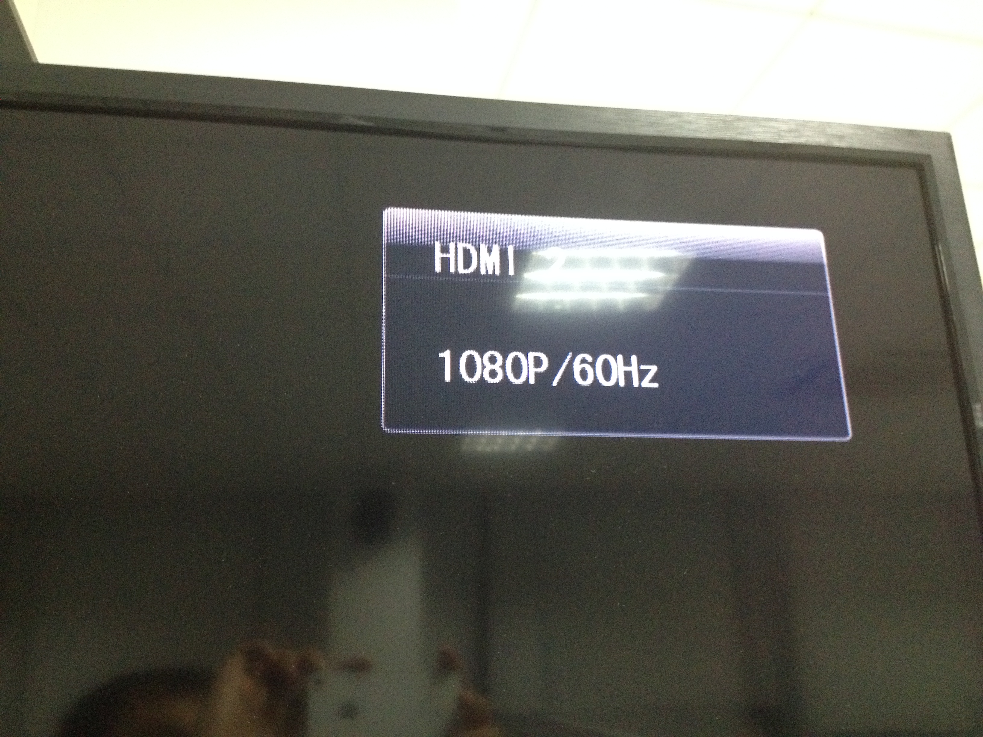

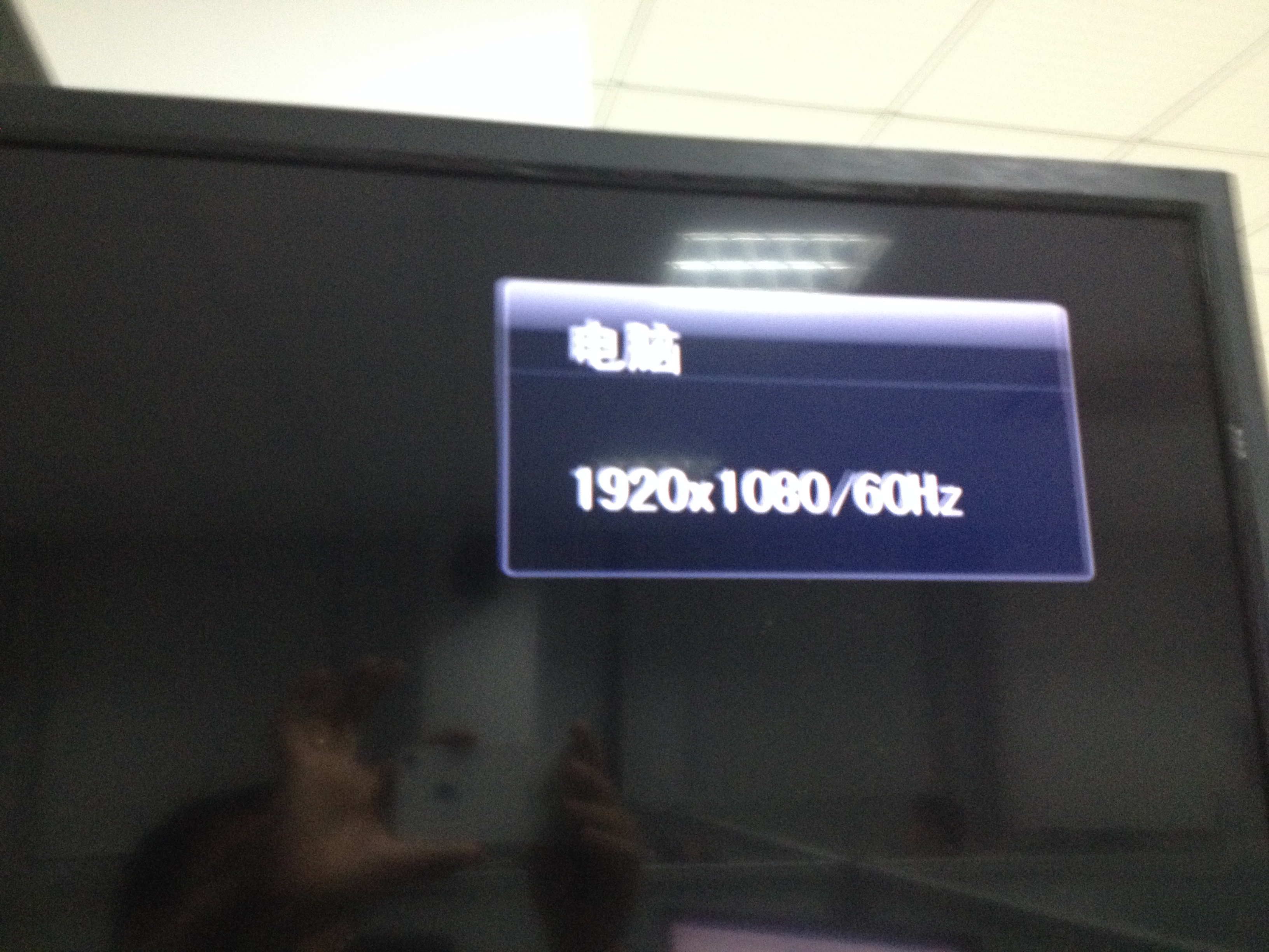

About display with VGA(tied with DVO2)
Hi,everyone!
I use dvrrdk3.0,and board is custom baord.
with its, i wanna display with VGA(tied with dvo2).
my code is the following,its result unnormal
    Both VGA and HDMI output has video sigal, however, vga and hdmi have no video data to display on the monitor.
Note
1. the output log is as follows
2.the following pictures are the result of my code.
Questions:
1.Is there something wrong with my code?
2.My Final Goal: display two different video output, one is HDMI, the othe is HDCOMP(VGA),so how to configure HDCOMP(tied with DVO2)?
Appreciate for any reply!

----------------------The actual results:
-------------The output log:
root@dm816x:~/lywDir# ./disTest
