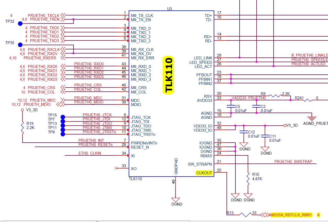

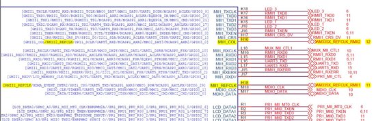

Our custom AM355x board is close to the AM335x ICE V2 board. I'm now implementing Ethernet on our board. By chance I have seen this E2E thread: http://e2e.ti.com/support/interface/industrial_interface/f/142/t/206970.aspx
And also found the following threads concerning TLK110/RMII Clock connection:
http://e2e.ti.com/support/arm/sitara_arm/f/791/t/214462.aspx?pi301021=1
http://e2e.ti.com/support/arm/sitara_arm/f/791/t/243640.aspx
As we also use the TLK110 I'm asking the question why is TI using the TLK110 CLKOUT for RMIIx_REFCLK on AM335x on the AM335x ICE V2 board although TI knows that this is a bad thing to do?
It would be very helpful if EVM designs are bullet proof as they are often used as standard.
Did TI do any Ethernet tests on the AM335x ICE V2 board with RMII interface?
I finally managed to implement Ethernet communication on our board and I'm able to ping @100Mbit Full Duplex but I'm feeling pretty insecure having also used TLK110 CLKOUT as AM335x RMII Ref Clock.
