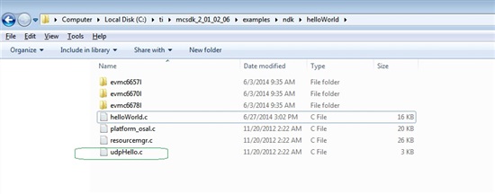

    I have tested the UDP sends the data from board to PC. You can use the helloworld example from MCSDK. Here you need to replace the udpHello.c and helloWorld.cfg files.
    C:\ti\mcsdk_2_01_02_06\examples\ndk\helloWorld
    In addition that, comment out the "dtask_udp_hello" task in helloWorld.c file like below,

  • Hi Pubesh,
    Thanks for responding. Okay, when u said replace udphello.c, u meant replacing the original helloworld.c with the one u provided right? But why do I not see a main function in ur code? Also is the function stack test() not needed?
    PS: I'm working in a non-internet environment so I'm unable to just copy and paste to try it out. I'll have to type n try, but I don't understand why I don't see a main function.
  • Jing,
    Replace the original udphello.c file with attached the udphello.c file , not helloworld.c file.
  • Jing,
    Before build the project,
    // Create our local server
    /* hHello = DaemonNew( SOCK_DGRAM, 0, 7, dtask_udp_hello,
    OS_TASKPRINORM, OS_TASKSTKNORM, 0, 1 ); */
