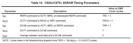

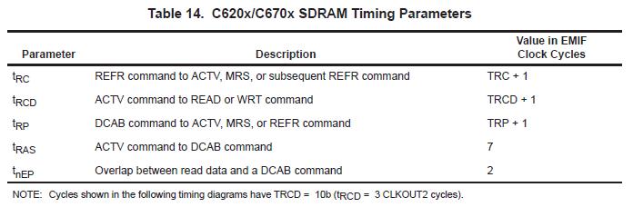

  • The following table lists the programmable and fixed parameters available for the C620x family of DSPs. Newer DSPs have more parameters that can be configured.
