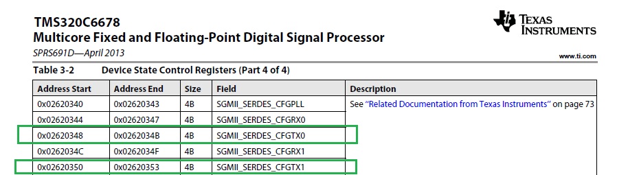

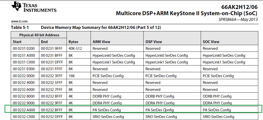

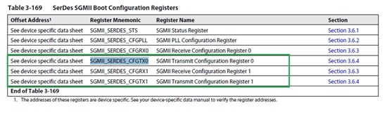

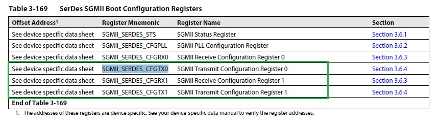

Greetings,
Section 3.6 of the KeyStone Architecture Gigabit Ethernet (GbE) Switch Subsystem User Guide talks about the SGMII Transmit Configuration Register. I have searched through the code and documentation but I cannot find the correct address or address offset for this register for the K2H architecture. I would like to set the INVPAIR Invert polarity bit in this register. Can someone help me find this address?
