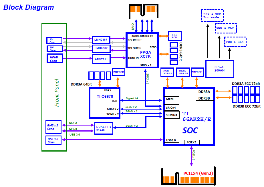

    4. As for i know, Quad Shannan has only PCIe interface for external communication. Could you please share the image/connection diagram of your  setup?

    4. Below is part of block diagram of DSPC8683
    Thank you,
    Celesti
  • Hi Celesti,
    I am not able to view your setup block diagram. Please share your block diagram via attachment.
  • Hi Ganapathi,
    Please find the attachment.
    Celesti
  • Hi Celesti,
    Have you using MCSDK(2.0 and 3.0) example projects for your testing? For my understanding MCSDK(2.0 and 3.0) example projects are not directly support on DSPC-8683 board.
